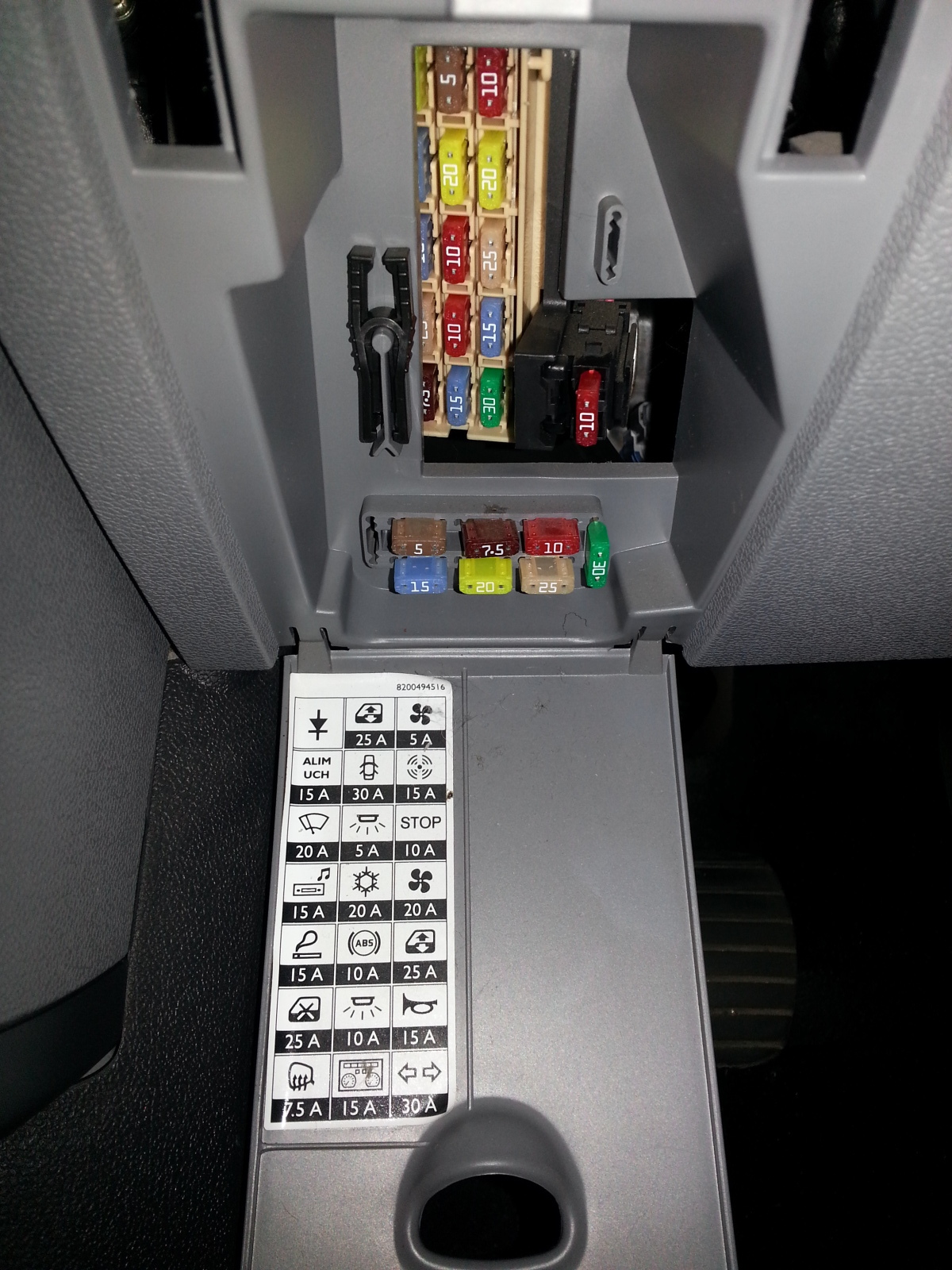

I started this afternoon by opening my fusebox, a simple job I thought to replace the fuse, but I was faced with this sight...
The fuses are out of line with the door itself? Im assuming the circle shaped one top right and next one down, the 15A one, is the cigarette lighter? This is massively hidden so I don't know how to get to that, any help i'd love!

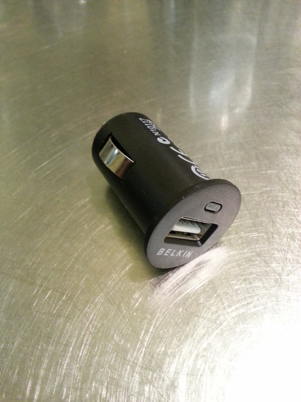

My Belkin purchase, that managed to blow the fuse and never worked! This also sticks out of the lighter socket by roughly a centimeter.

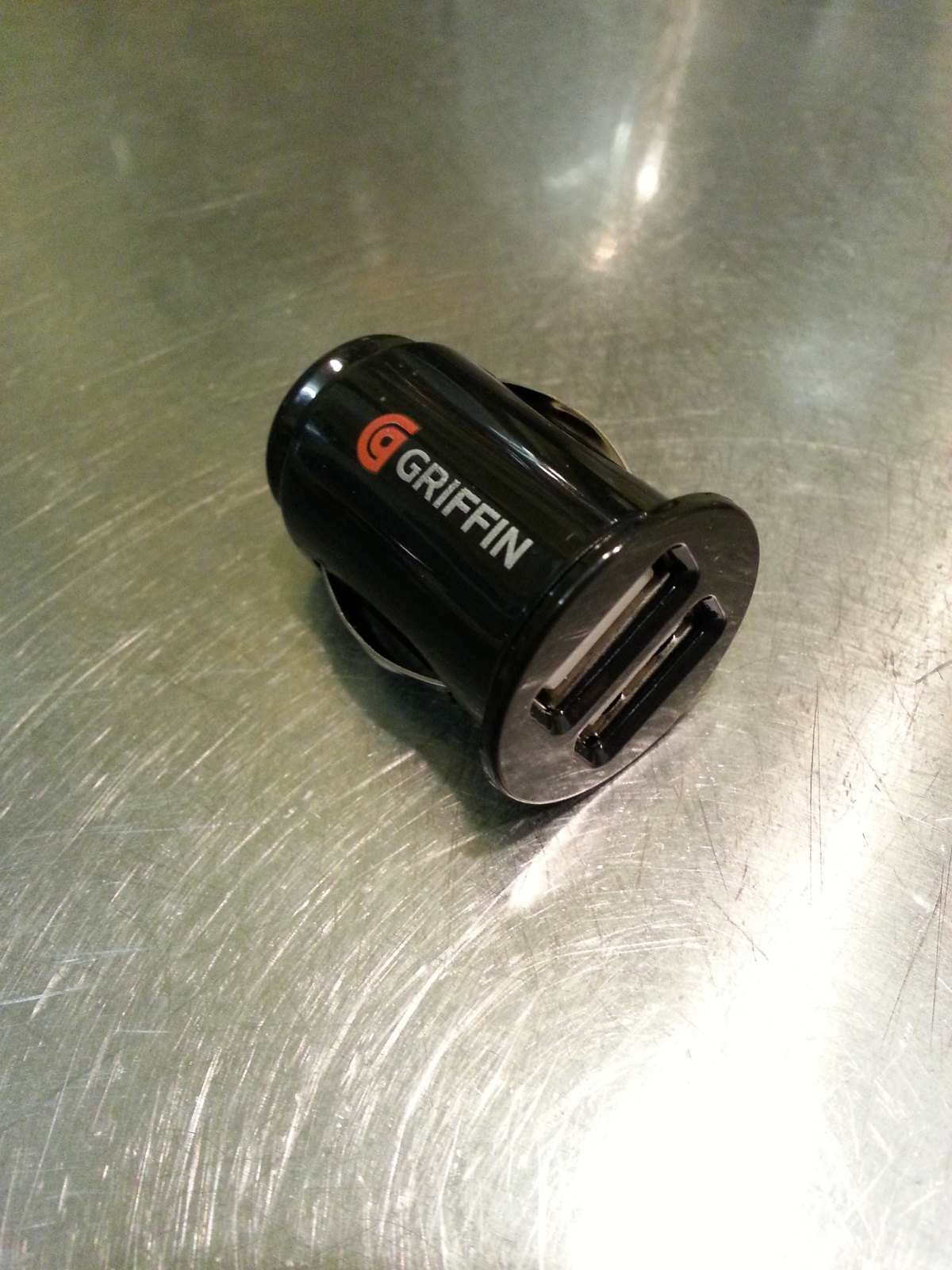

The Griffin replacement I ordered that fits reasonably flush, sticks out a couple of mm but that's good enough for me. Sorry if all the pictures are rotated weirdly, not sure how that happened?

Okay so looking at that picture I feel... intelligent? ;) Just noticed the cigarette picture so that was an obvious one. Anyone guess what color my hair is? Haha.
  1.6 Astra Sporthatch

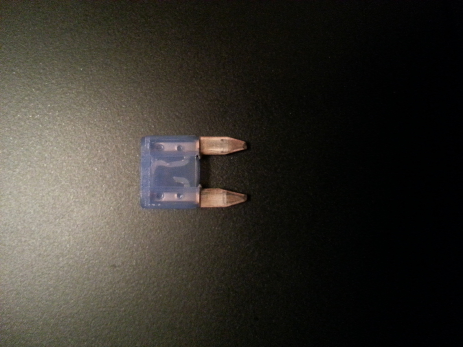

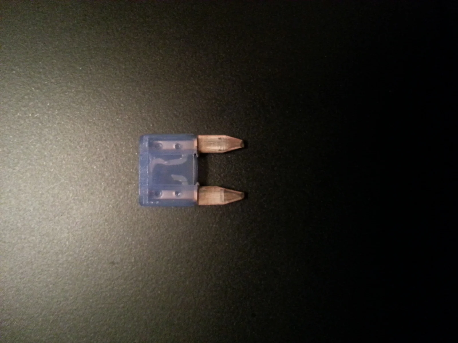

With my new knowledge of which fuse it was, and even though I still had to bend the fuse box quite alot to change the fuse, I have changed the fuse! Old one was blown as expected.

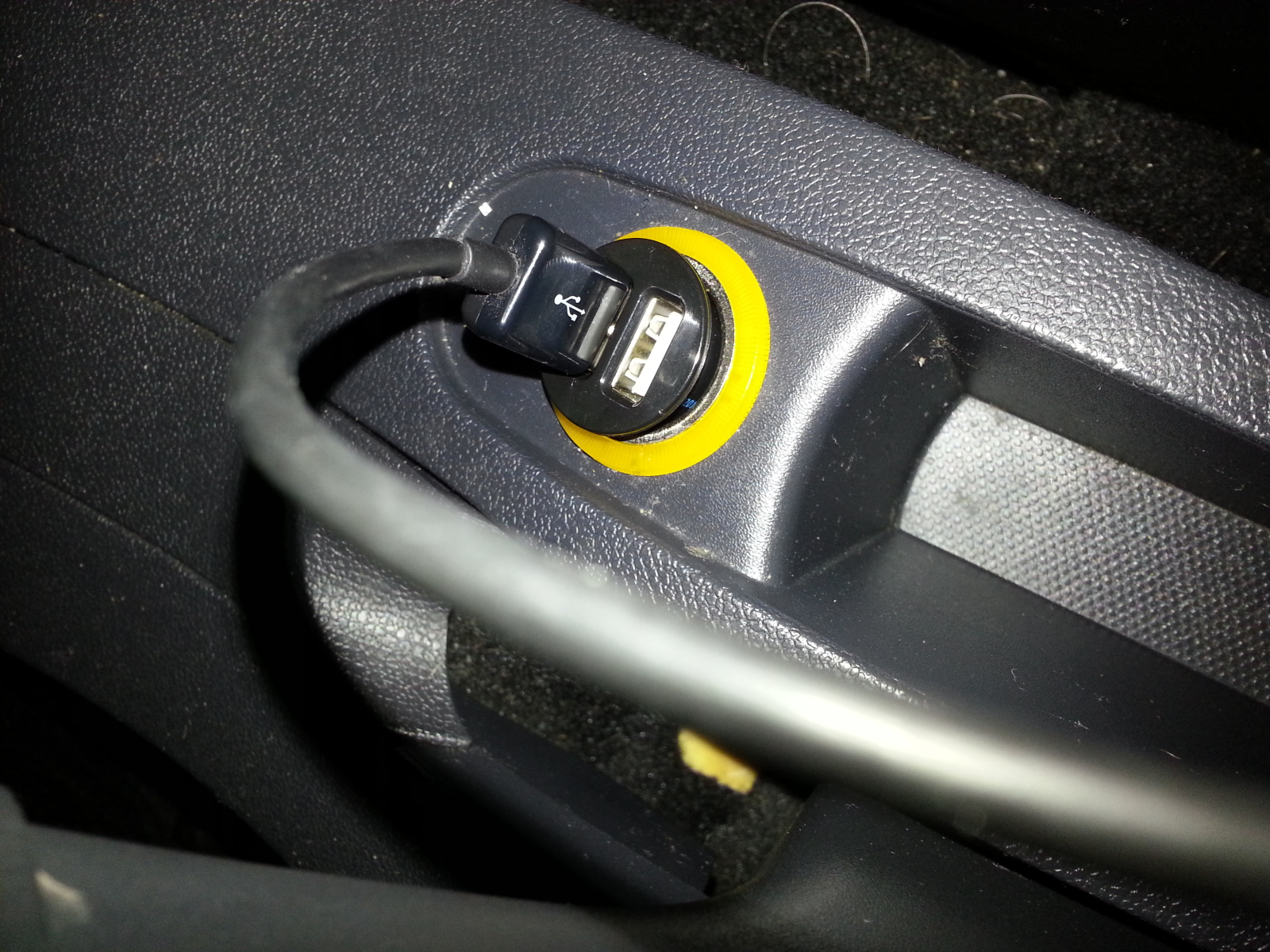

All works now with my new Griffin adapter, not even going to risk trying the Belkin one again!
Sticks out just slightly but looks alot better than the Belkin one that stuck right out. Very happy with it, and would recommend it to anyone, now time to buy another fuse for a spare.
