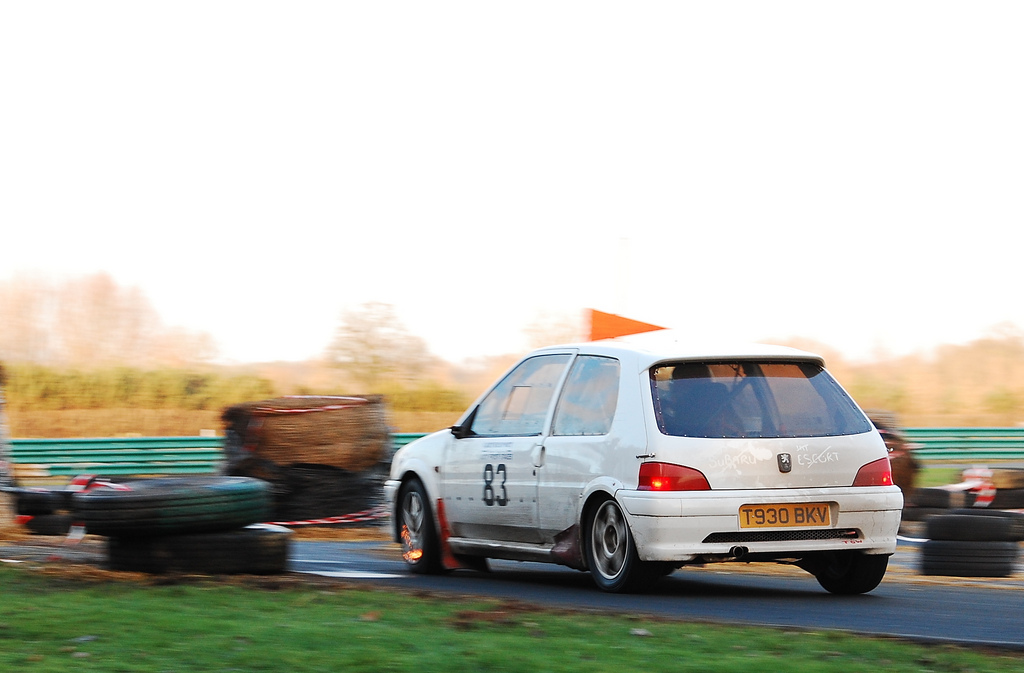

As Nick pointed out in my other thread, I seem to be having some contrast issues.
For instance, in this Peugeot shot, the sky has completely gone and it looks a little poo. What should/could I do/change to stop this from happening? Help!
1. Shoot in RAW and bring the sky back in via post processing.
2. Meter from the grass, and see how your cameras exposure latitude deals with the scene. (very similar to grey card exposure)
Sorry to be an uber-noob, but how would I go about 'metering from the grass'?
stick your camera in manual decide what iso/shutter you want ( shutter being your dominant decider as you are shooting motorsport) and point the camera at the grass.
shift the aperture until you get a correct exposure on your metering scale, now point your camera at the area you wish to shoot - ignoring the metering scale.
This is called a substitute light reading, but the reason you use the grass is that to the camera grass is a mid tone and depending on your cameras exposure latitude this gives the best chance of getting shadow and highlight detail.
one more trick you could try is an SLR reading, SLR standing for Subject Luminance Range.
To get the SLR for any given subject, you spot meter from the brightest part of your scene, and spot meter from the darkest part - note the two extremes in exposure and pick a happy medium and go for that, thus depending on your cameras exposure latitude again. Problems come when the SLR is out of your cameras latitude, so if the difference from dark to highlight is 8 stops ( which is possible on a bright winters day with a mid day sun) your camera can struggle, thus why most people will shoot precious jobs in RAW.
Shooting in RAW you can use a technique known as "expose right". i.e over exposing on the shoot and bringing the highlights back in with your RAW software.

With regards to the above shot. I would say in this example it looks like your shooting into the sun. The sun does look high in the sky, but in an ideal world you would have shot from the other side. Albeit being a rally i appreciate this depends on a lot of other factors.

For what it's worth I do what planetx suggests with the spot metering a certain area of the scene that you know roughly how bright it should be. Sometimes the dynamic range is just too great though and it's up to you to decide what you need to expose correctly and what you can afford to lose. Often it's better to underexpose an area to stop another area from blowing the highlights, but it's a judgement call at the end of the day.
Also, if you have a split RGB histogram then keep an eye on that too.
Edit: Shooting into the sun like that, you're going to struggle tbh, the dynamic range is too great. The car looks exposed correctly, so it looks like you did the right thing. Try adding a grad filter to the sky in Lightroom or whatever if you want, but I wouldn't worry too much. I think Nick was referring more to editing style perhaps.

For the record, I was shooting away from the sun ;)

I suppose with it being a white car it's much closer to the top end of the scale when exposed correctly than a darker car, so anything that's even slightly brighter than it won't have much room left on the scale to fit, so there's more chance of it being blown out.
your camera just hasn't go the latitude to deal with the whole scene thats all.
Can't really tell too much, but are you shooting the cars in a slightly shaded spot on the track? the background does look a stop or two over exposed?
Perhaps shooting the cars in a brighter area will bring the whole dynamic range together and give you a more even exposure.
