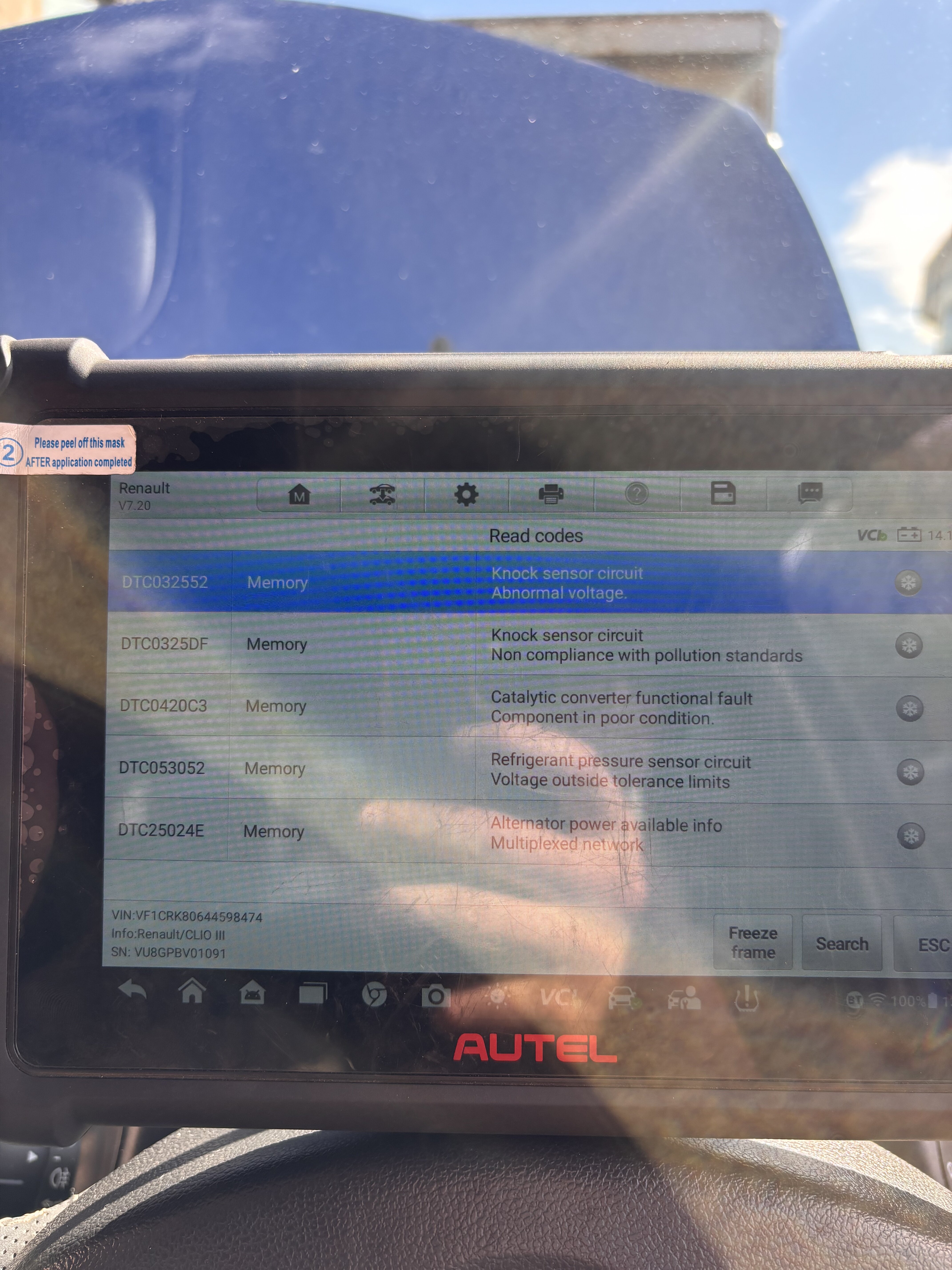

Battery light comes on and turns back off after 5-10 seconds, got the codes and what not,
Traction control light comes on occasionally on startup and stays on for a while,
Airbag light was on consistently until last night when i drove around with friends in the car,
Scanned the car and these codes showed up (picture listed), only active one is the knock sensor
All sounds like electrical to me but i’m not no expert and I was wondering if there are some electrical weak points on these clios that I should look out for.

Autel shows the alternator appears to be working, worth checking it on a multimeter to see if it's erratic.

With most of the codes being related to abnormal voltage, i'd start with the alternator and battery.
Do you know how old those codes are by checking the freeze frame data? They could be old.
All codes apart from knock sensor were on startup (started at 192 rpm), but i’m not sure what to make of that.
Flagging loads of codes on start will be due to low voltage. Check all your power and earths are good/tight.

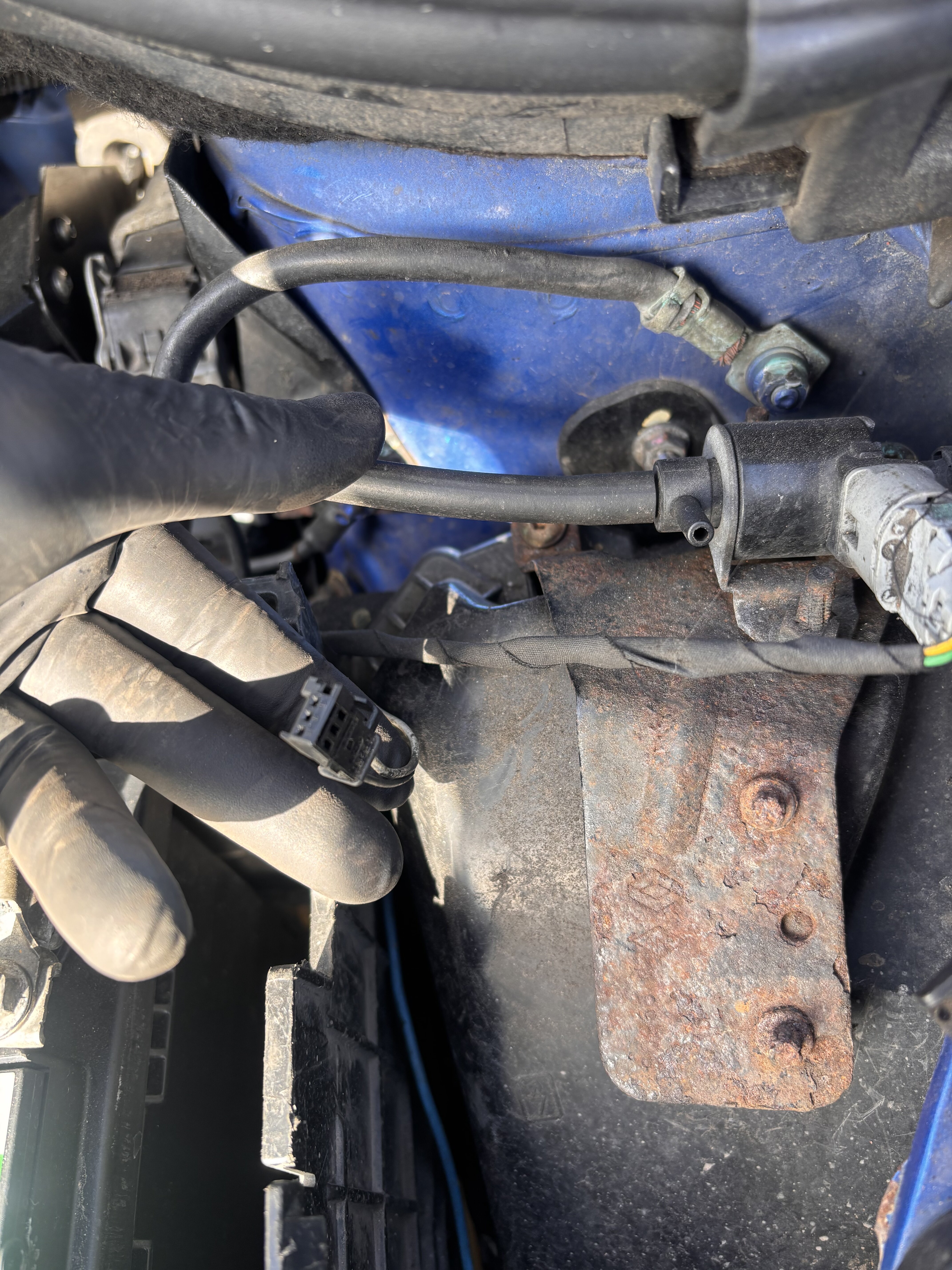

There’s this one odd plug that is unplugged near the fuse box which i don’t know where it goes.
I’ll attach a picture
