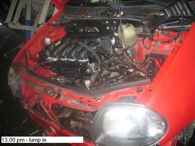

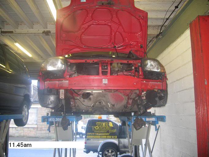

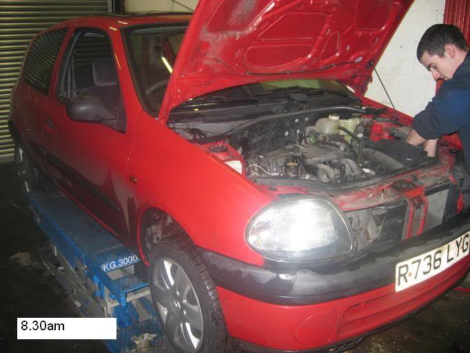

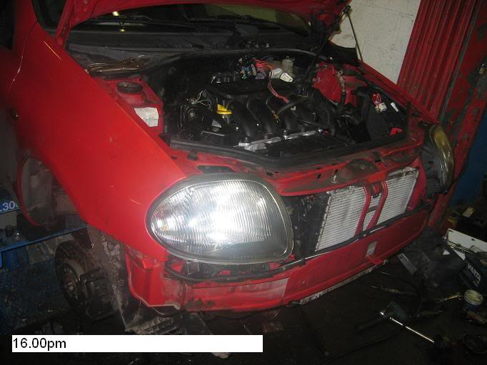

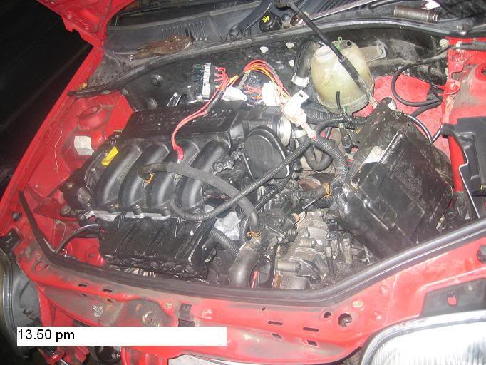

Done the conversion many times - ignore these boring f*****s
Your gonna need the engine / ECU / loom / plip key / UCH control unit / driveshafts / gearbox / brakes / calipers / shockers and springs / hubs and discs. Make sure the parts you obtain from the donor car comes with a chassis number for when you go turn key and need to program and recode the immobiliser / ECU. Takes about 10 hrs to do the job from start to finish
