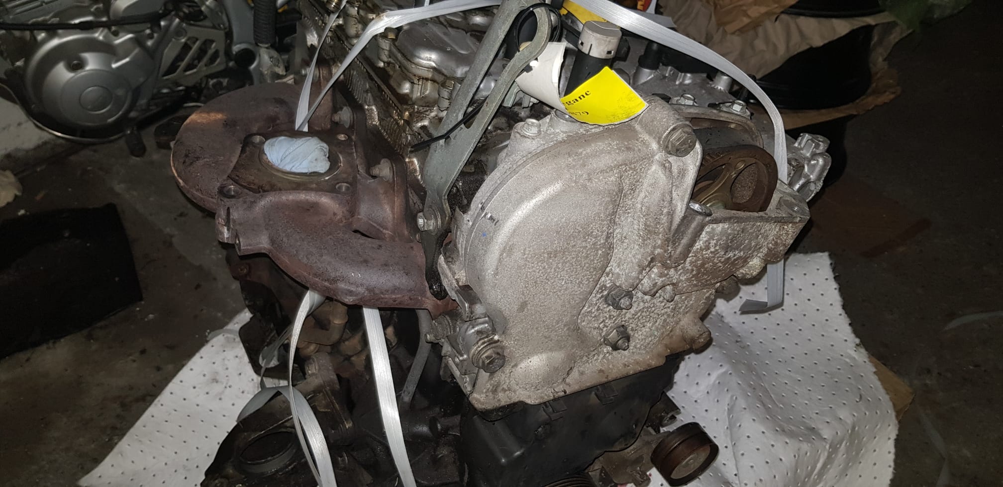

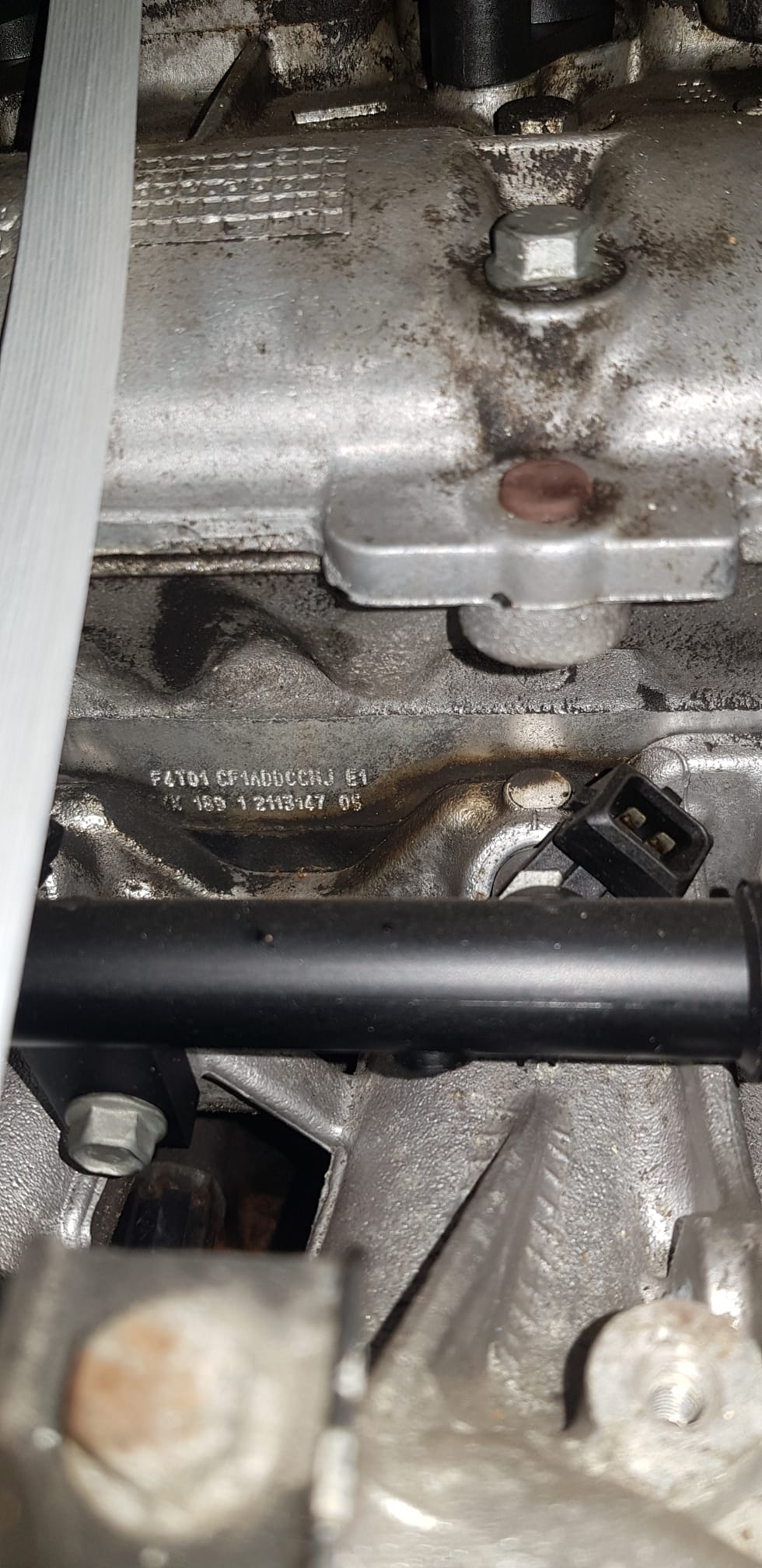

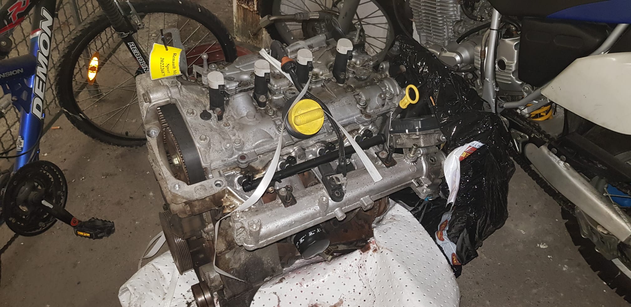

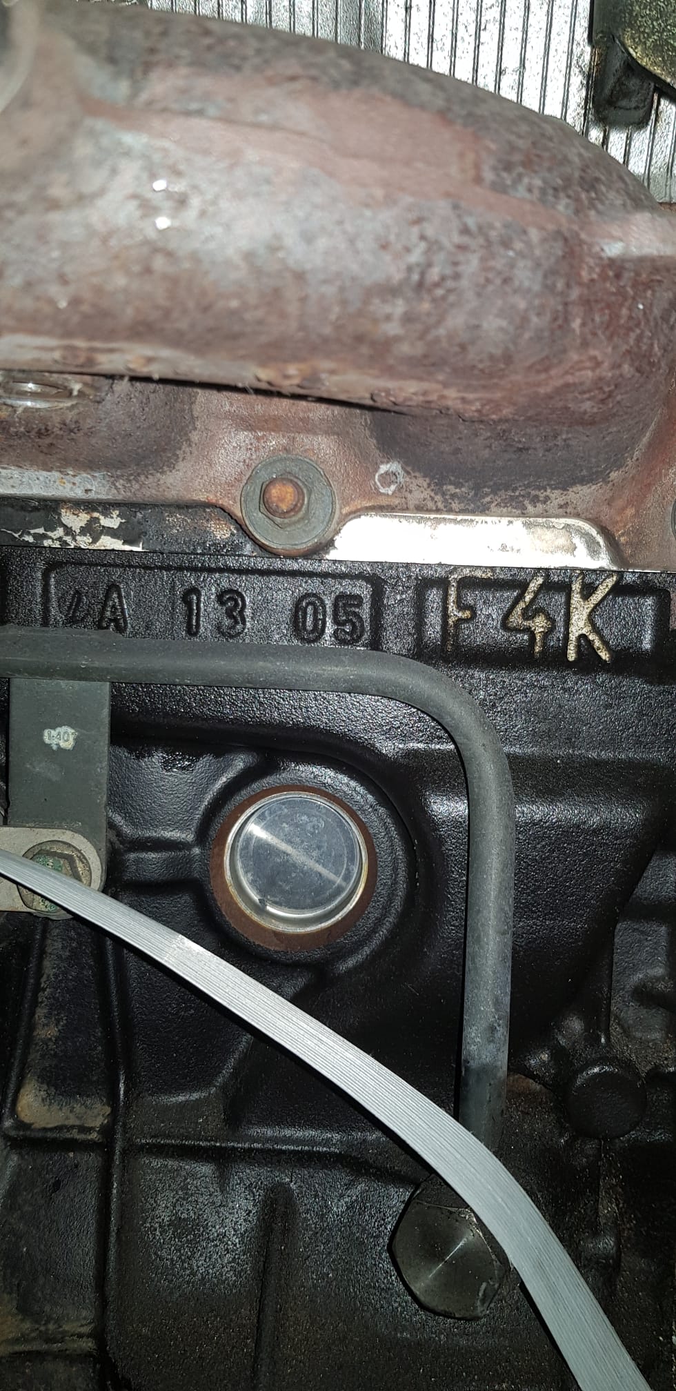

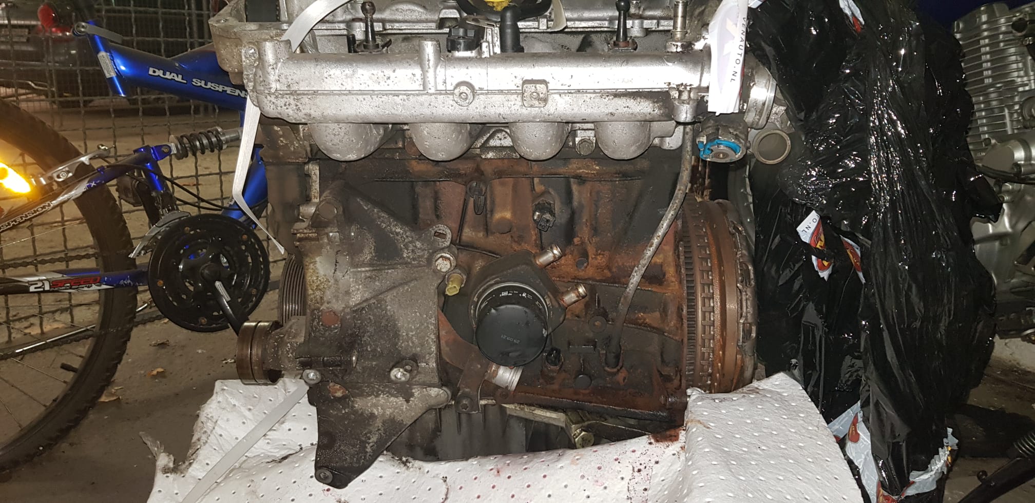

Things are starting to get real, I found this engine and the seller claims it's an "F4R 774," but I can't quite figure out if that's really the case, since the block is labeled "F4K."
Hope someone here can help, maybe I missed the plate with the engine model.
