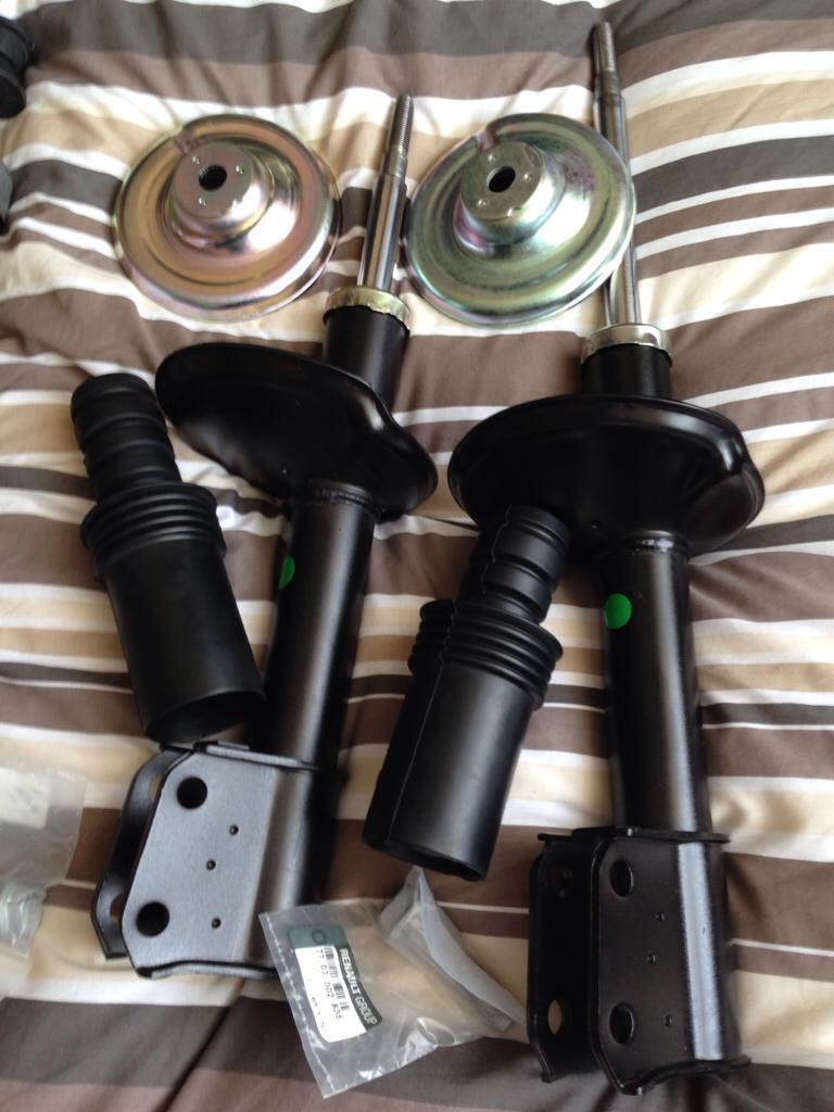

  PH2 Flamer
Anything missing from this picture? Except springs lol.
All I have is damper, cap, and what looked like a dust cover/bump stop in one?
That's all I have fitted with my cooksports, and mine haven't failed. Been about 9 months.
Worried I have something missing now!
Coops Mk1
  Lots of Scrap...
as in the pic, the bump stop and dust cover are one part and simply slip over the shaft of the shocker...........similar to how you learnt it in GCSE sex ed ;)
  PH2 Flamer
Good news.
Just all the slipping over and fitting inside in the post above mine made me think, I didn't do any slipping inside.
  Clio 182 Cup
Well in the case of the bump stops in the pic above then I do have them fitted.
Really was counting on them being missing as Im still no closer to finding out why I've been through 2 sets of front shocks now in 7 months.
