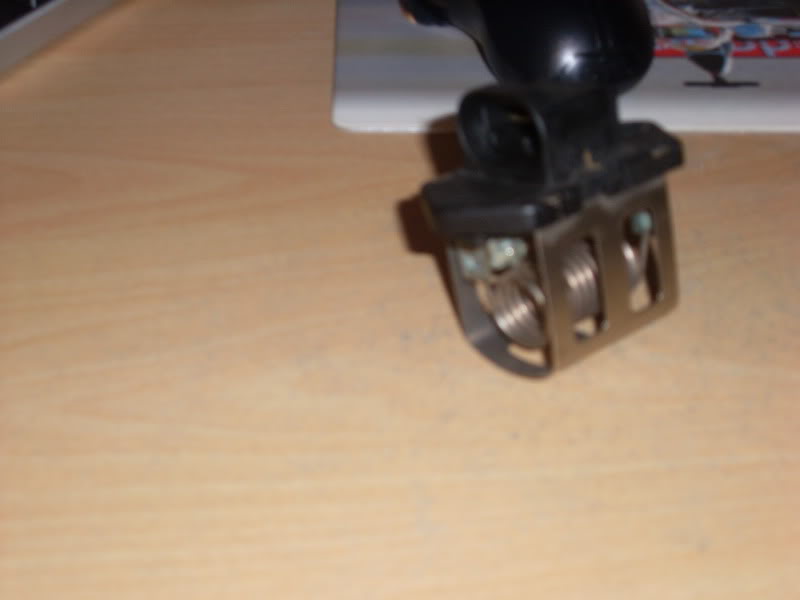

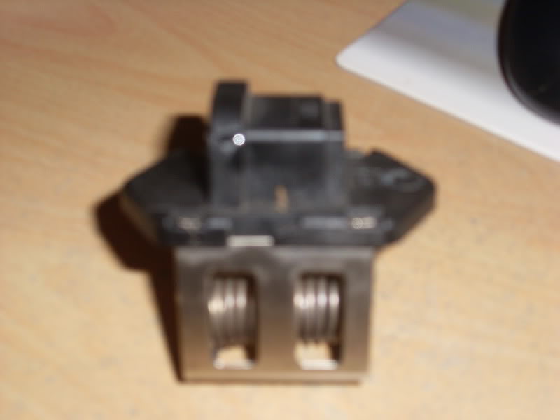

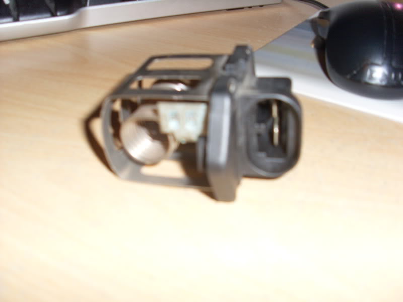

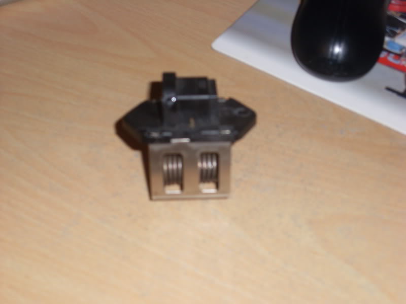

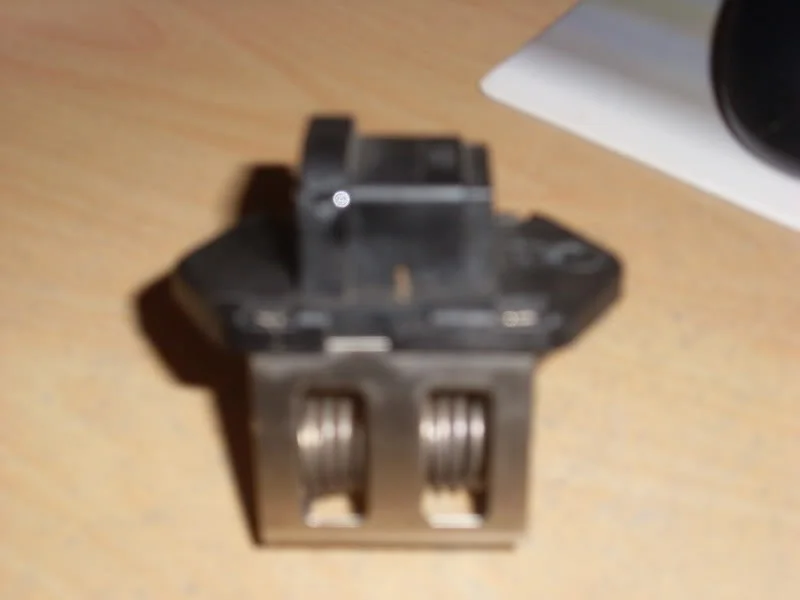

Anyone heard of one of these, mine has bust on the 172 and its causing the car to overheat on idle.
I've taken some picture of the part in question - does anyone have a part number/price at all? I'm gonna take a punt at it being a renault only part.
(Please excuse the poor quality of the pictures!)
Assuming the fan doesn't kick in at all? It should still run at full speed as the resistor is only in circuit when running the anti-perc function with the ac to run the fan at half speed. Unless its shorting to ground and blowing the fan fuse?
Yeah its a renault only job, part number is:
77 01 206 244 RESISTR COOL FAN 27.79
