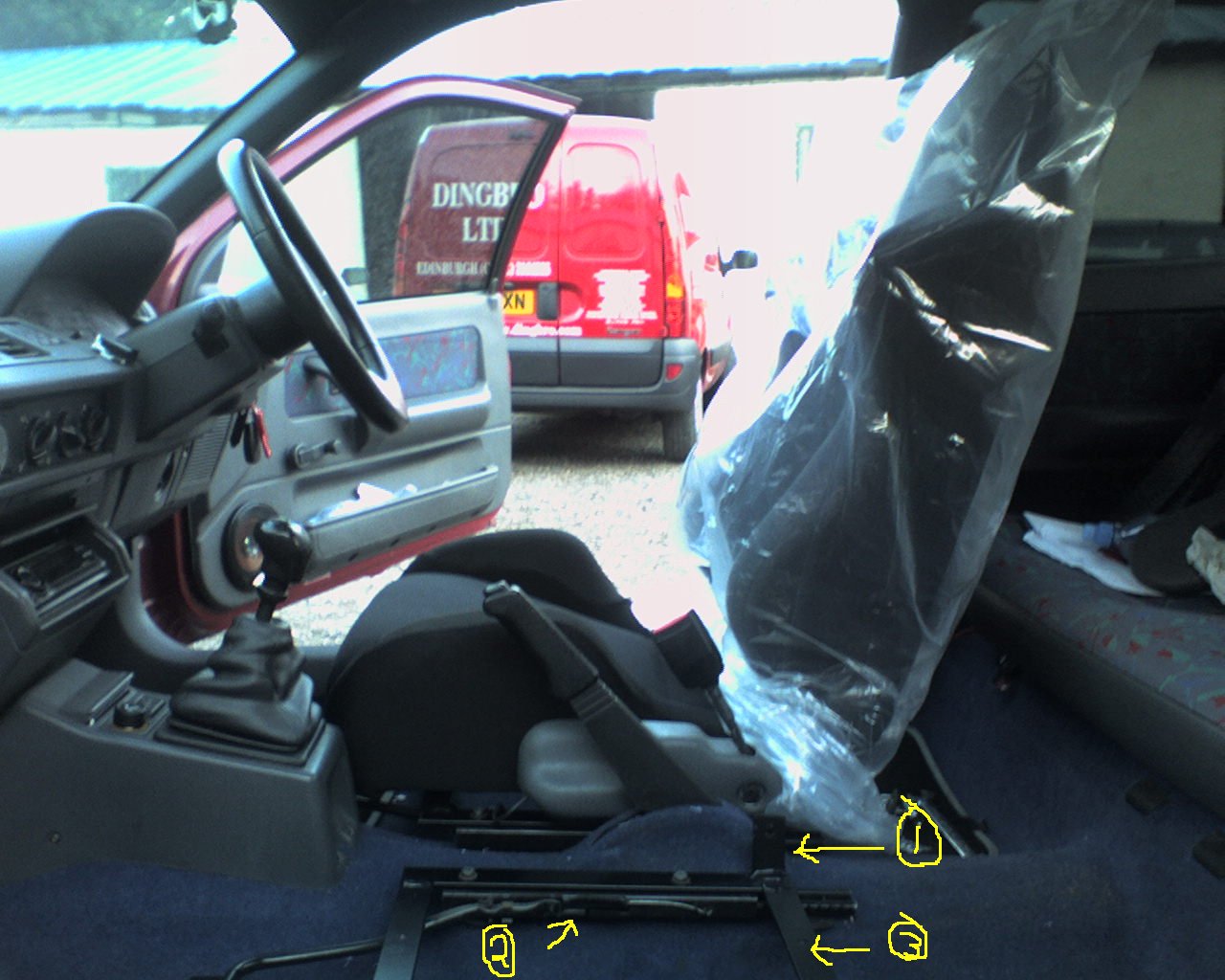

Want to fit some cobra seats, either monacos or daytonas but i dont want to fit harness'. i wanna use the orginal belts any ideas?
Can this be done?
Who sells the subframes?
cheers

The belt socket (correct term??) is attached to the subframe of the existing seats so am not aware of how you can have aftermarket seats and not have harnesses

the socket is attached to the old subframe but if you get a tailored frame from cobra, these have a bit for the socket to bolt on. i put 2daytonas in my mk1phase2 and used the standard belts. the frame cobra do for the mk1 are adaption frames and i had to take part of the seat out and bolt the new frame to old, its all pre drilled and really easy to to. i unbolted socket and pretensioner from old frame and bolted it to the new one. dont know about the subframes for the mk2 but they will prob have a bit to mount the socket thing on. i can get pics if u need.

in the pic:-
1 - bit to bolt old seat belt socket to
2 - old standard seat subframe complete with rusty bolts
3 - new cobra adaption frame that seats bolt directly to
the mk2 frames should have a bit for seatbelt id think. oh and youll be able to get frames from whoever you get the seats.
