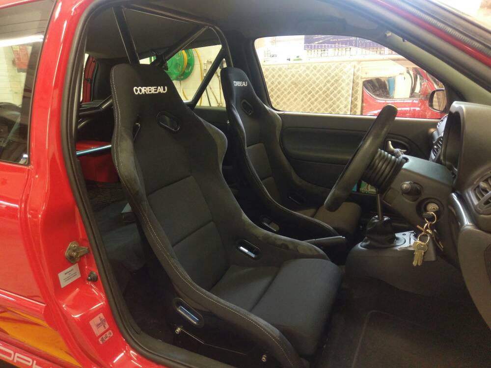

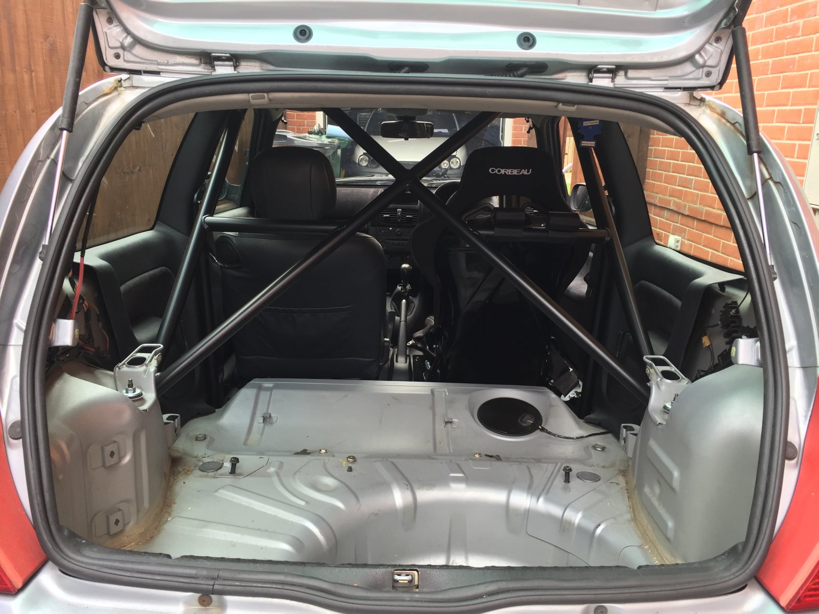

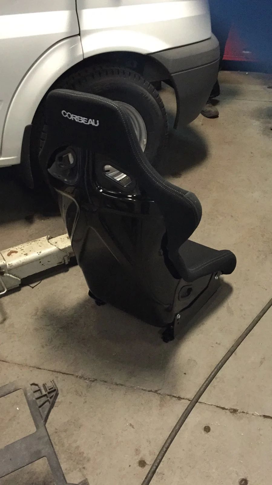

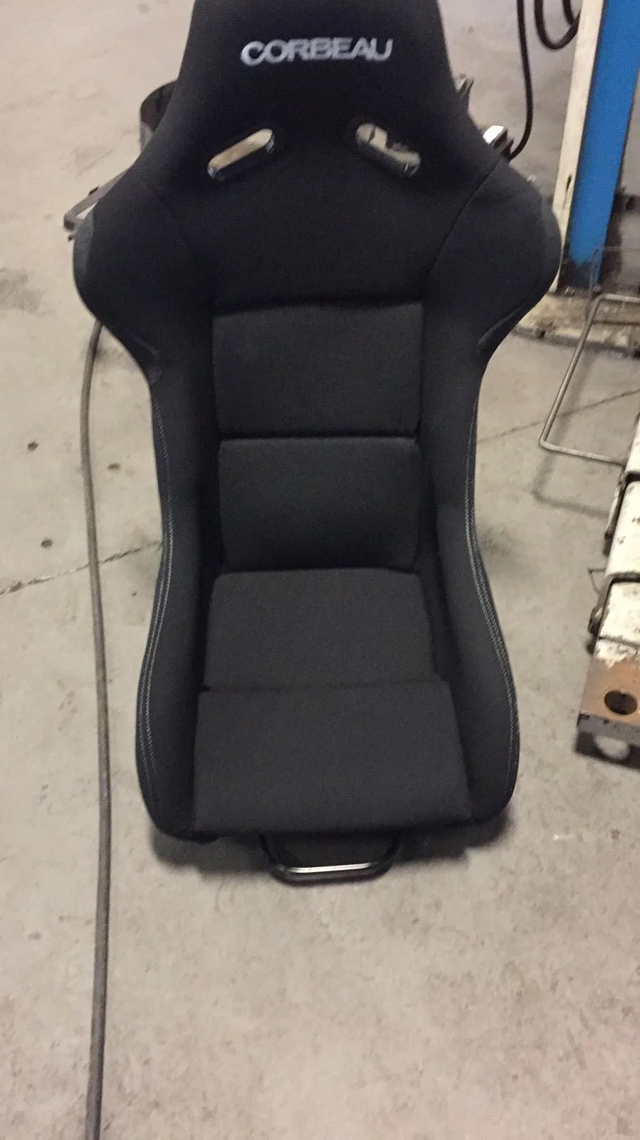

Hi all, just purchased 2x new corbeau club sport seats for my track car (still to fit them in) anyone any pics of them fitted in there clios ? Still can't believe how light they are! Especially compare to the recaros in my 197!!

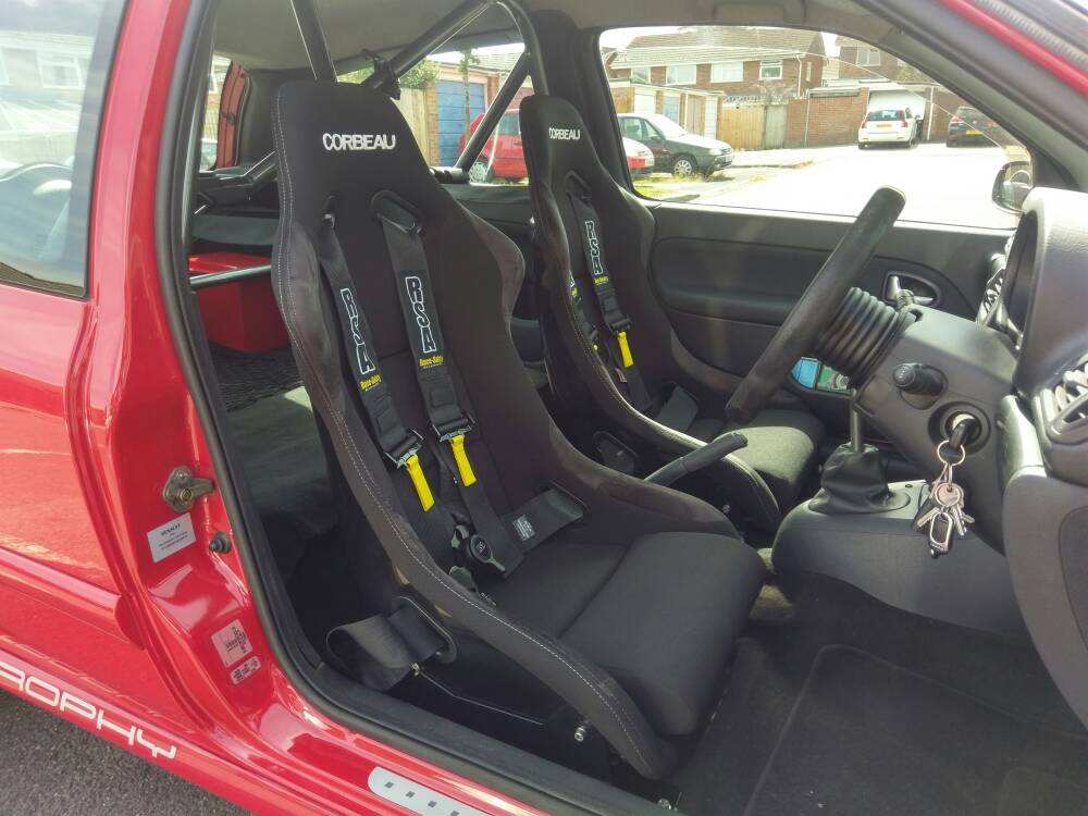

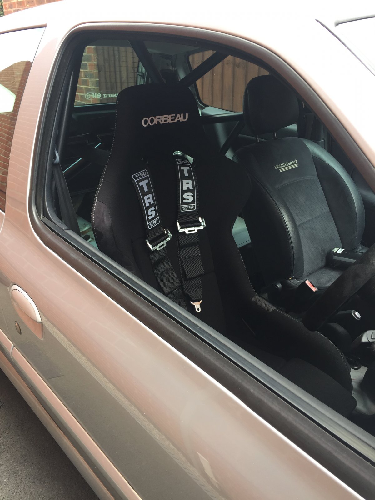

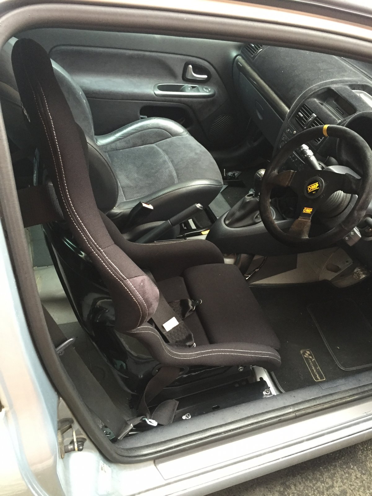

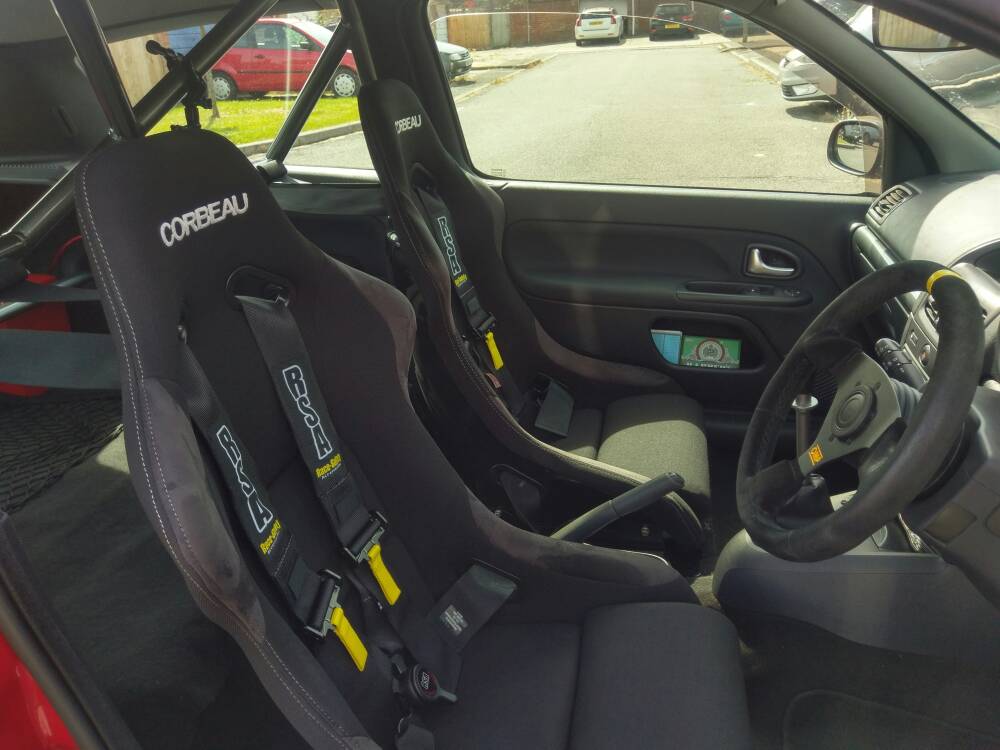

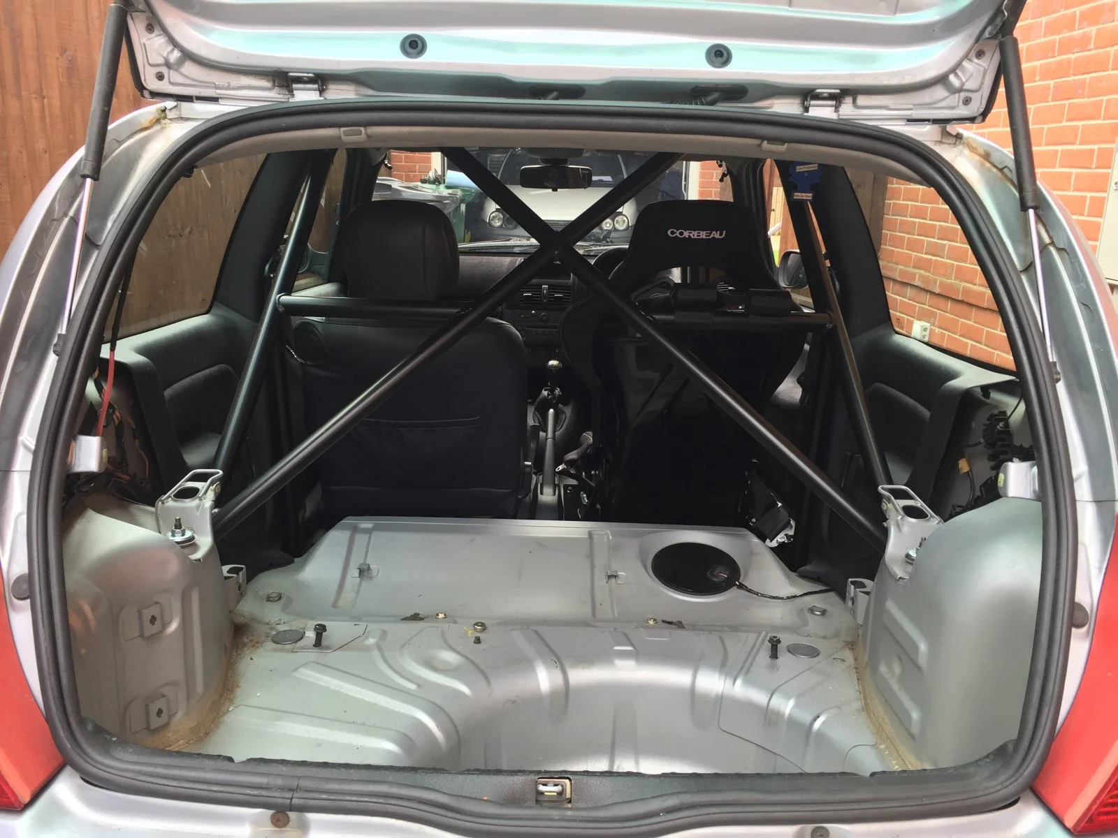

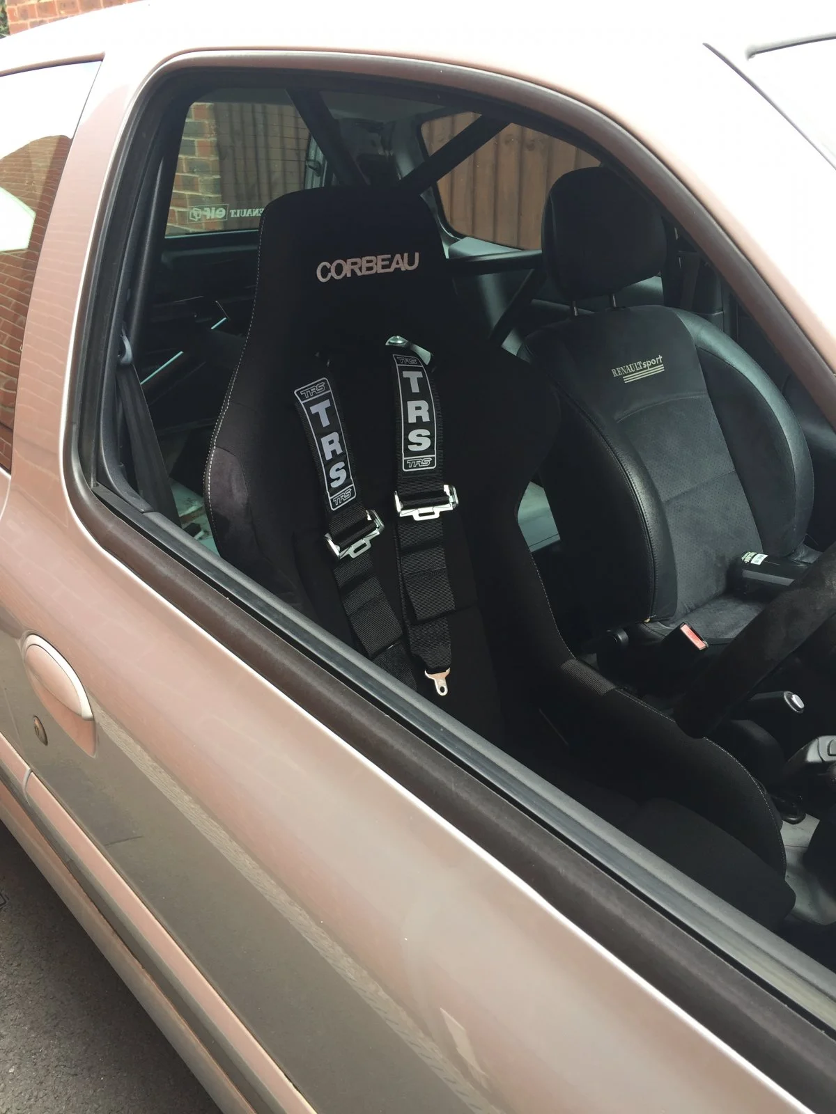

Love mine, get an xlow subframe and you'll love it even more

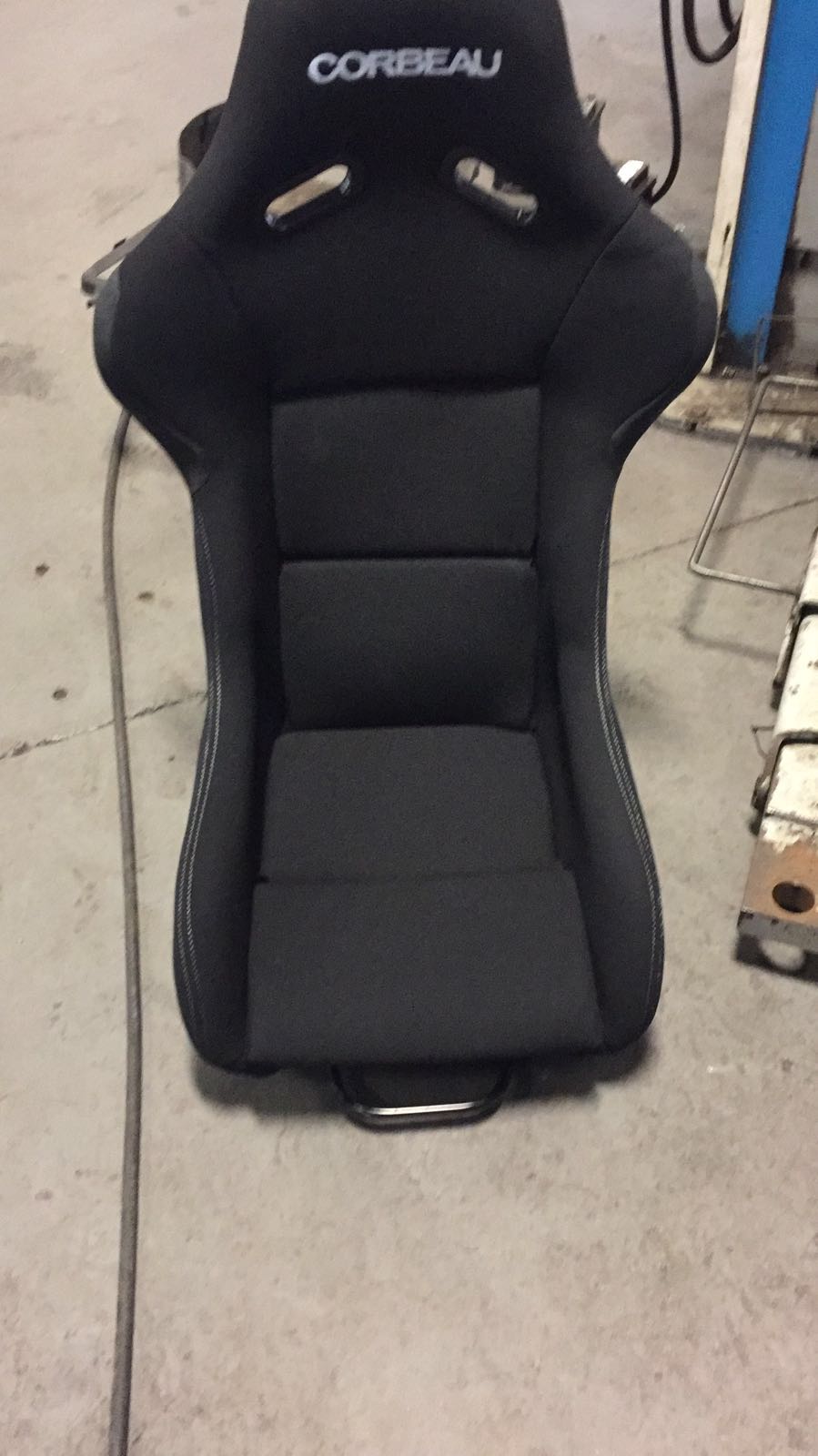

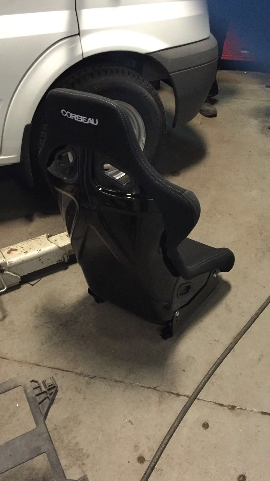

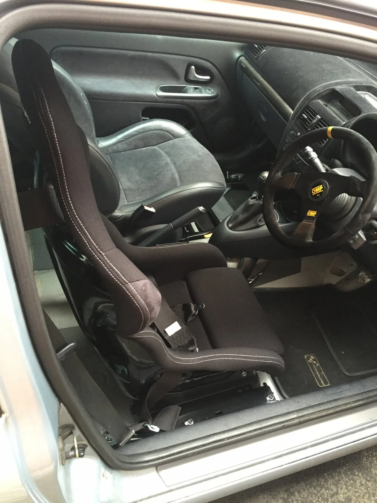

I'll be fitting a pair today on x-low frames into my 182, if the weather improves this afternoon.
I must say though, I was a little surprised how much flex there was in the upper section of the seat. Hoping once there all bolted up it'll be a little better.
I'm taking the runners off mine, to get an extra inch drop.

Thanks for the pics and info everyone. They are good seats for the money. I willove also be taking the runners off. Alot of good reviews about them online. Il putry pics up once they are fitted.
