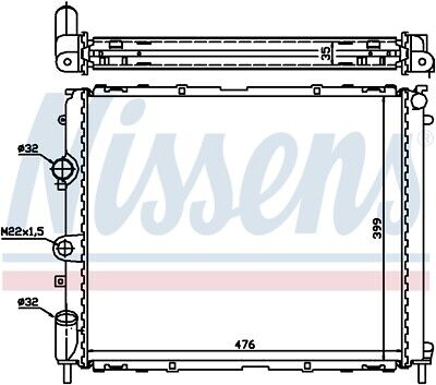

7700417175 is the correct part number for 172/182 with air con.
You could use Nissens 63855A or 63768 as an alternative.

Get the nissens one, changed mine last month, perfect fit and it comes with the blanking cap fitted unlike the Valeo one.

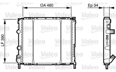

Chaps sorry to dig up an old thread. Just noticed this on ECP... I’m a bit off being at the point of fitting a new rad yet but one is needed. Is this the correct fitment for a FF 182. ECP says so, but I’m not so sure! Looks cheap! Plus discount code works too!
