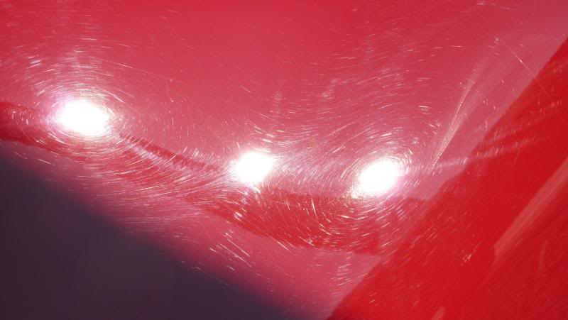

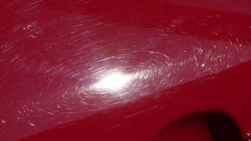

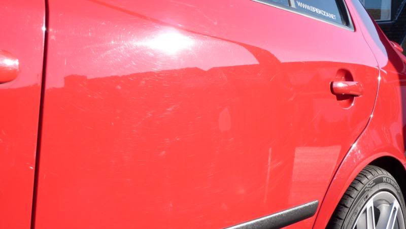

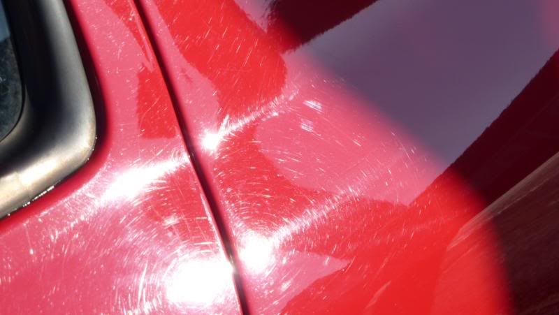

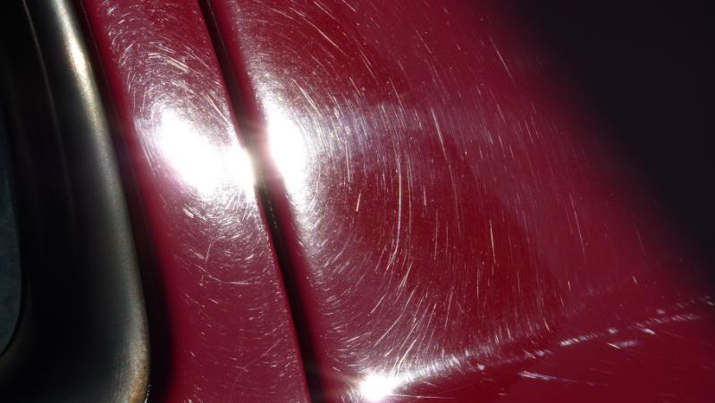

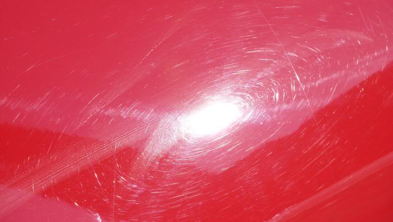

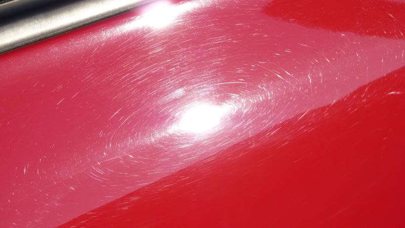

Now, I've seen some pretty swirly cars in the past year or two, but...
VEEEERY swirly! :doublesho

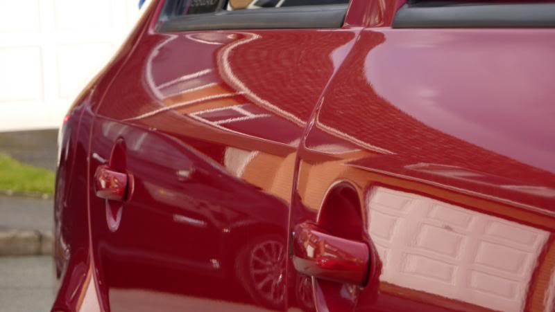

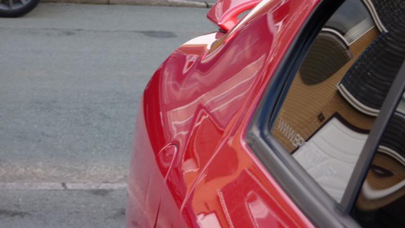

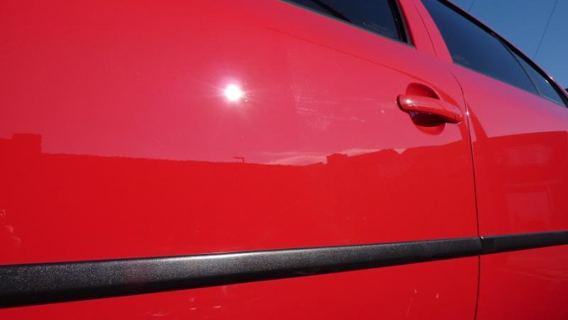

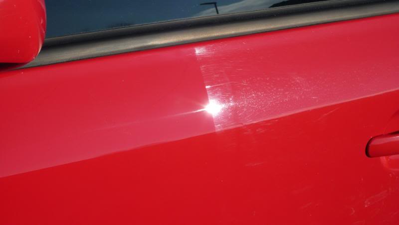

A few 50\50's:

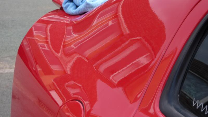

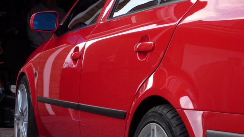

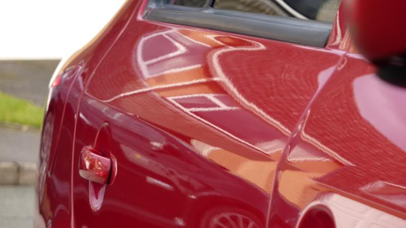

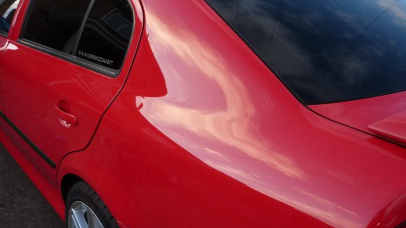

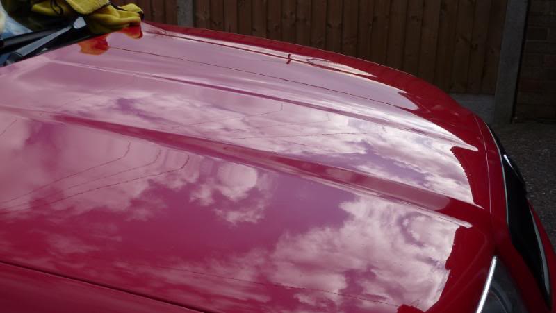

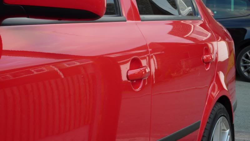

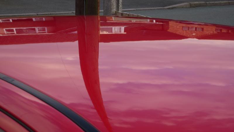

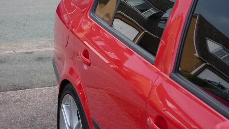

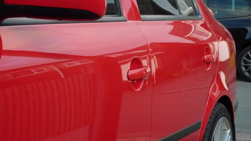

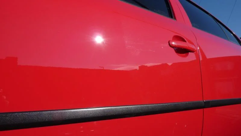

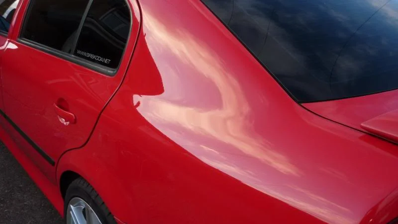

I didn't get many 50/50's due to the amount of bacon I had to get through, but here are a couple of afters:
Remember, none of those pics have any wax or sealant on yet, something which Dave is going to do next weekend. Not bad for a 9 year old car...
The paint was RIDICULOUSLY hard in places and at times I thought I'd been defeated, but after tweaking my technique and pad choice, I managed to get it all corrected in about 6 hours or so. It wasn't perfect, with some RDS's remaining, but 90% or so corrected I'd say.
