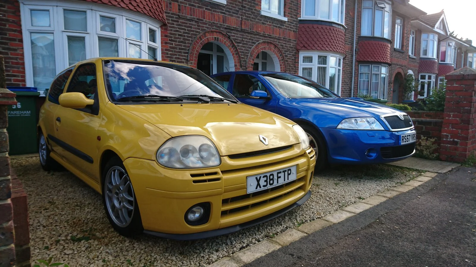

Starting at the beginning, X38FTP was 1st registered on 18th September 2000, and with reference to the Sunflower Register thread, this is the earliest example of the 31 UK registered Sunflower Yellow 172’s. Yes X39 was also registered on the same day, but hey 38 comes first right, so whilst not a limited edition or numbered vehicle this would in some lights be the first registered Sunflower.
I bought the Clio after a run of larger cars and suffering the fate of falling into the people mover trap of a new family. Well that didn’t last long and the urge for a drivers car grew too strong. Having never looked at or driven a Clio 172 before I kept being drawn to the Ph1 version over the Ph2 and a certain Sunflower kept drawing my attention. A trip to Swindon in December 2010 and a short test drive later I was gripped and knew I was buying this.

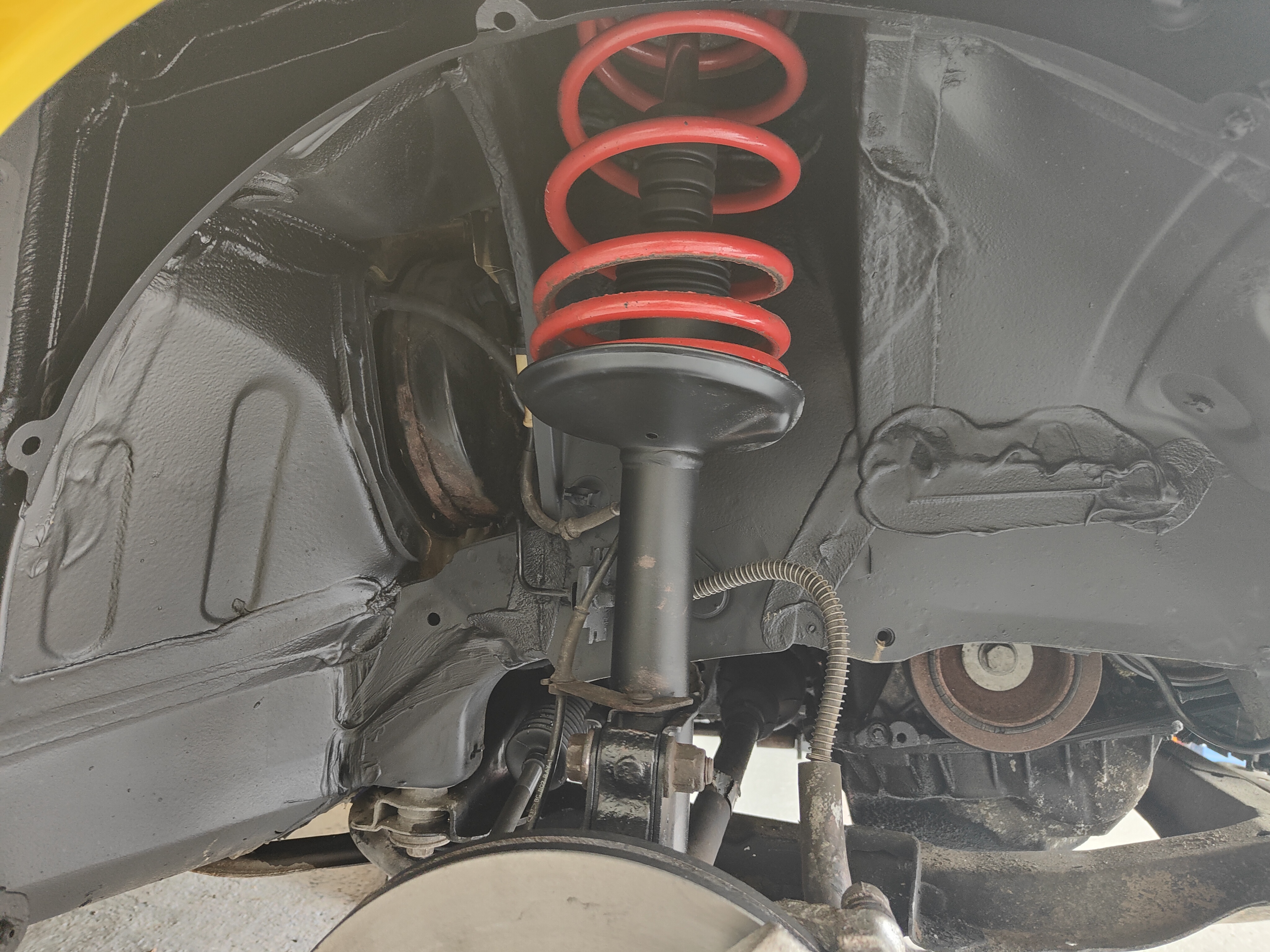

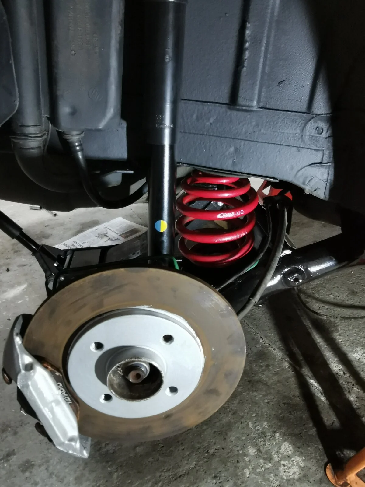

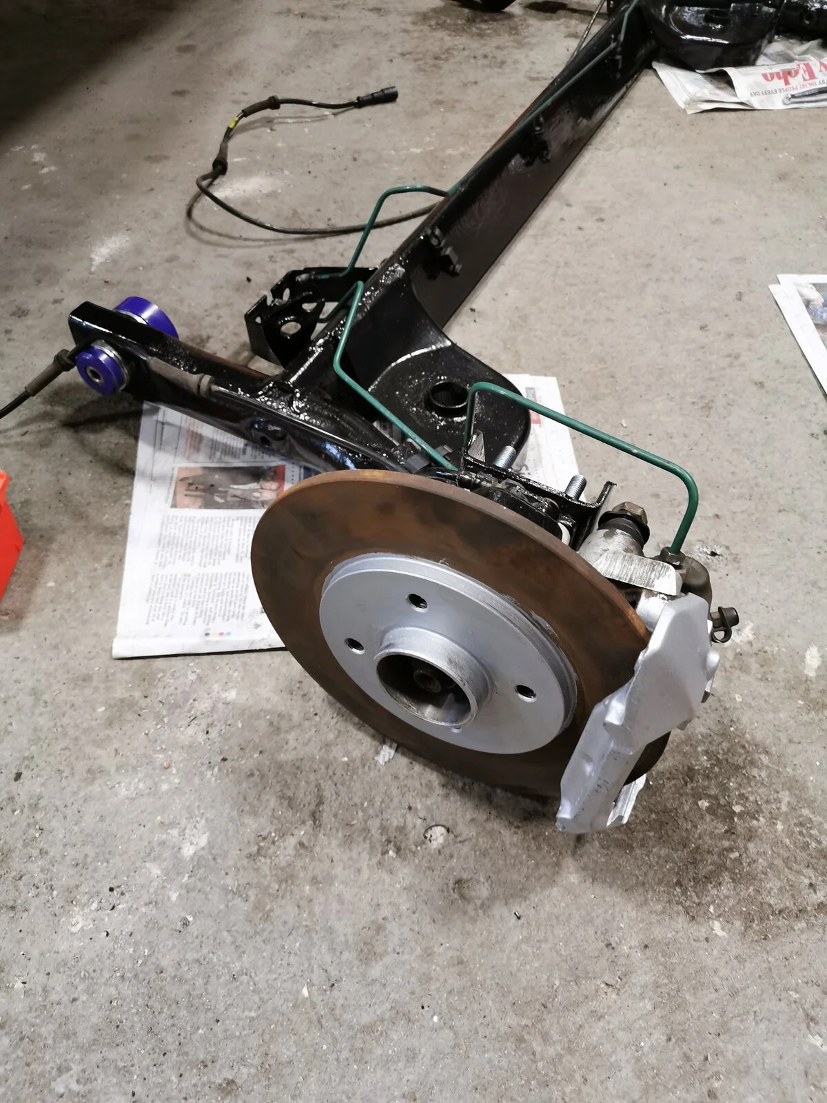

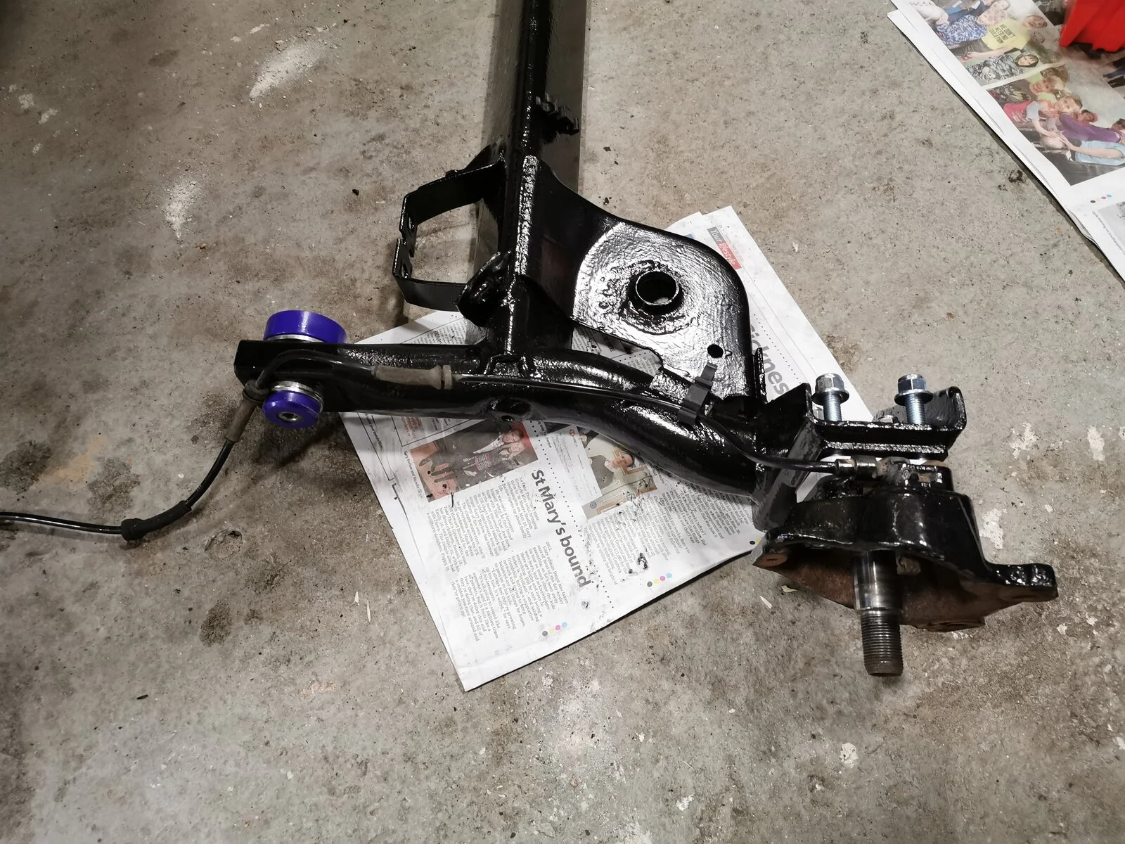

Recently I have made a decent start of the refresh and started work on the rear suspension. Removal of the rear beam allowed me to clean and paint this, along with installation of the PMS rear shim spacers, new Cup rear shocks in addition to Powerflex rear beam bushes and rear shock upper mounts. I already had Eibach Sportline springs in place and these looked in good condition so were reinstalled.

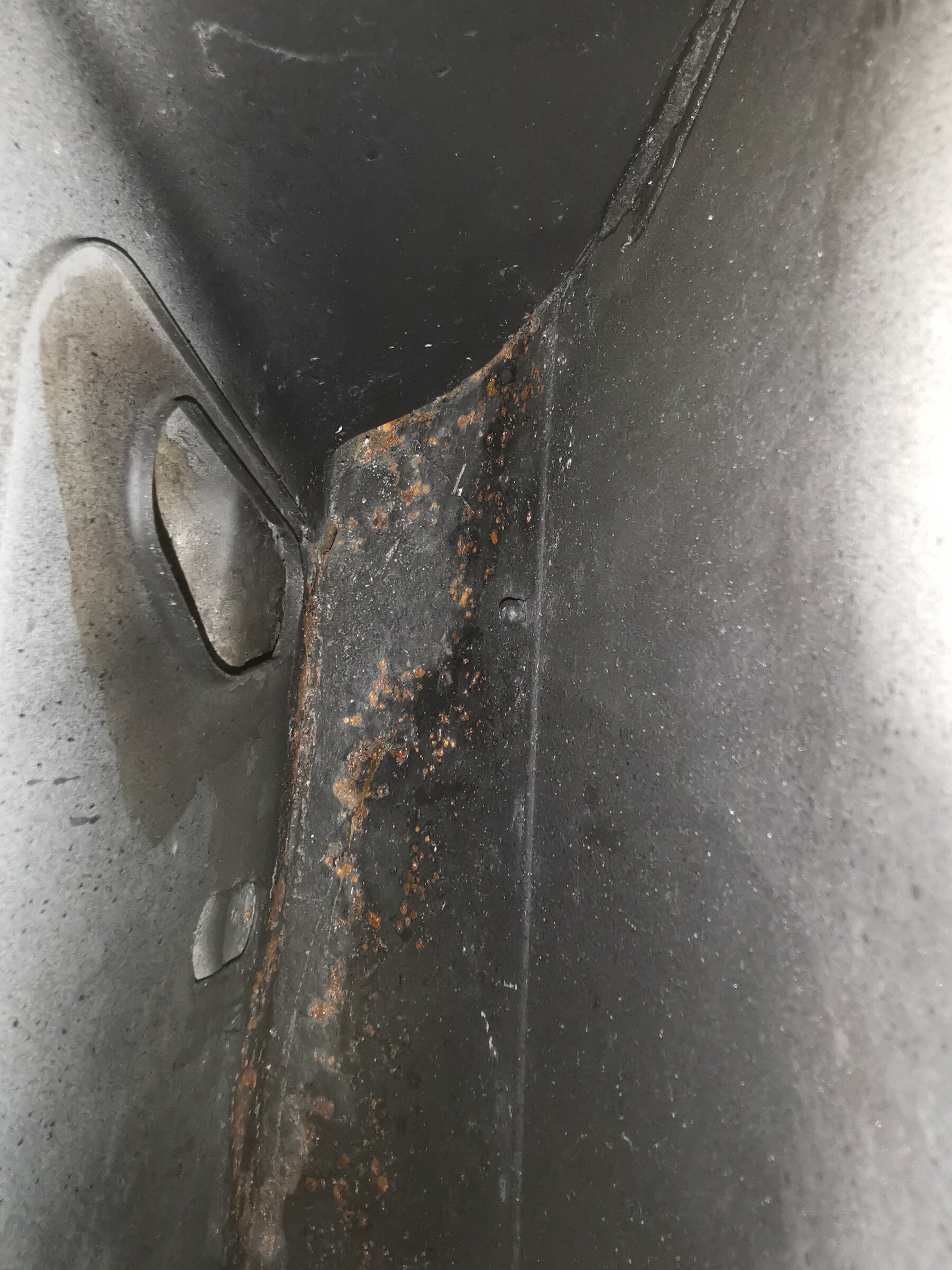

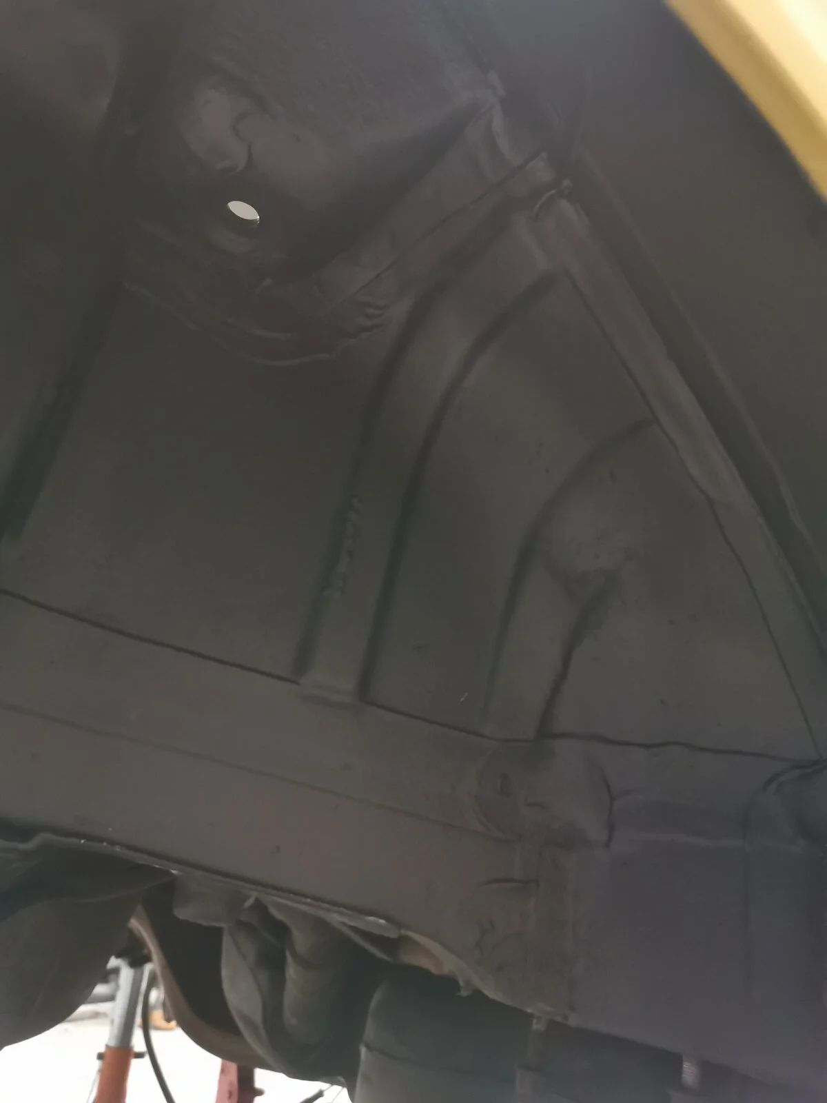

Whilst the beam was out, I also took the opportunity to clean inside the inner arches and apply a protective coat of stone chip. I had intended to fit a set of braided brakes lines too, however these were supplied too long and I am presently awaiting the correct set. Overall the bushes were an ok job and I am pleased with the overall look of the rear of the car now and the spacers have increased the track just enough.
Focus will soon shift to the front suspension, I already have new ball joints, track rods & ends and when back to work looking to order new powerflex wishbone & ARB bushes. What’s the opinion on the power steering rack bushes, OEM or polybush also?

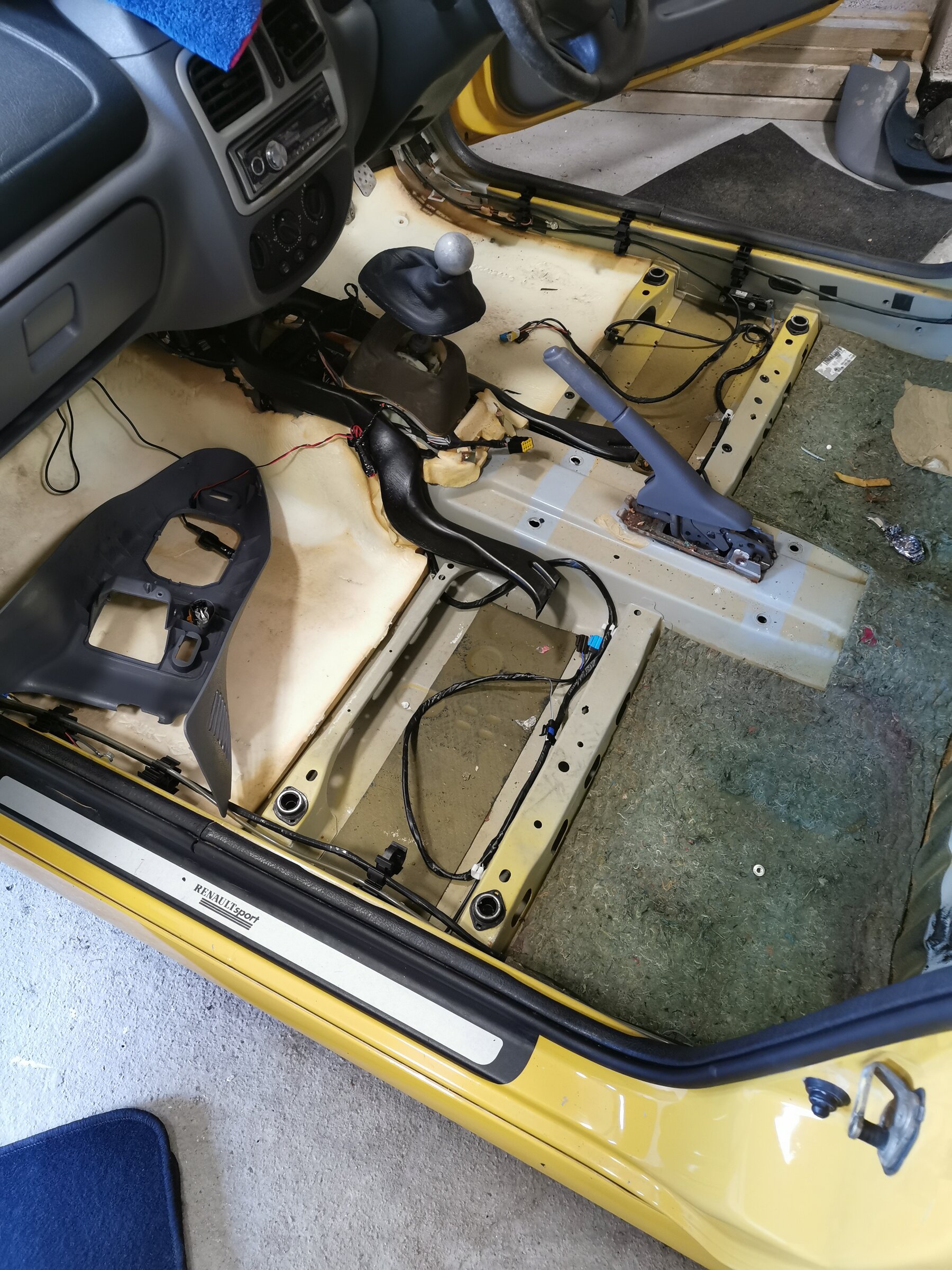

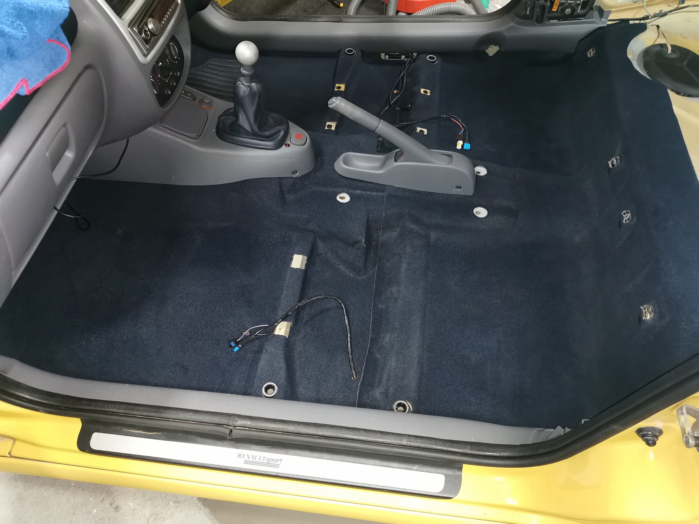

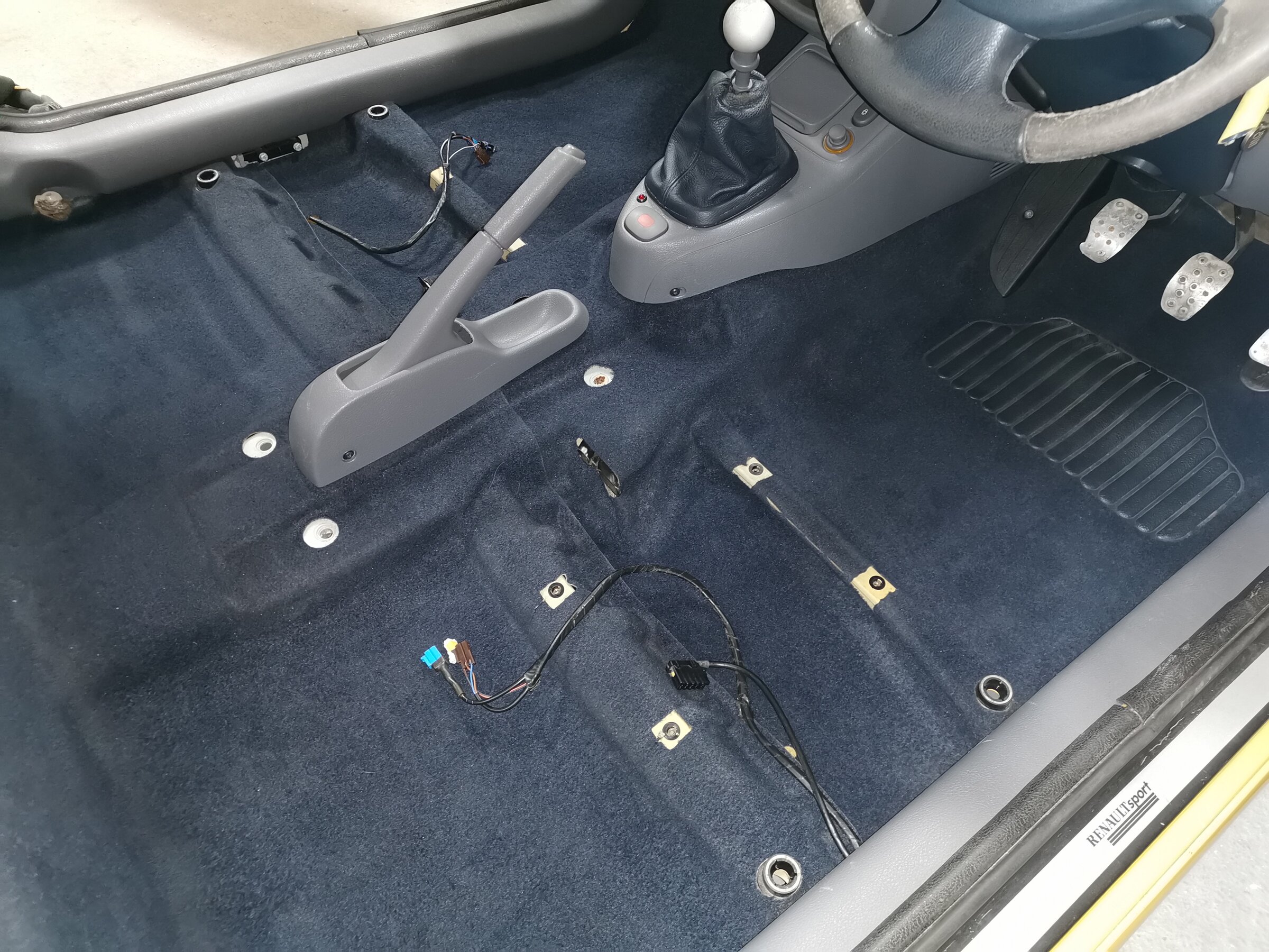

For way too long I've had a replacement front section of carpet in the garage, this was to replace due to a hole in the drivers footwell.
So time on my hands and out came the interior to allow the new carpet to be laid.
Overall just a fiddly job and hardest being getting to the inner seat runner bolts tucked up behind the exhaust.
Have chance to brave the inner sills too and not bad. In future il take skirts off and have proper look but I'm not filled with total dread quite yet.
I've given it another coating of bilt hamber for now though.
With all interior out gave chance for a really good hoover and clean up

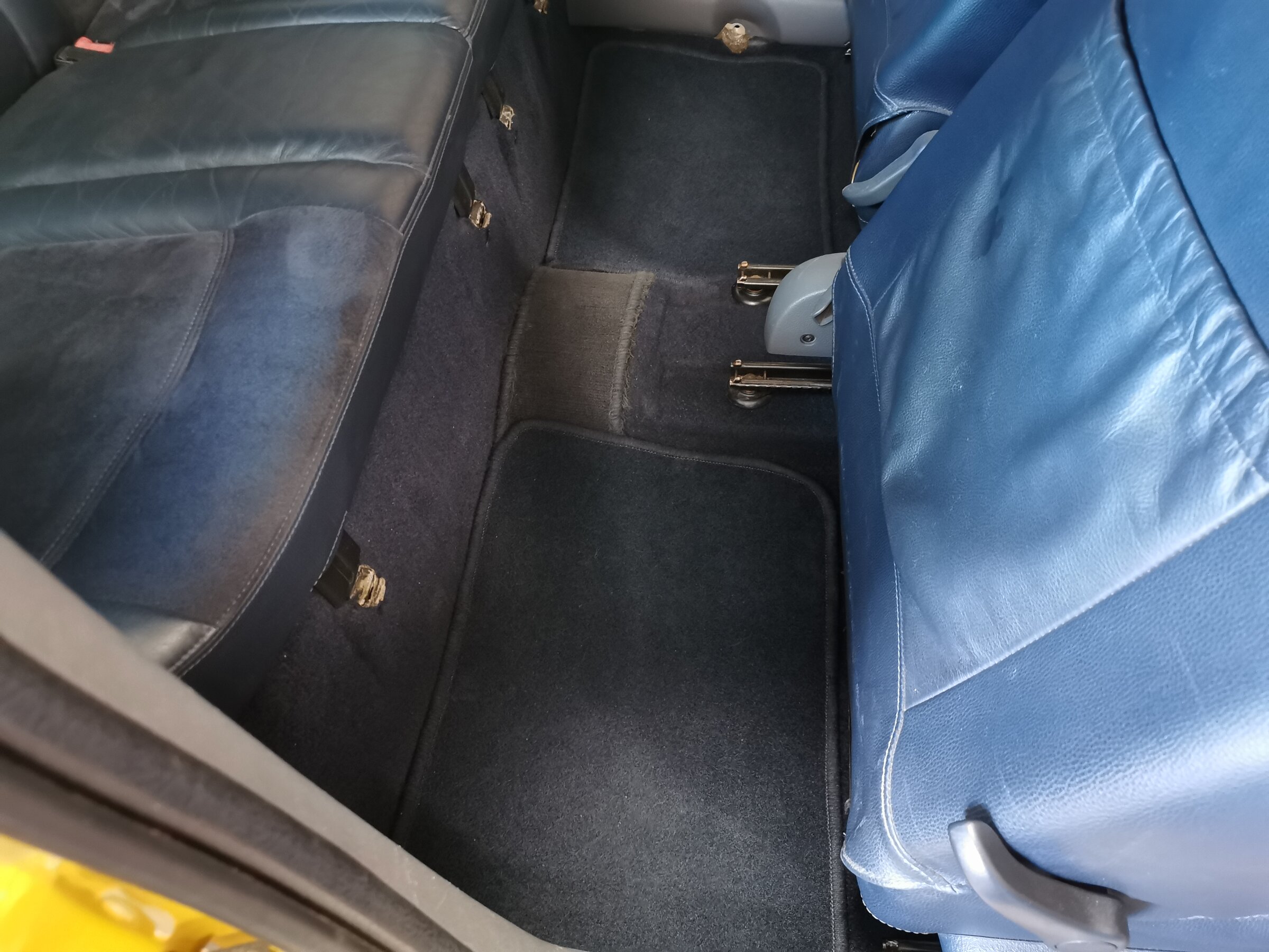

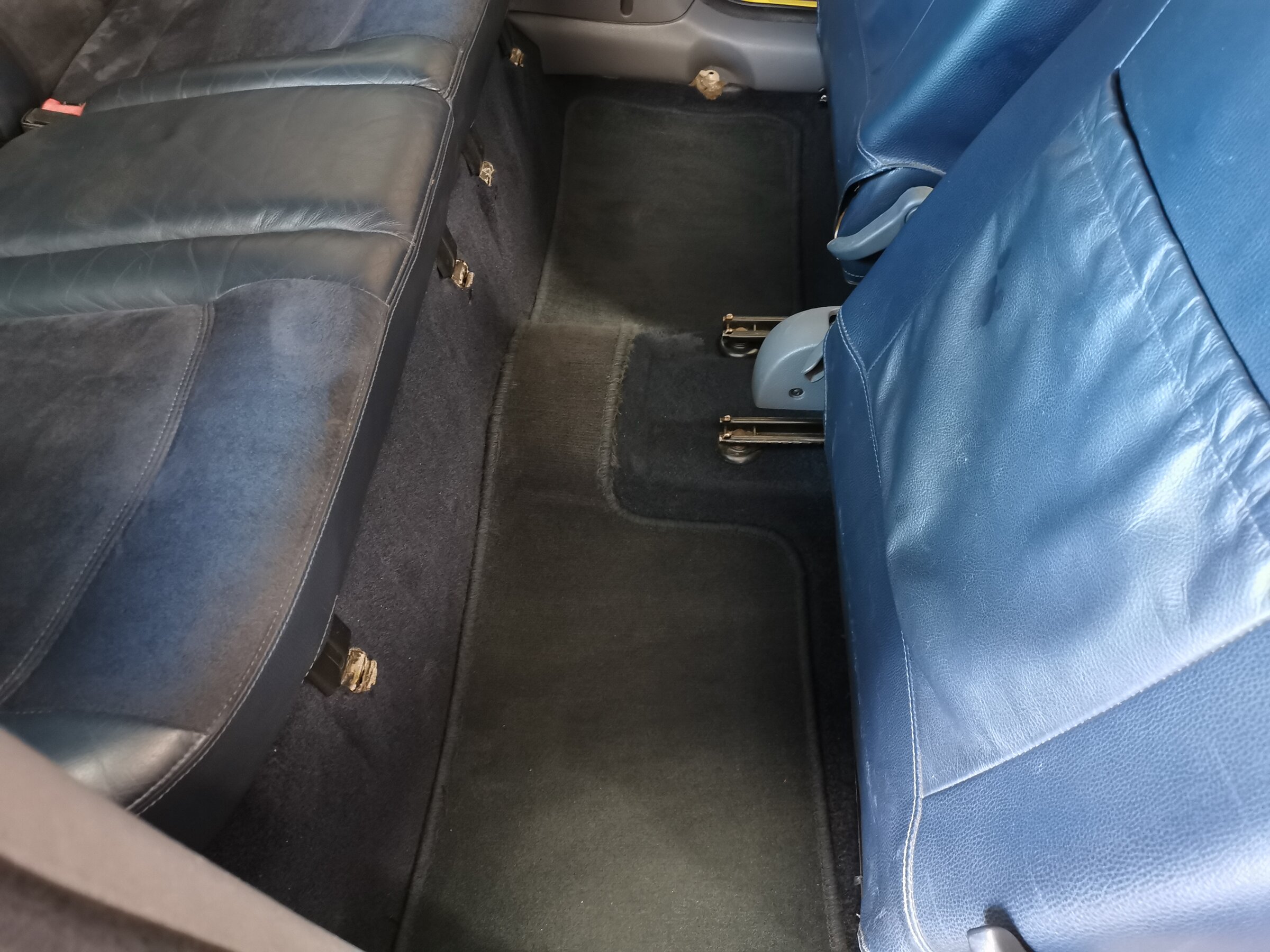

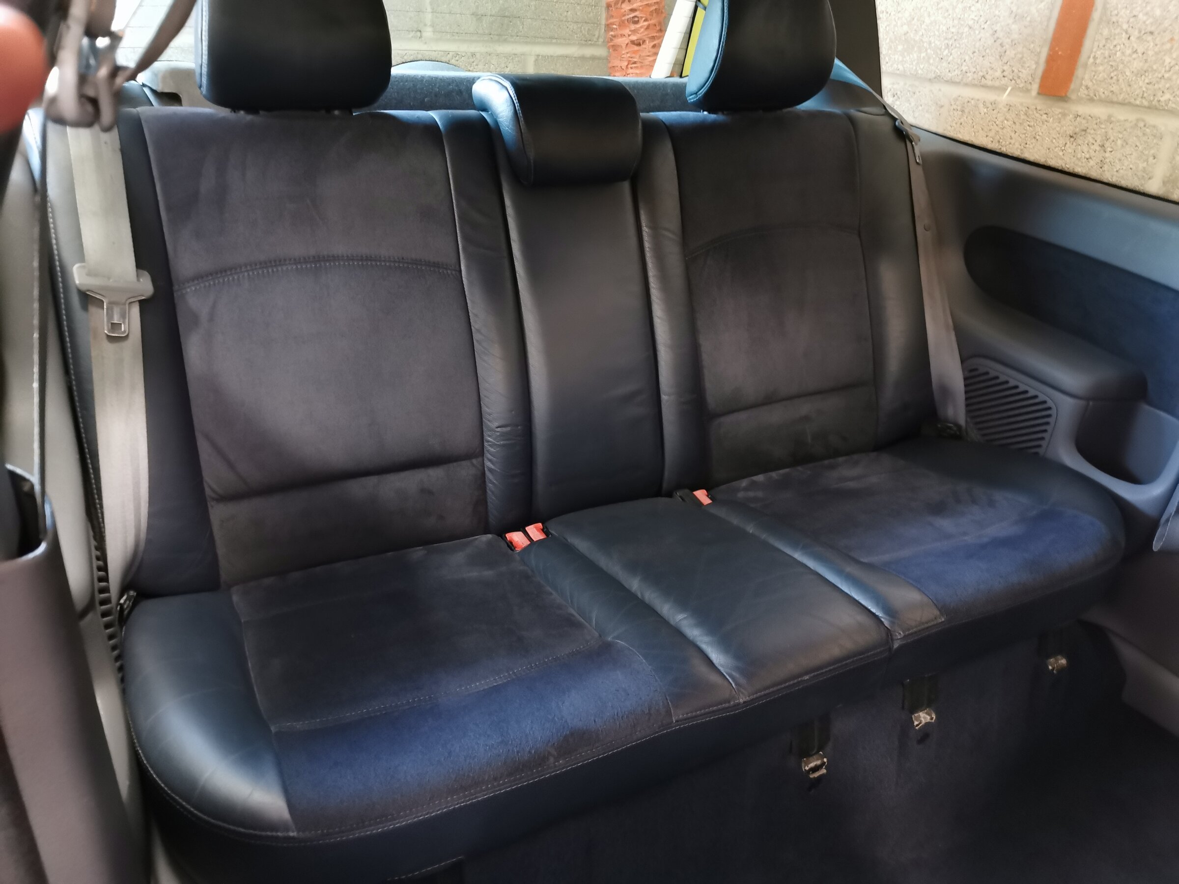

The interior has always been a tail of two halves as I suspect the majority of Spors are. The rear seats being in good condition which considering I ran this as a family car is quite a feat.
Rear also has the original 1 piece floor mat
Then topped for protection with a cheapy tailored set

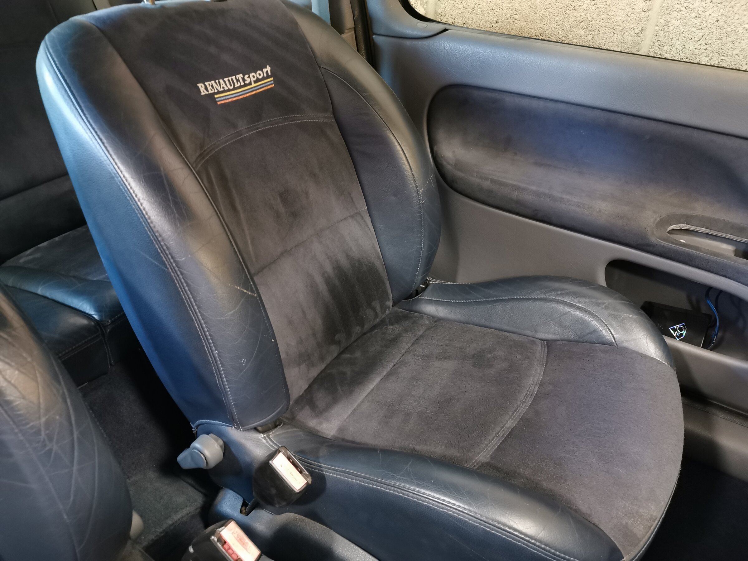

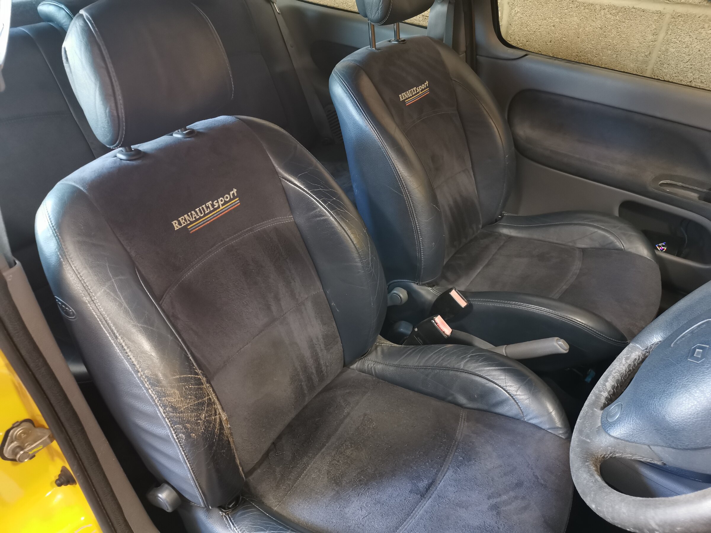

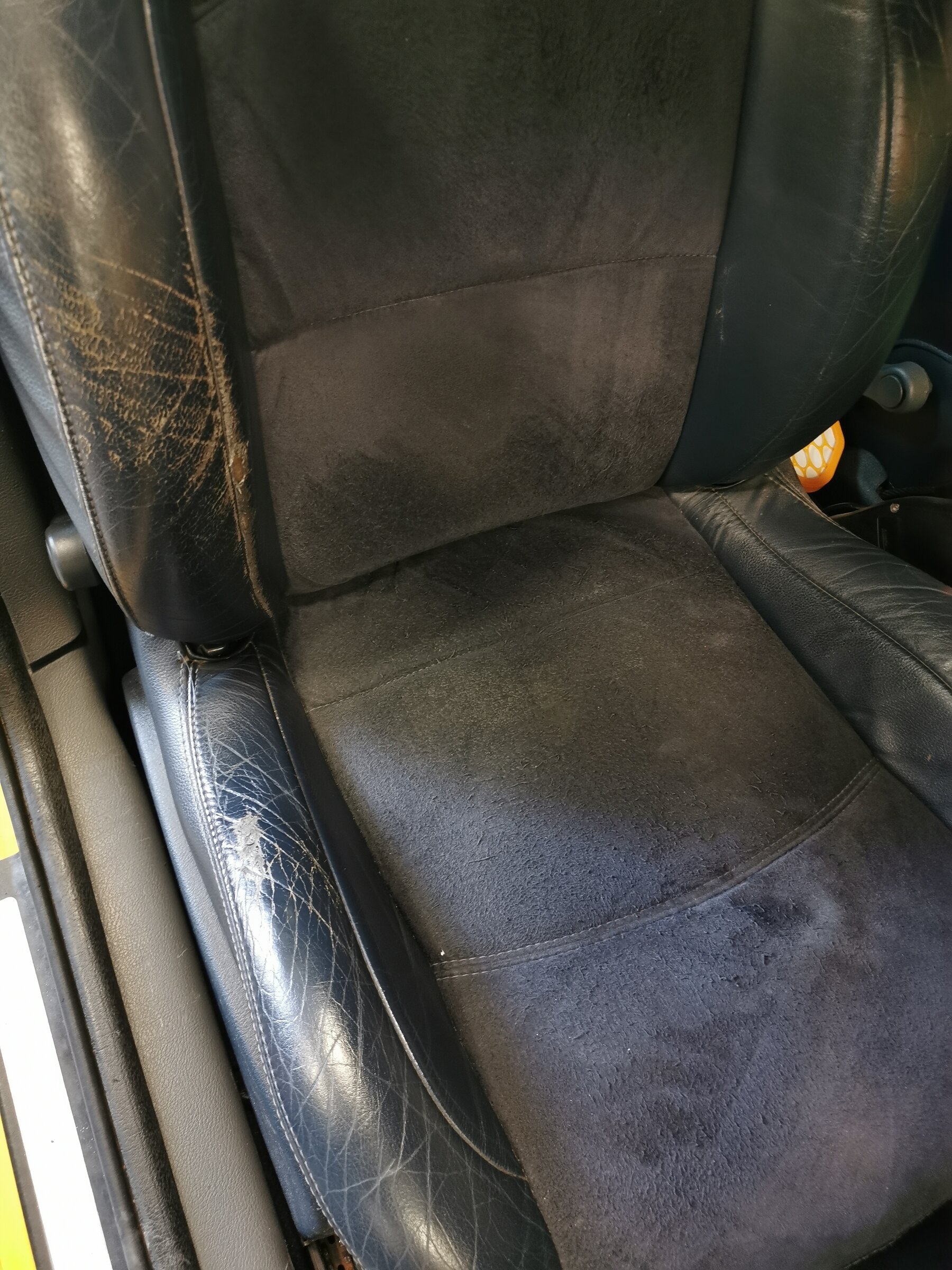

The front seats are in a slightly more worn state. The passenger isn't bad but the seat base could be better and likewise the drivers is showing its fair sign of age and wear sadly.
My plan here is to send the front pair to a local trimmers along with a spare rear seat I have and also a spare pair of front seats with the aim to use all the available original fabric to make as good a front pair as possible. So this should then restore the front seats.

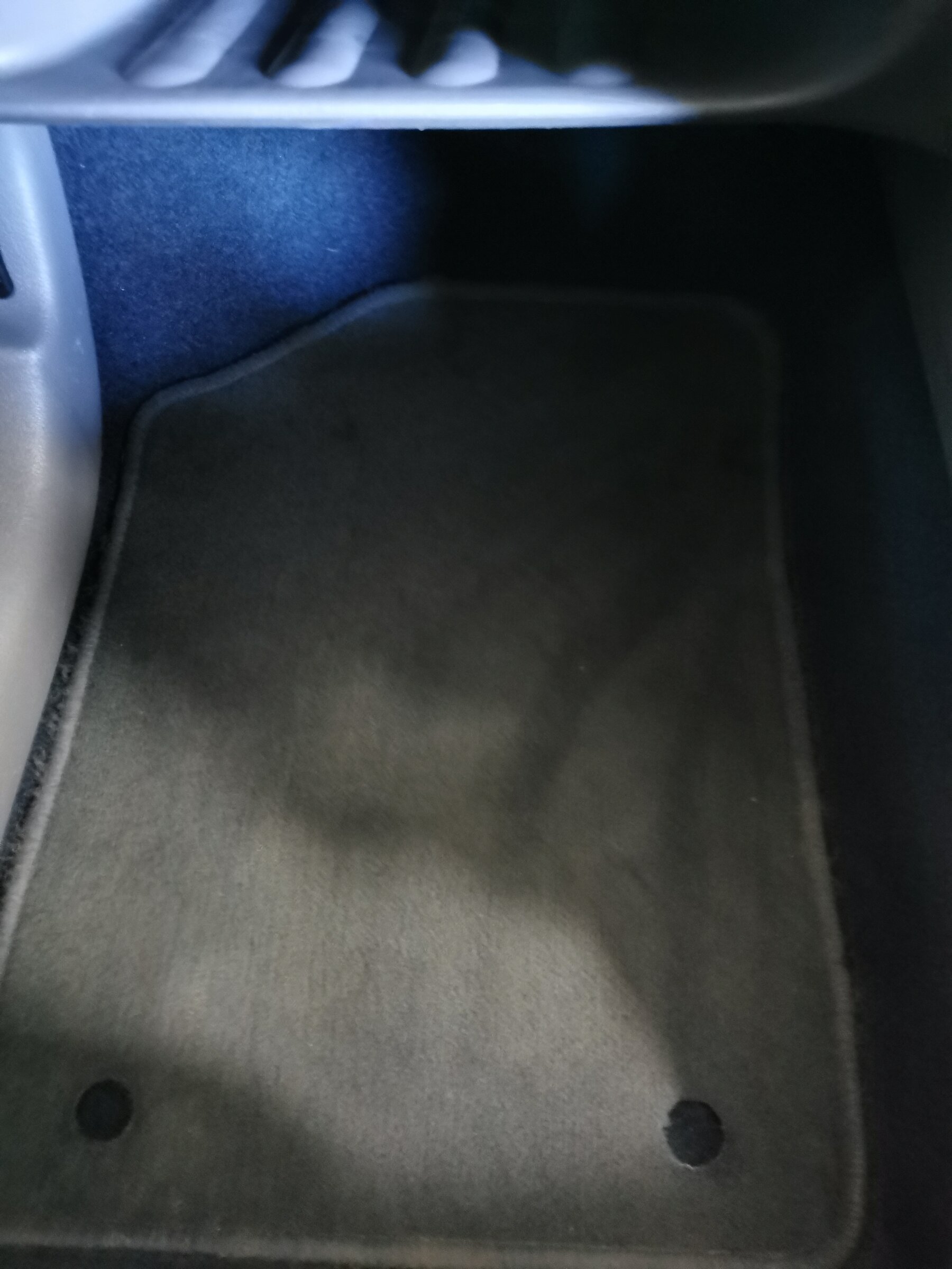

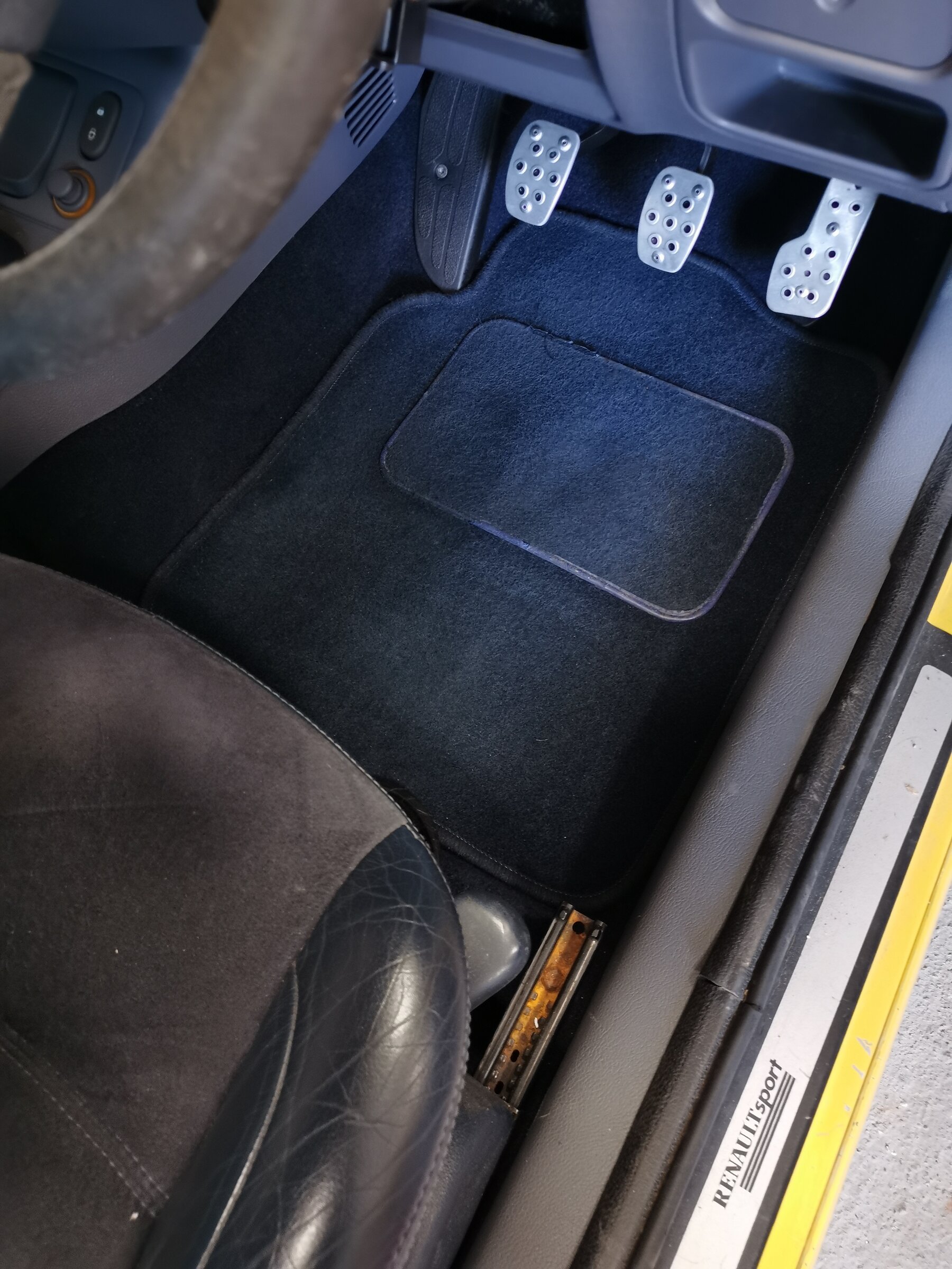

The front passenger also has the original Ph1 mat in place
As can see the originals are somewhat faded. Has anyone had any good results from carpet dye? I'm tempted to try to bring the colour back but don't want to ruin them.
With the new carpet in place the sorry state of the pedals was highlighted. The original Ph1 pedals are NLA and I haven't been convinced by some of the reproductions. The best alternative I felt was a set from the Clio 200 which are very close with just a couple of different rivot placements on the brake and clutch. The throttle however is slightly longer but works OK.
Yes seat runner needs a lick of paint..

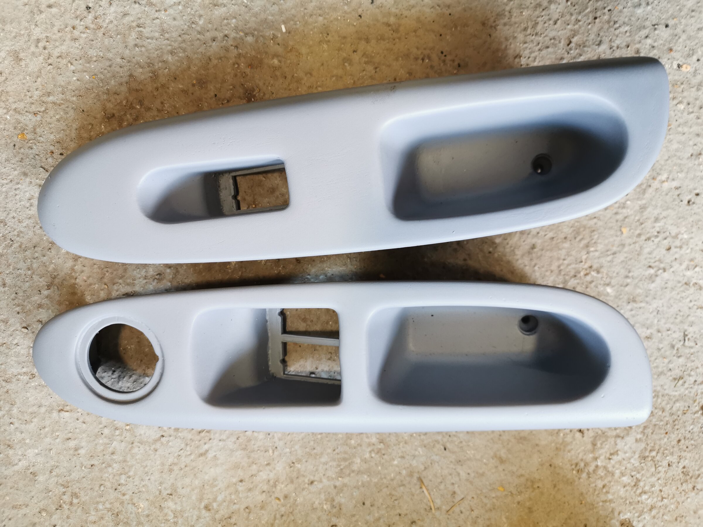

The door pulls were also worn so have been sanded and presently in primer, titanium silver seems a good option so il give them a coat of that shortly.

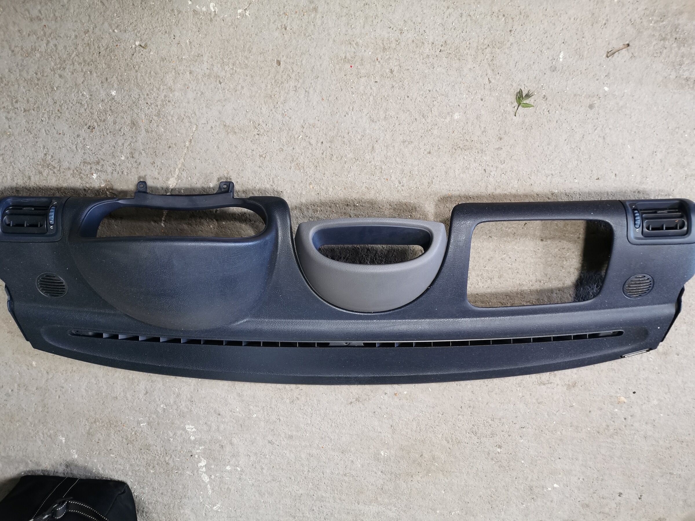

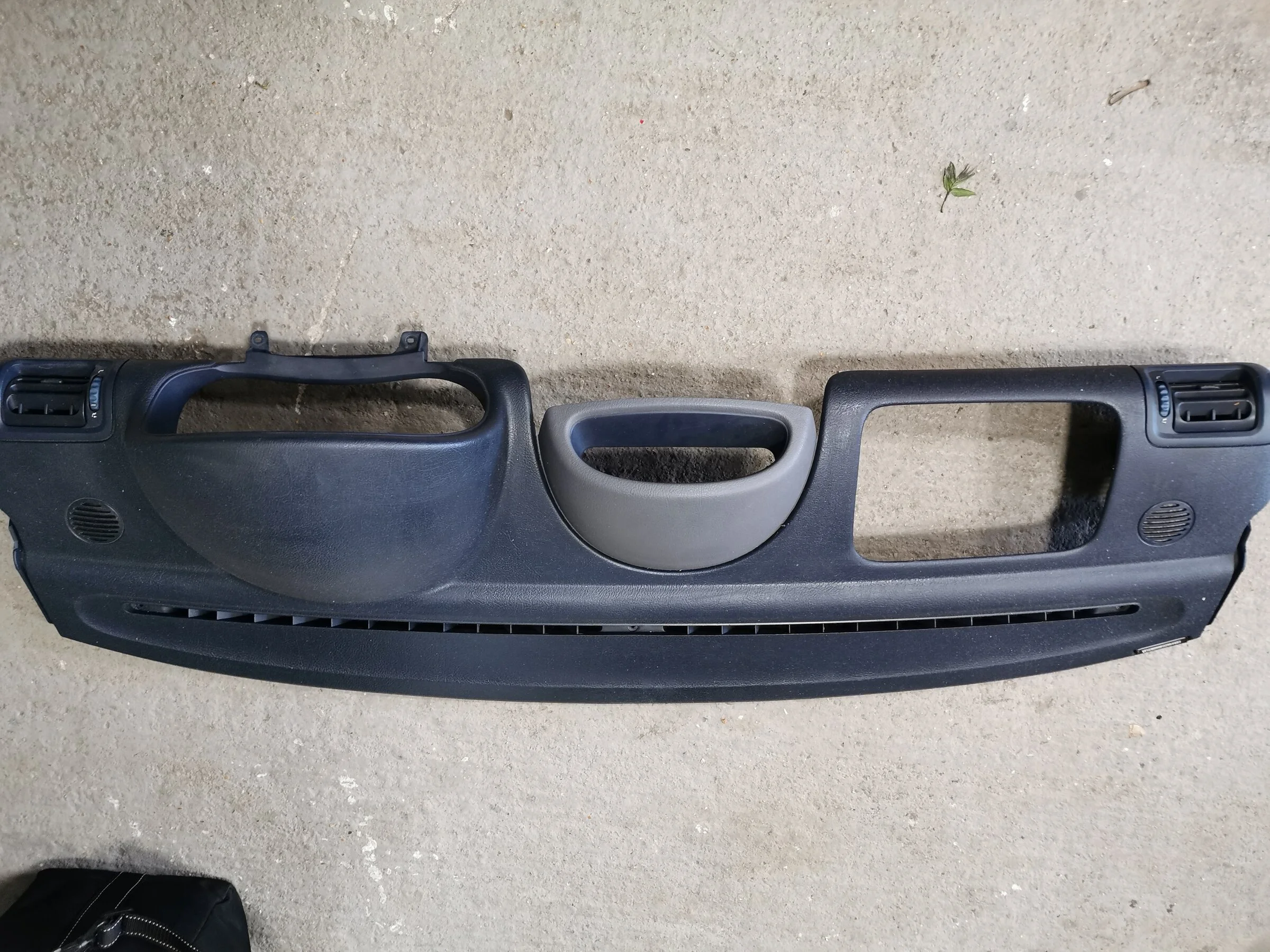

I've also removed the dash top in the hope of giving it a good clean to try and improve upon the sticky feeling. This appears a common issue with Ph1s. Any suggestions how to improve it. So far APC, degreaser, fairy liquid and tar glue remover have had no joy. Any suggestions?

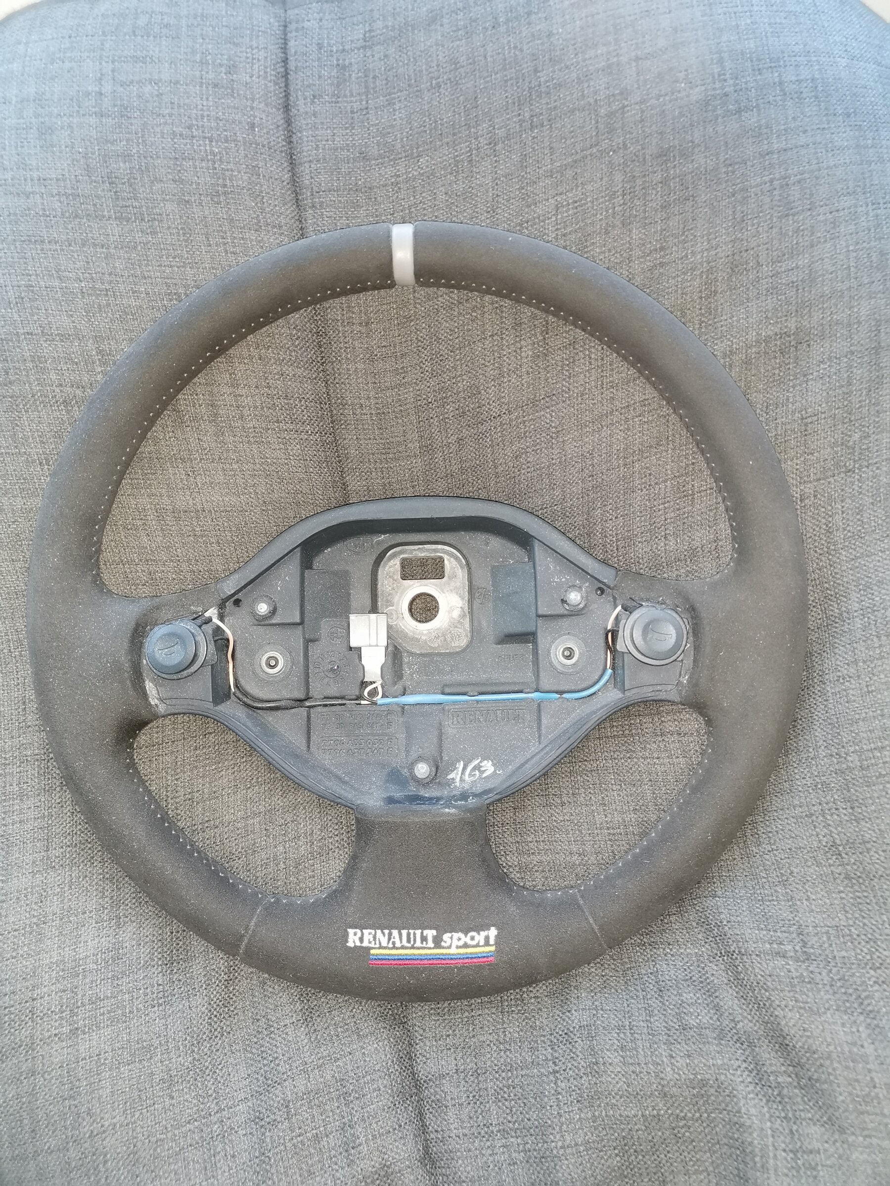

Final cherry on the top when all is done will be the retrimed steering wheel that I acquired from @Ash J following his all to brief Ph1 ownership.

Any suggestions about the dash and air vent gratefully recieved

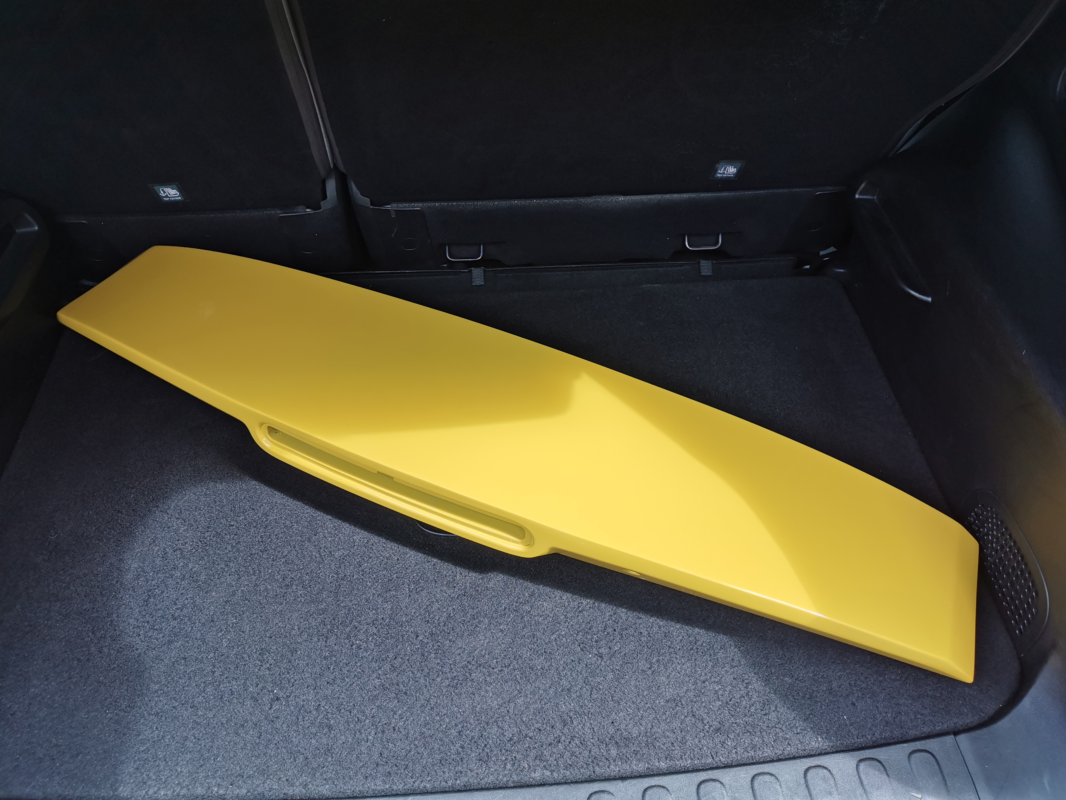

Ive also finally had the Cup spolier painted from black to yellow. Considering it was painted off the car its not a bad match

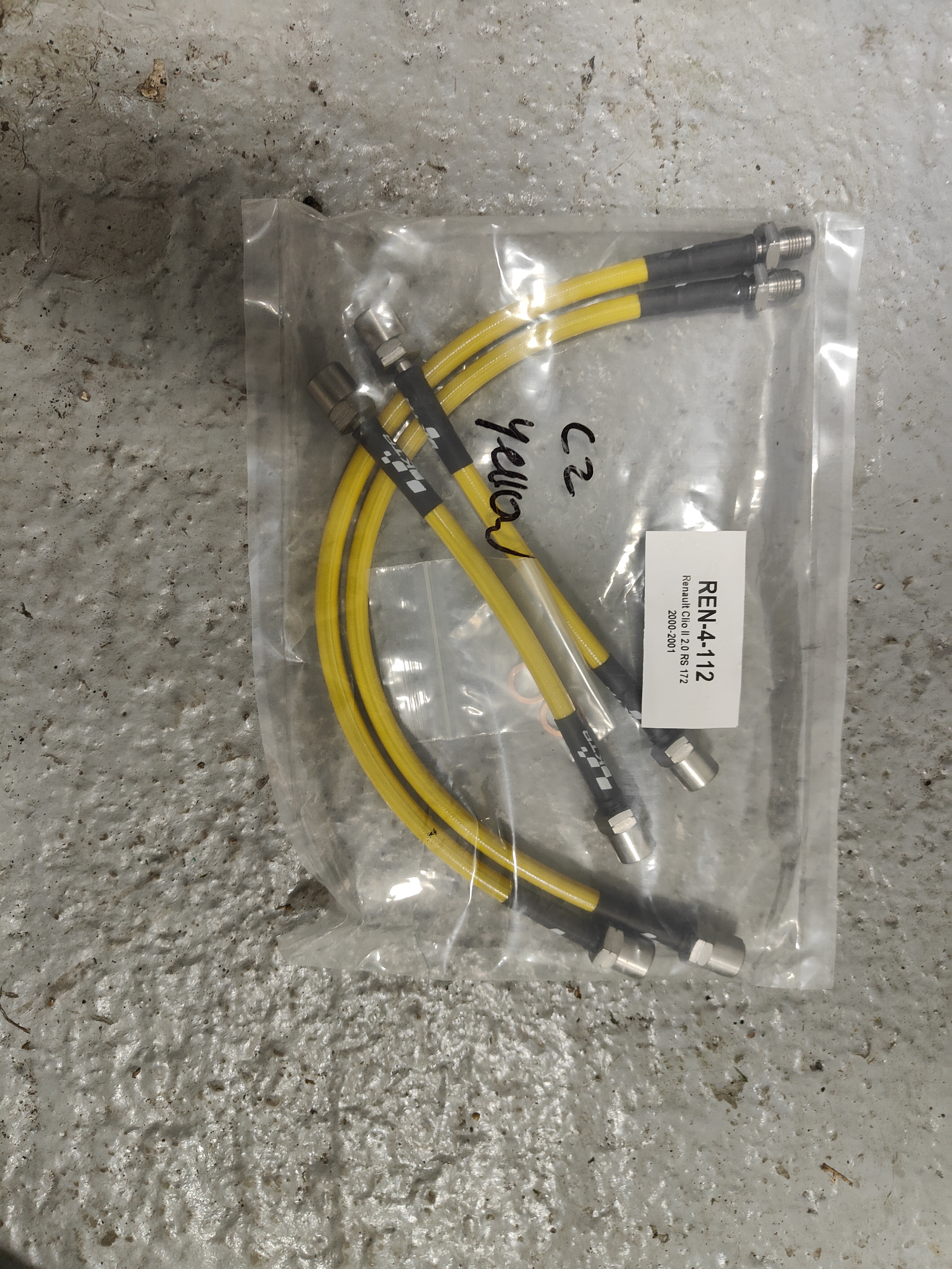

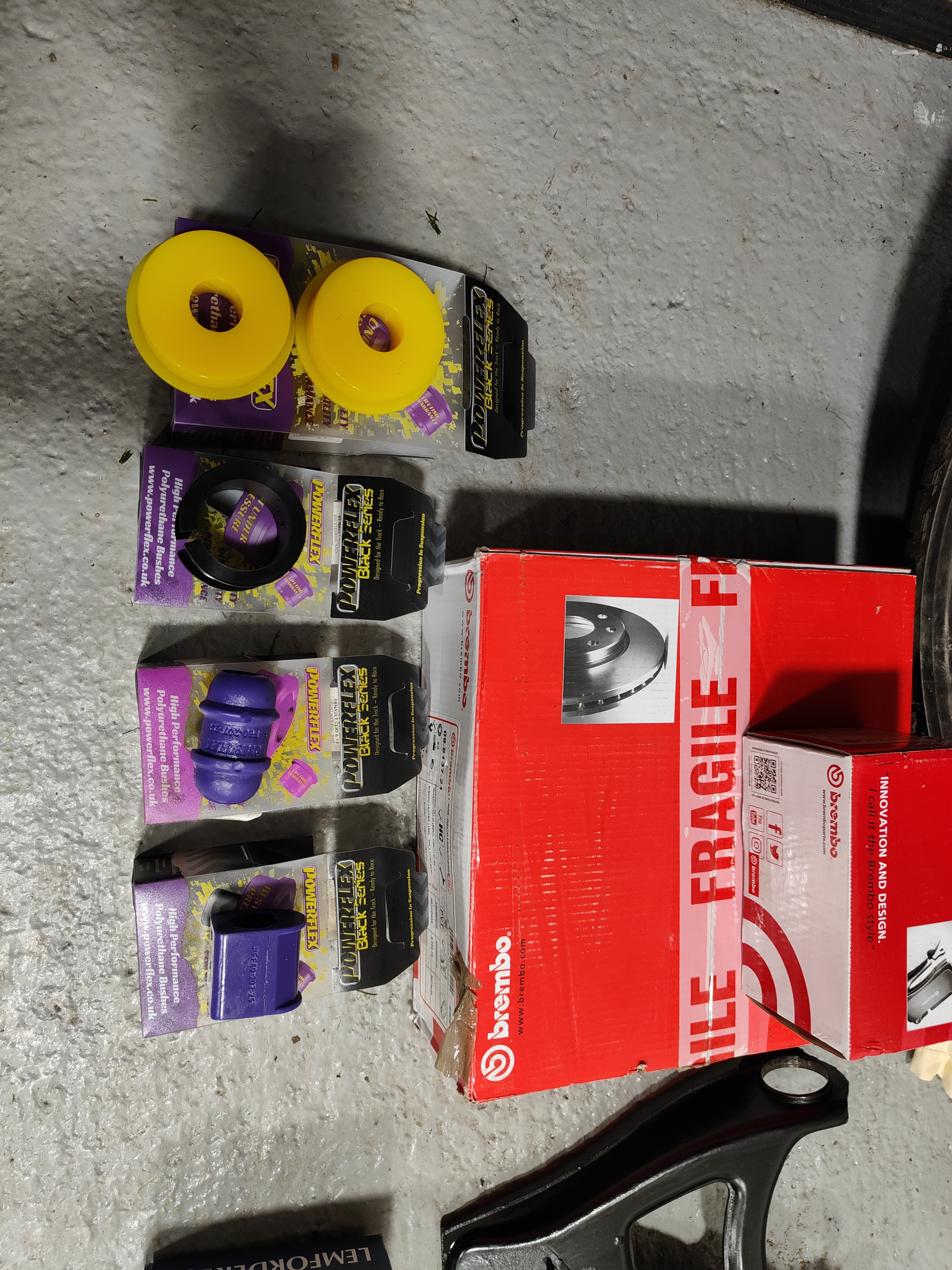

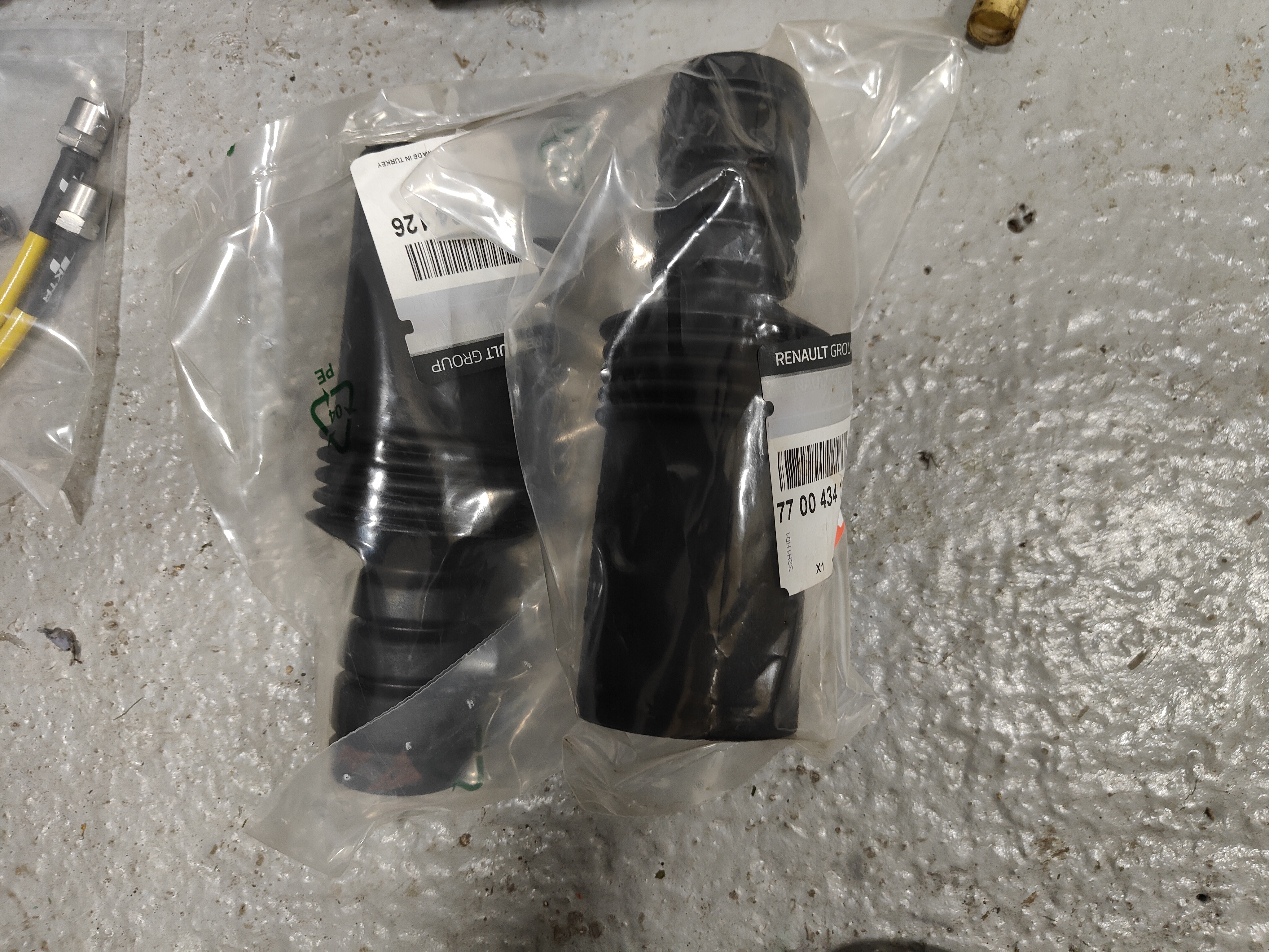

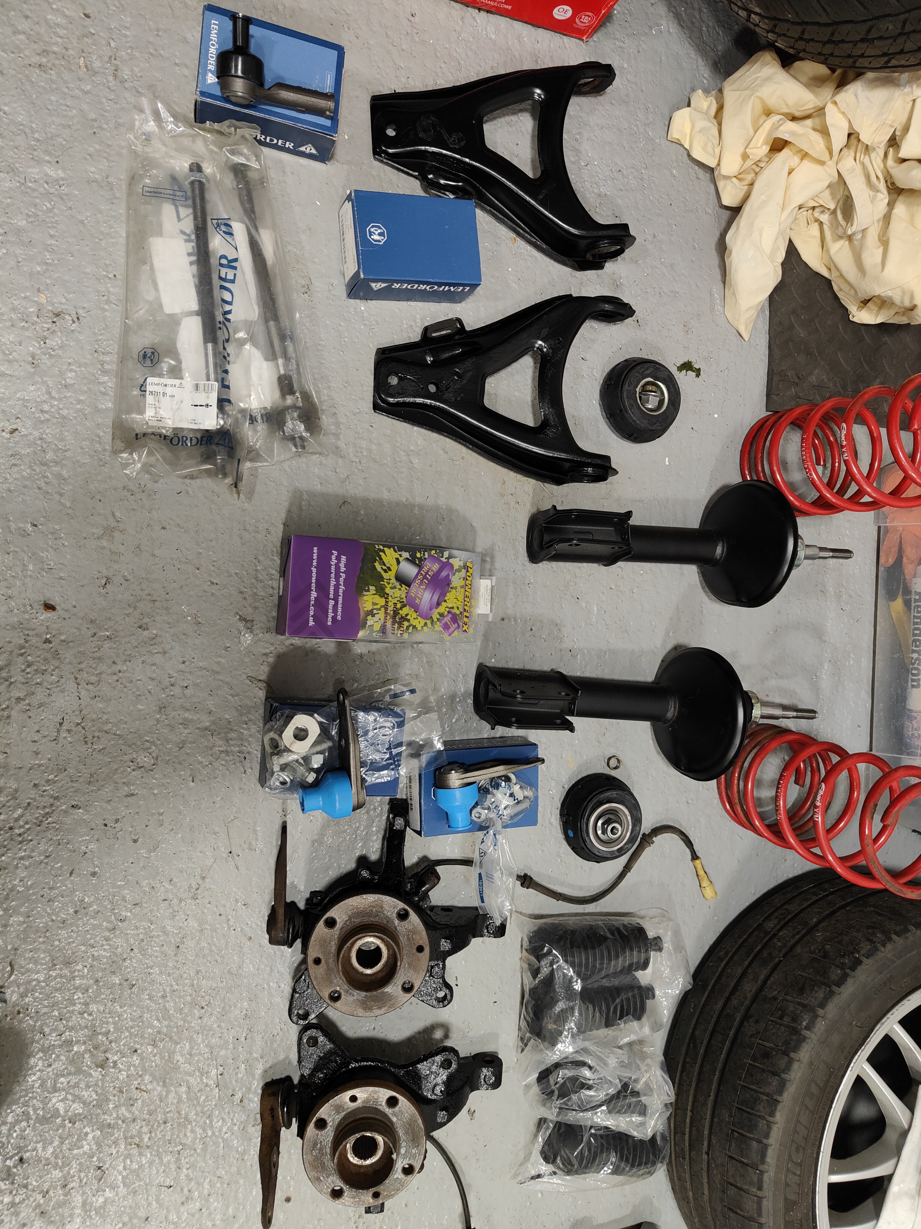

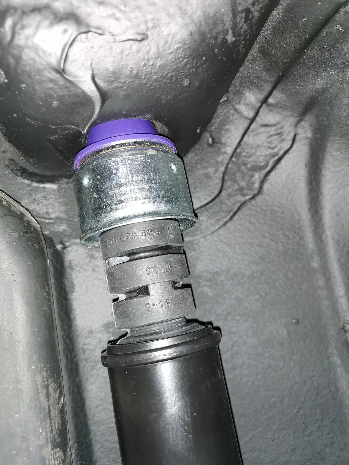

Ive been stashing parts for the front suspension refresh for a while now and over last month of Saturday nights have been making progress.
New parts include, Original 172 Cup shocks, Original Shock boots, Original topmounts, powerflex purple wishbone, inner / outer ARB bushes, Powerflex dogbone mount, Powerflex steering rack bushes, replacement ball joints, track rods and ends, new steering rack gaitors, K-tec braided hoses, Brembo discs & pads and finally PMS spacers.
As you can see Ive given the hubs and wishbones a lick of paint, had another coat after the picture also. Likewise cleaned and painted in the inner arches in similar fashion to the rears.
What I will say is to anyone thinking of changing the steering rack bushes is dont. Pay someone. what an awful job. But done now and the frustration forgotton about. Not all good news, but not the worst, nearside caliper is seized so a replacement is being obtained so that has held up a little progress.
Still to finish off the wishbones ( need bushes pressing in) and the brake lines once the new caliper has arrived.

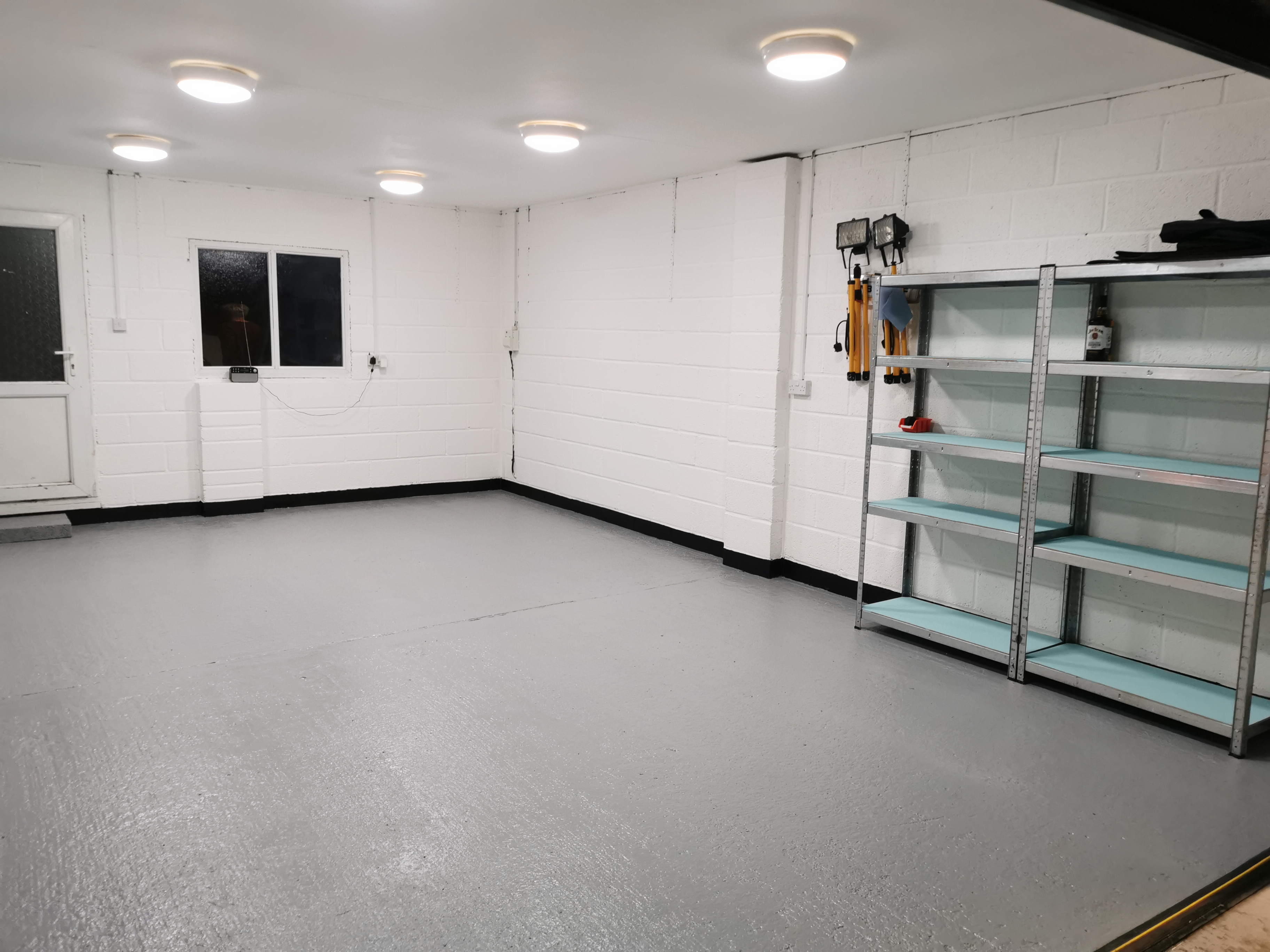

As further update off topic, also painted the garage so much nicer place to be working and nicer home for the sunny

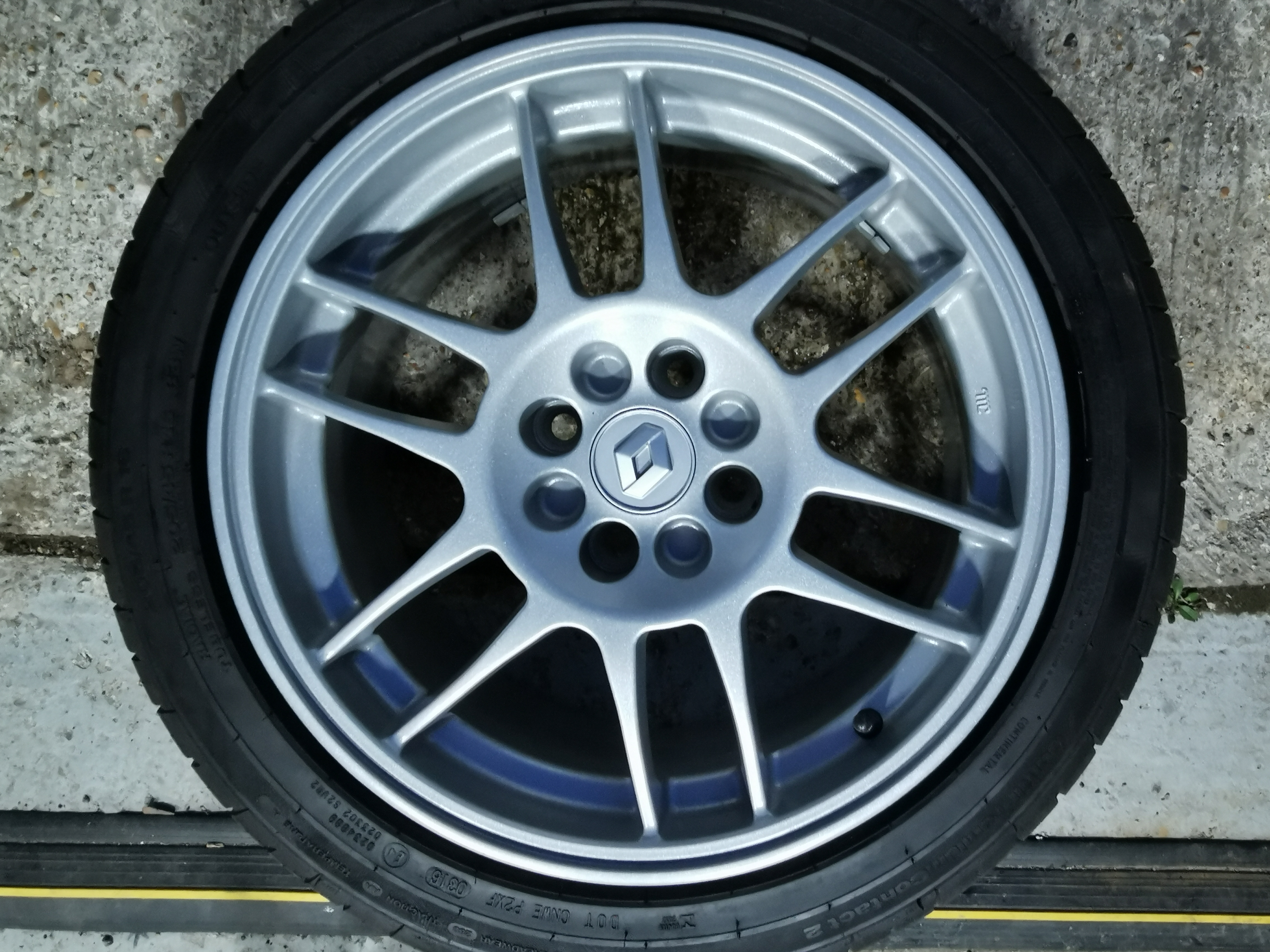

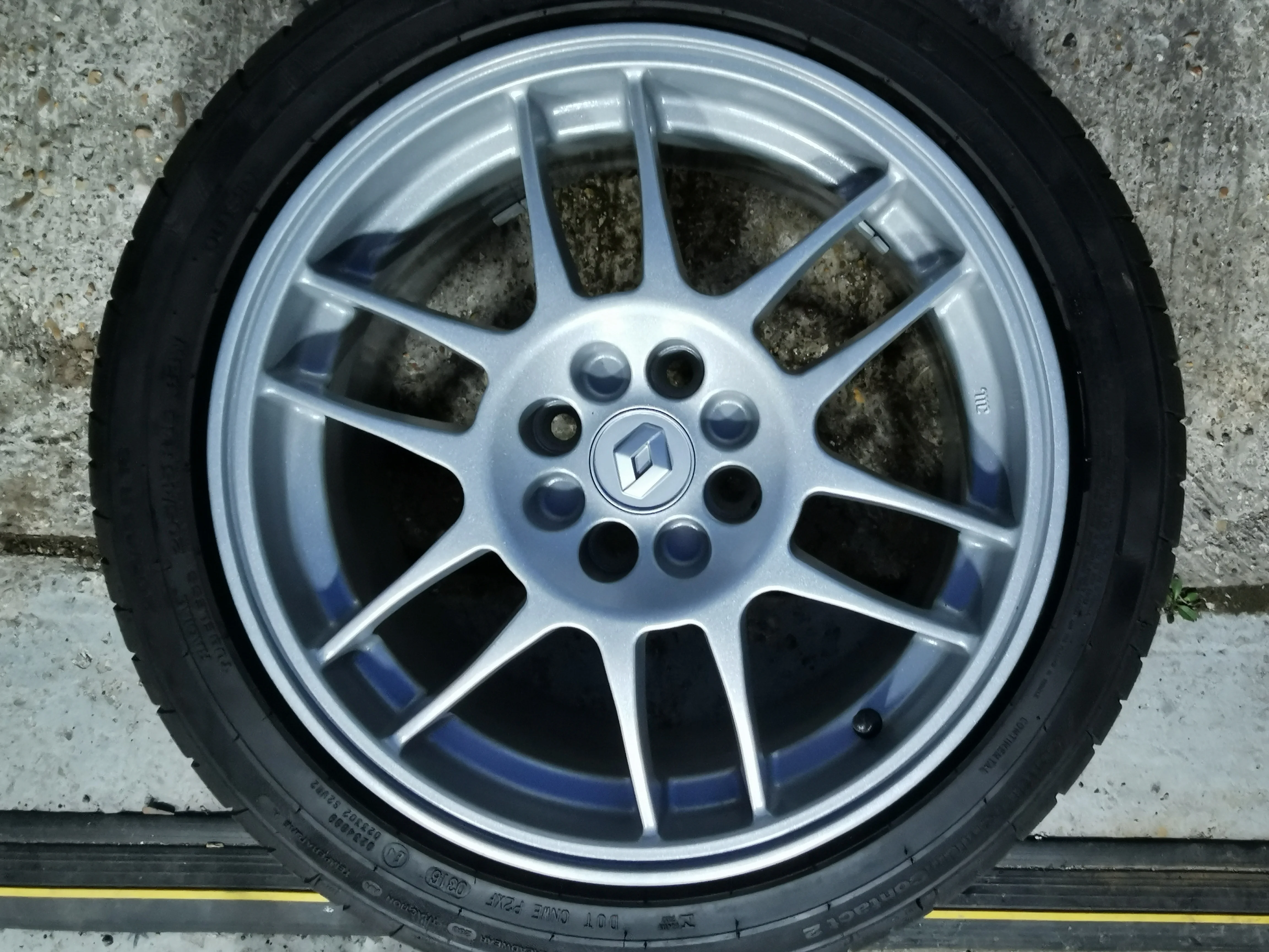

And finally, after years and years I have now obtained a set of 16" F1s. So #1/31 now has both the optional alloy bonnet and 16" wheels. Tyres have been replaced with 195 PS3's and just waiting to ceramic coat them and fit once shes about to return to the road.

Top work on getting the 16”s - every sunny should have them IMO 😆

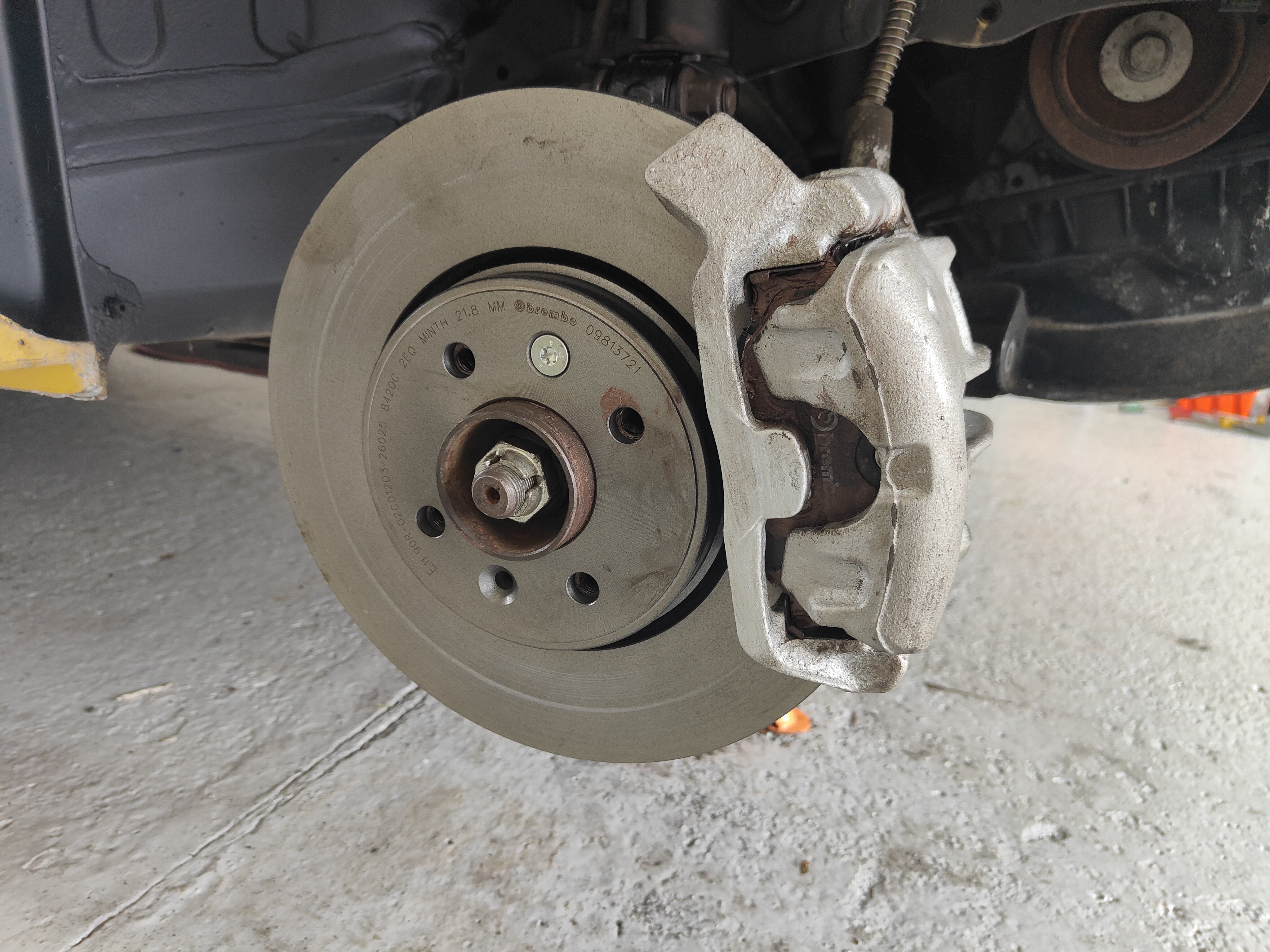

Great work, one quick thing though is you caliper carriers are on the wrong side.
See how the extra bit is at the top? Should be at the bottom. Common mistake

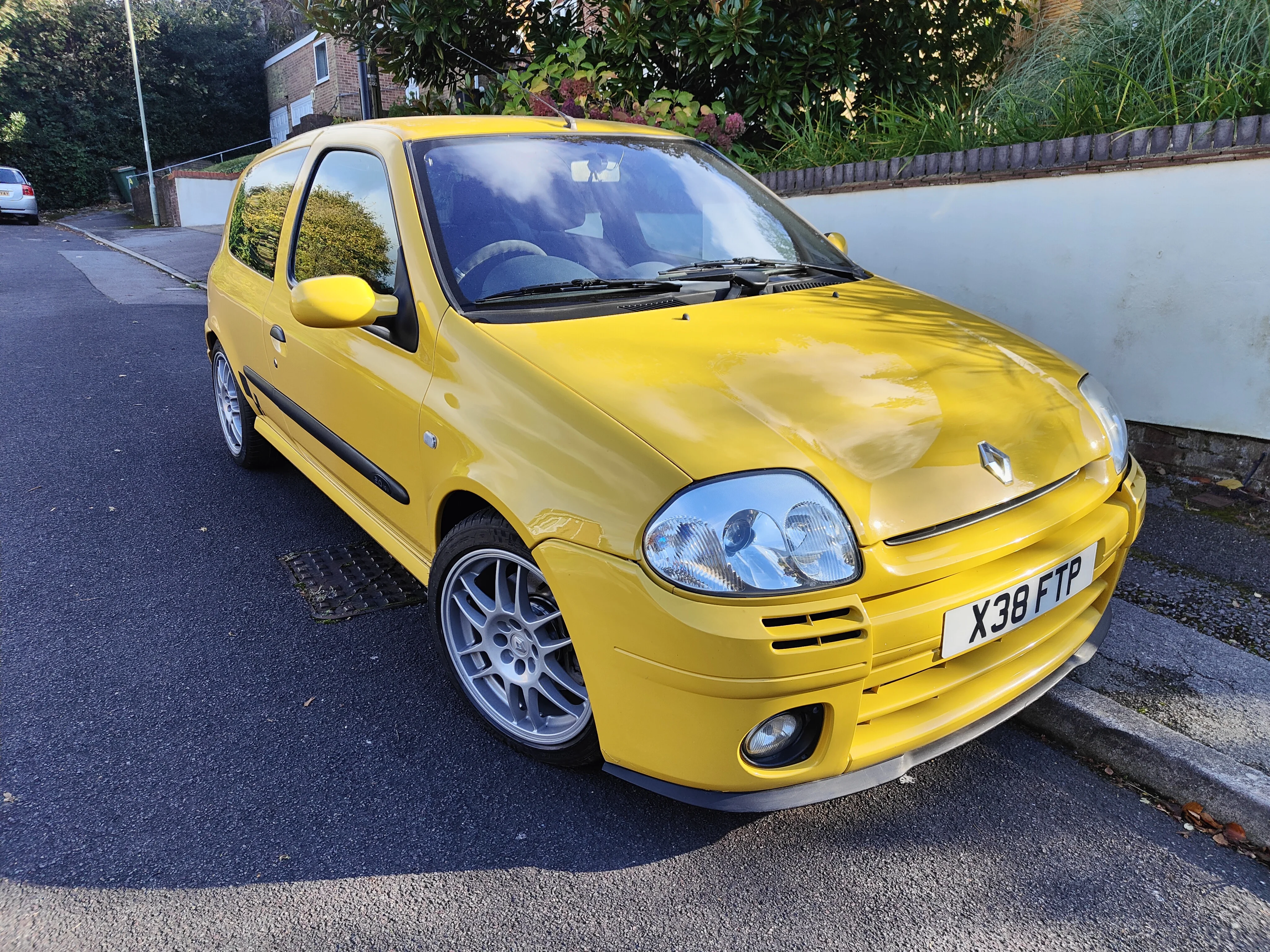

I actually drove it today in fact. Rarely comes out but took the mood today
