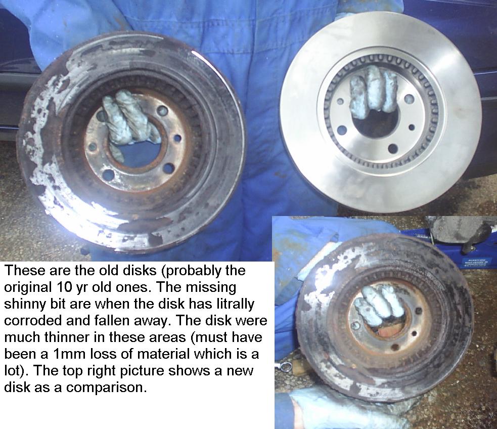

Corroded disks picture
Have a look at the attached photo of the disk which were on a Clio.
The picture doesn't show how bad the corrosion and thinness is as well.
Interesitingly the front sides of the disk weren't to bad (maybe as this is the side which get washed with water which removes the muck).

yeh thats my car ben. i never thought to check the back of the discs really. i just kept looking at the front and since they were ok i thought they must be fine. id say they were scraping for a couple of months before i changed em too.

You can see how bad the corrosion is on the outer edge too, They're very bad!! :eek:
They were well overdue replacing were them!

mine looked just like that from my cup after 2.5yrs and 14000miles............crap.
If they looked like that then you need to brake harder or the slider doesn't work.
Bunzee We think they were the opriginal so 10 years old or so.
