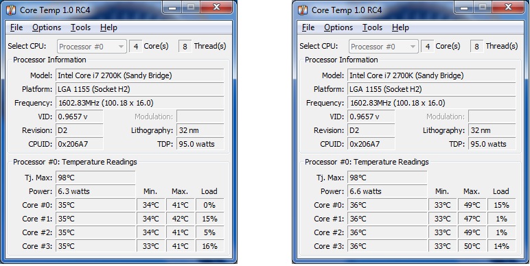

Right then, I've cleaned all the CPU and heatsink up and applied new thermal paste. Here's a couple of readings -
36c better? :cool:
Will definitely be getting an aftermartket heatsink in the next month or so but this will tie me over for the time being. :)
Cookie
Much better. The thermal pad material stuff on the OEM unit is facking terrible, it may as well not be there for all the thermal properties it lacks.
