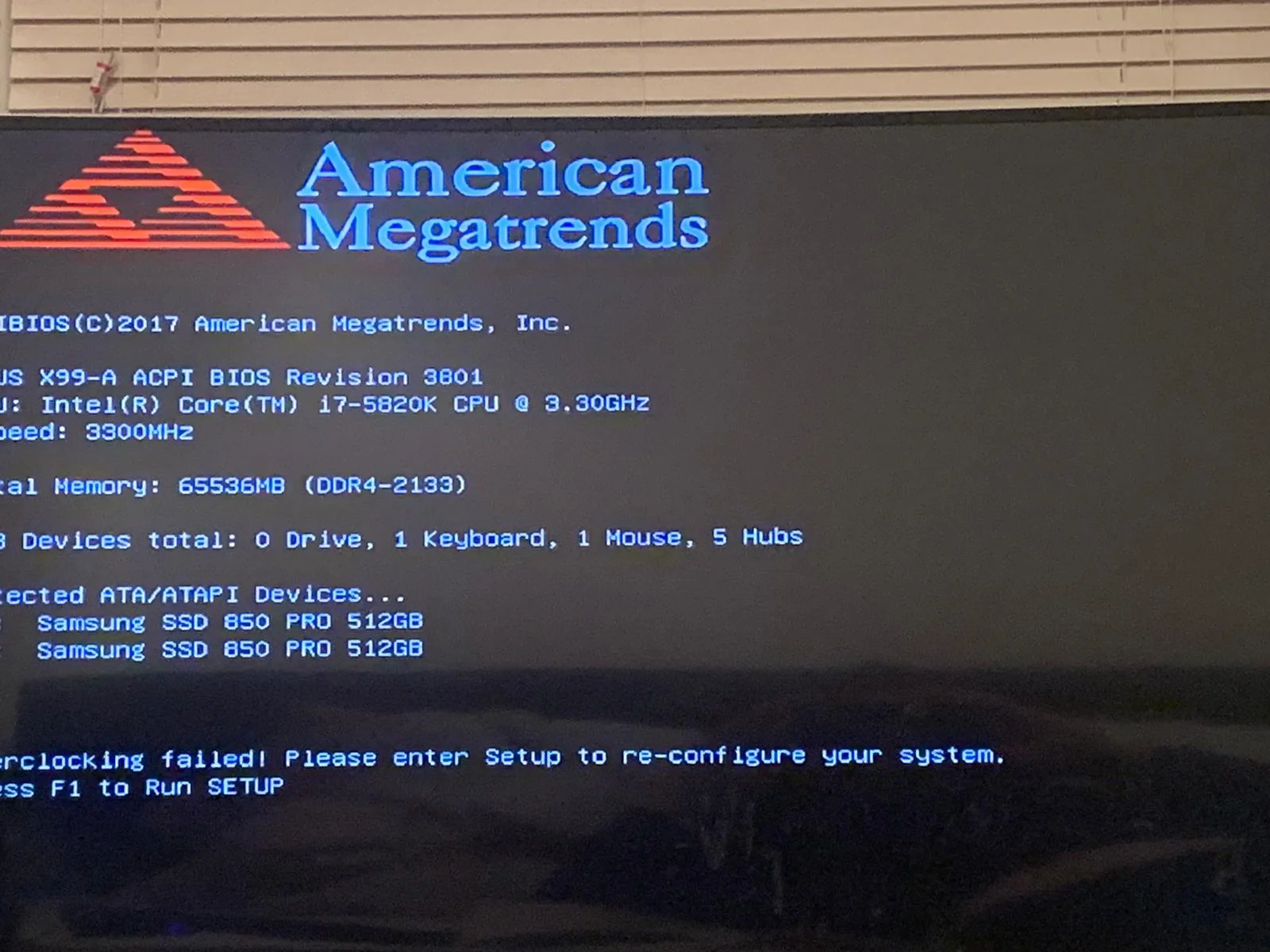

Ok, so long story short. My brother had a gaming PC built and rarely used it so donated it to me when he moved to Australia.
This was a month or two ago and I've only got round to setting it up myself yesterday and I'm facing a tonne of issues.
The issues are different a lot of the time but some to note:

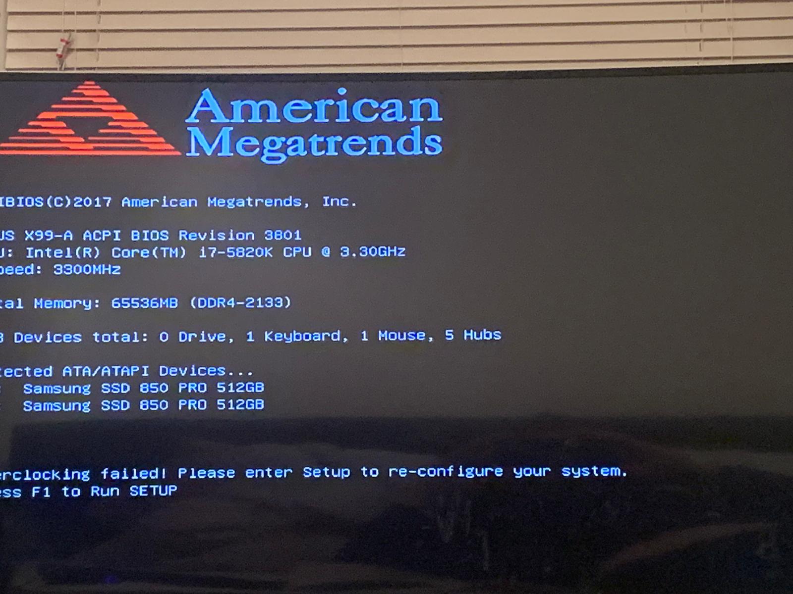

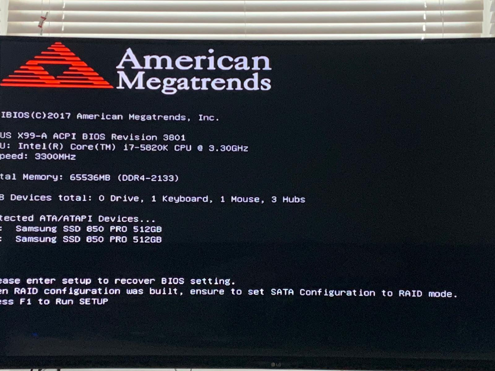

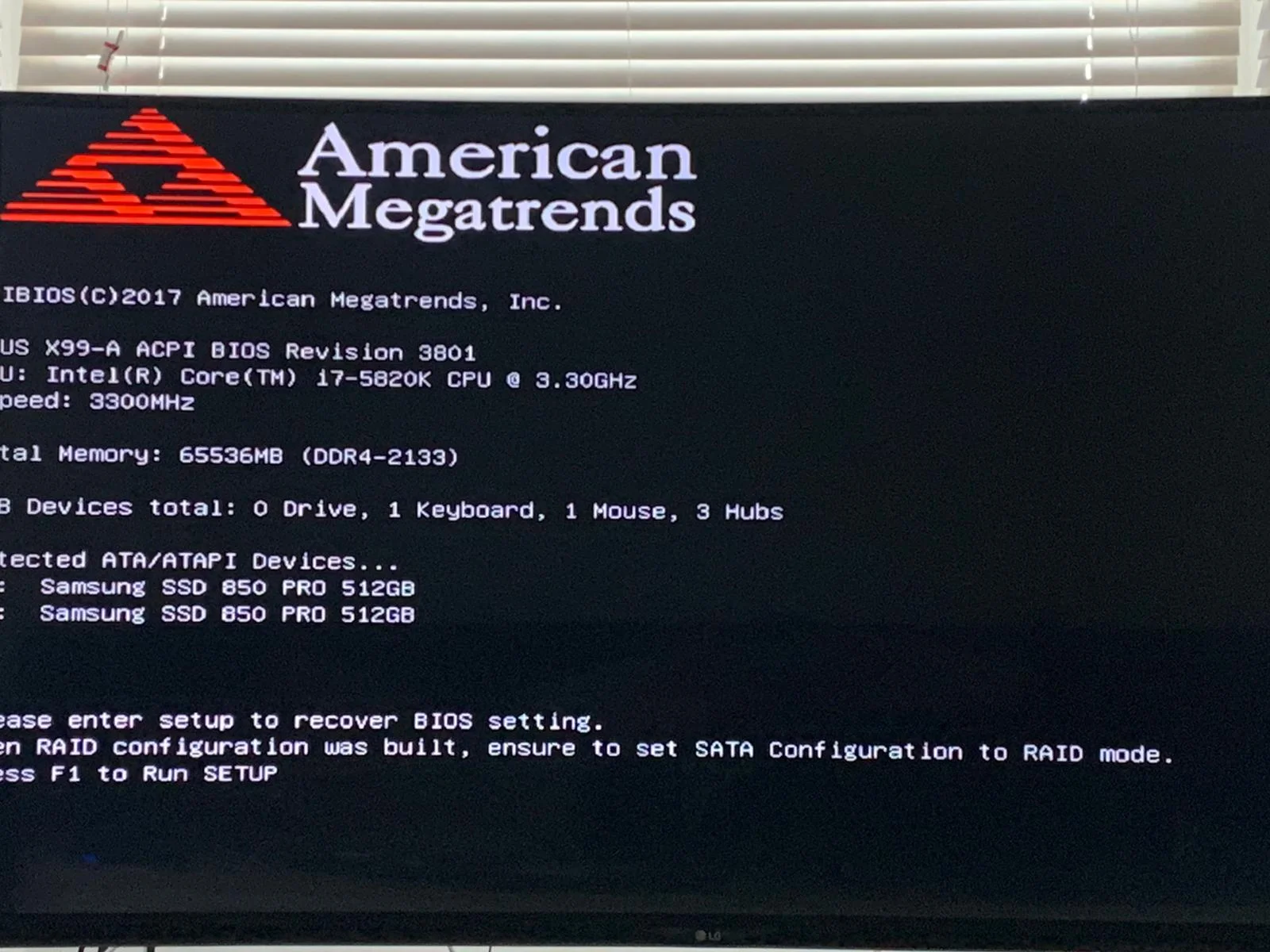

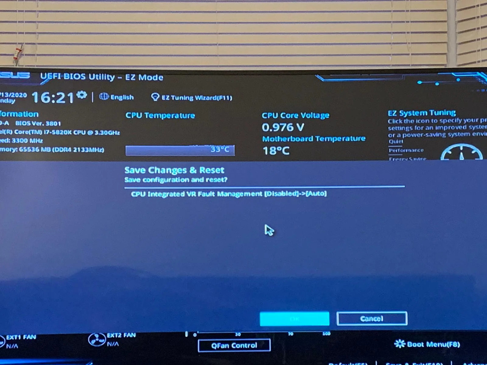

Whenever the PC is shutdown and restarted, the following behaviour(s) can happen as seen in the screenshots:

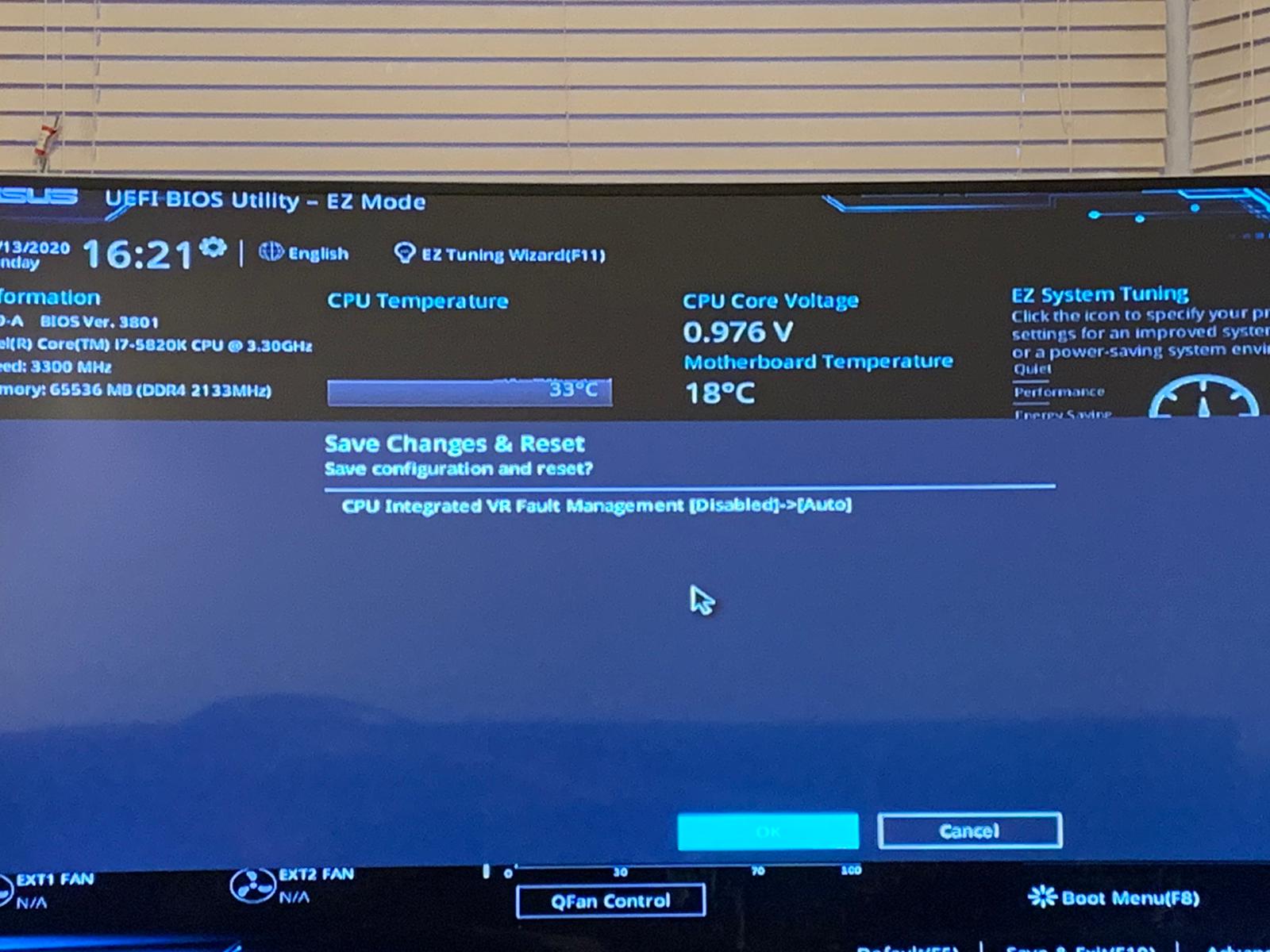

'Please enter setup to recover BIOS setting'
'Overclocking failed! Please enter setup to re-configure your system' (I don't believe it is clocked, I think that's just a mobo feature)
'Chassis intruded, system halted' (I fixed this one by replacing the CMOS battery - after replacing the CMOS, the PC wouldn't power on at all for 5-10 minutes)
The ASUS logo comes up and just spins and won't boot any further.

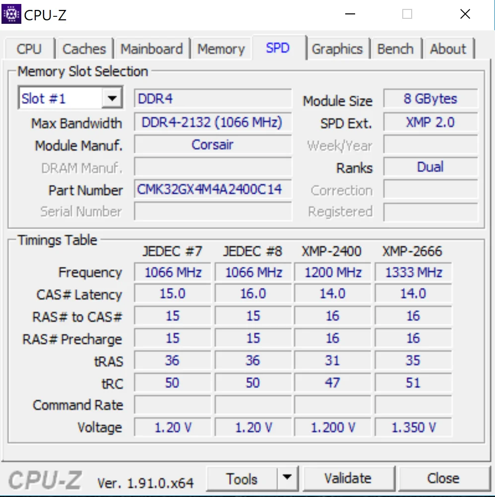

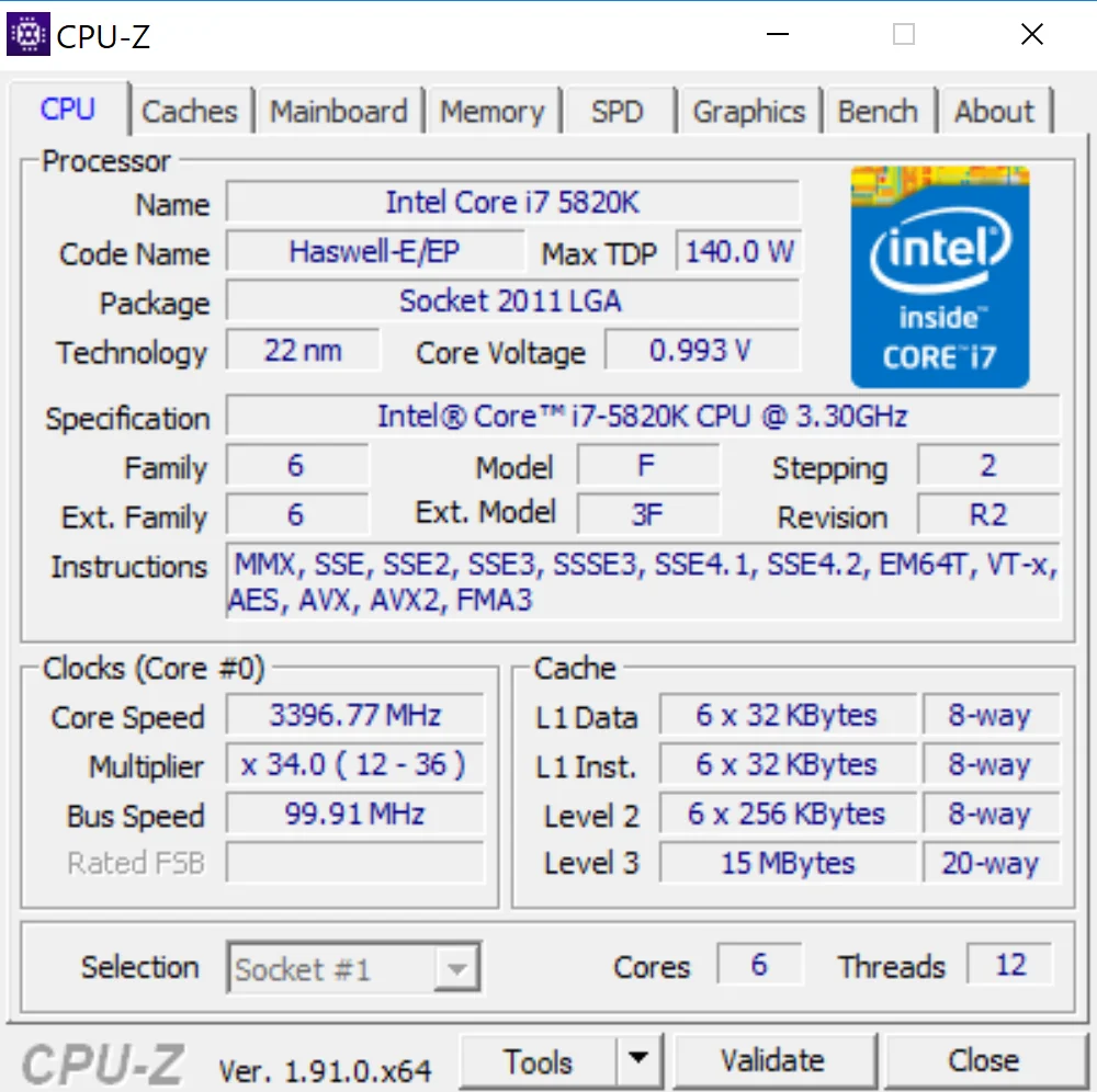

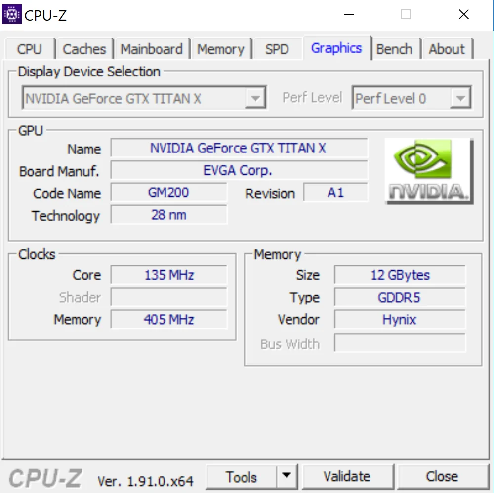

Specs:

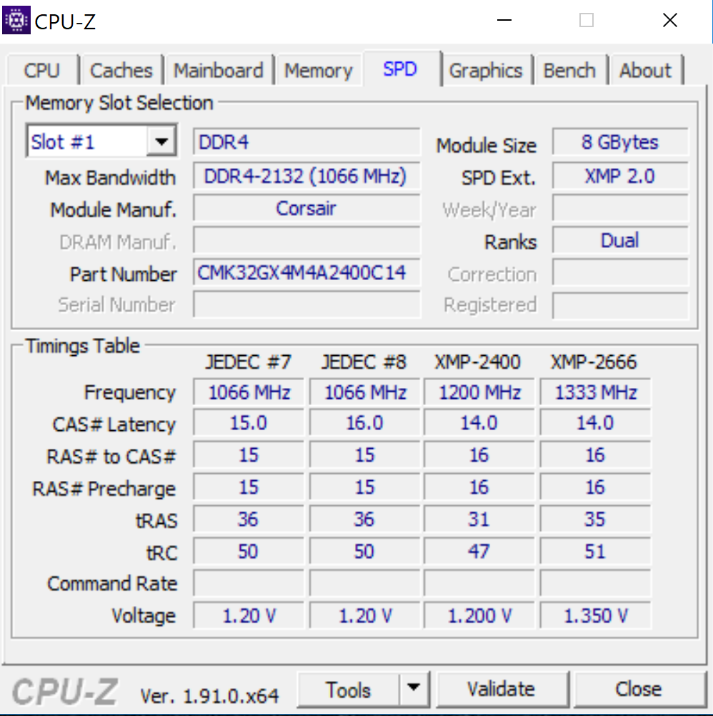

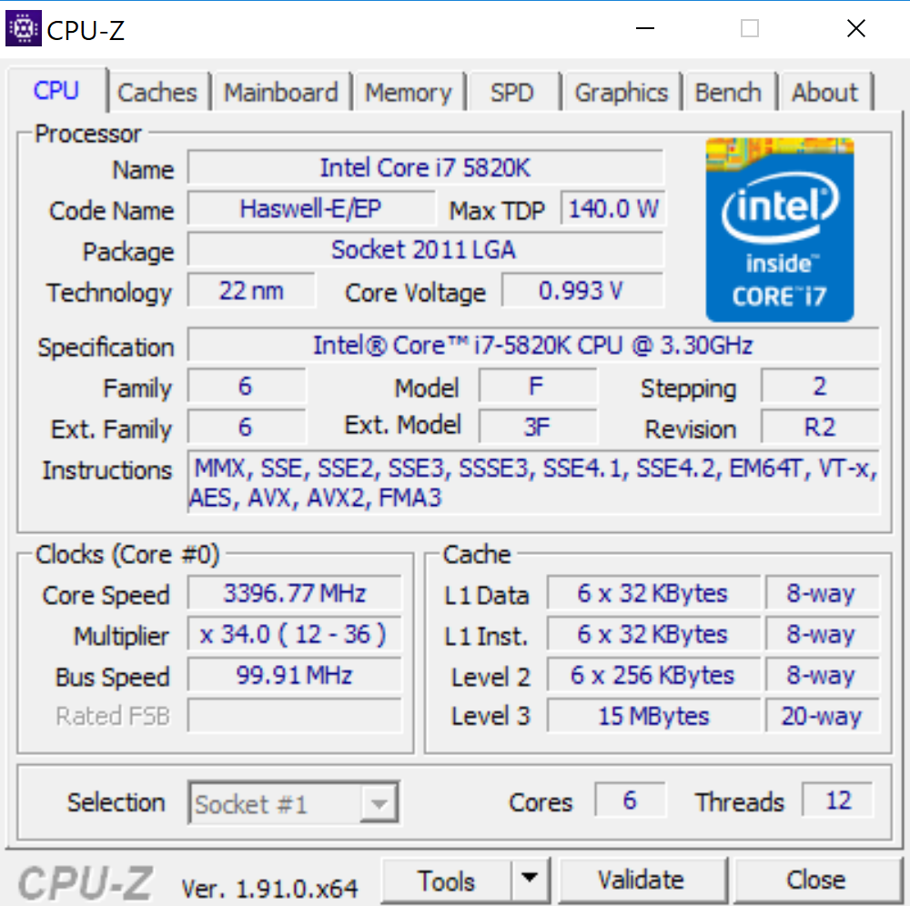

Processor: i7-5820k 6 Core CPU

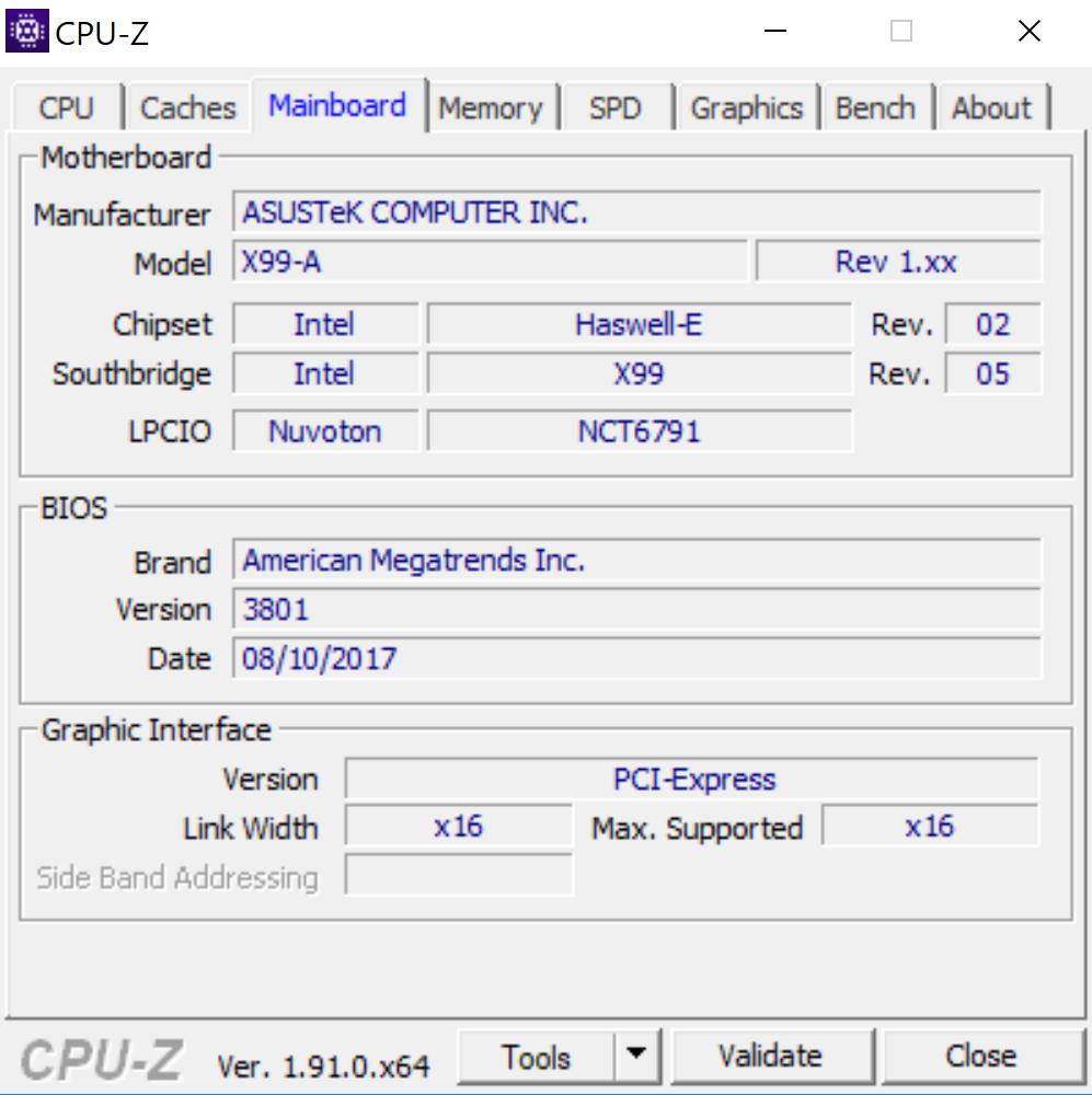

Board: ASUS X99-A

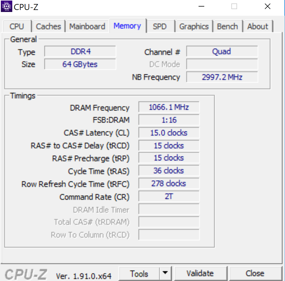

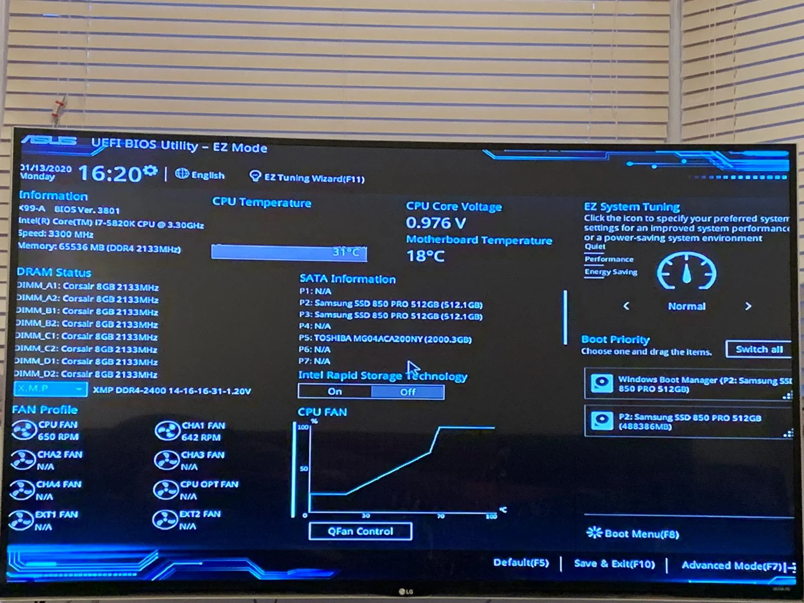

RAM: 64GB DDR4 RAM
HHD: 2TB
SSD: 2x 512GB

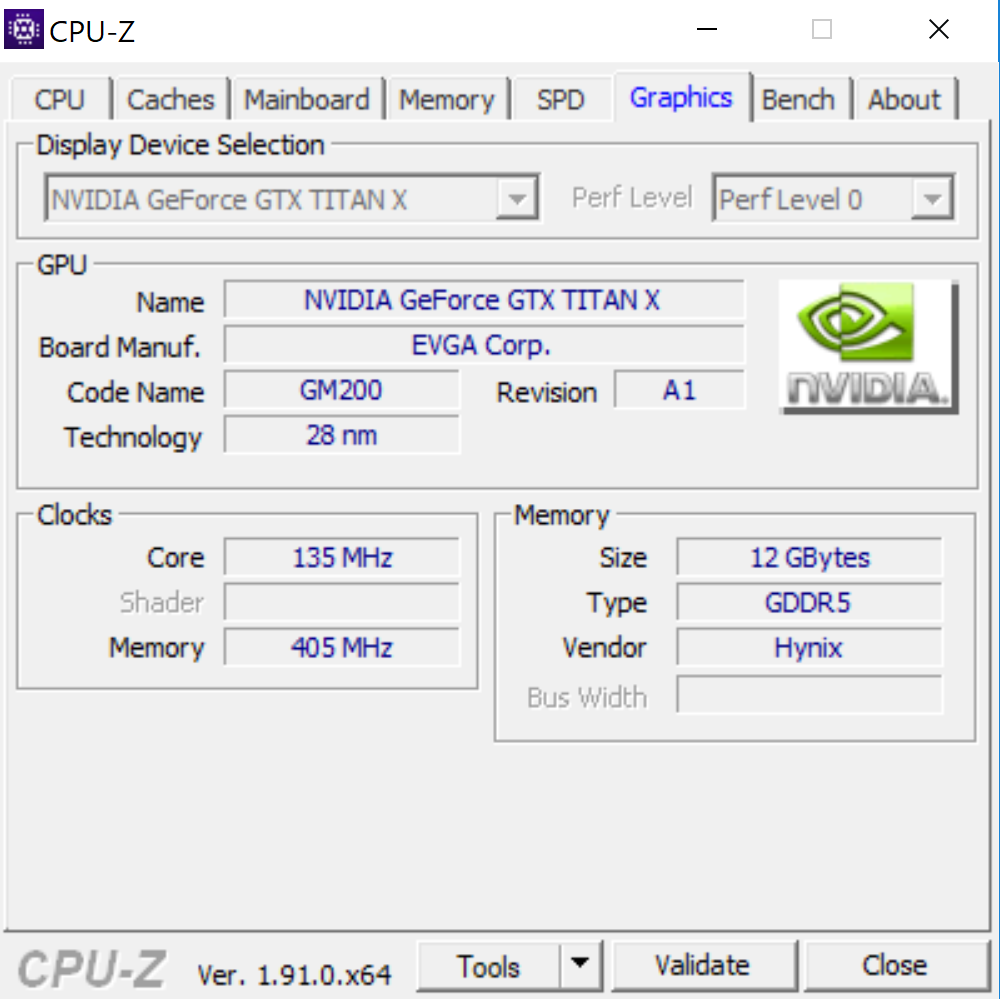

GPU: GeForce GTX Titan X 12GB DDR5

If you've removed the CMOS battery then you won't have the overclocking issue again unless you've re-applied it yourself.
Removing it will reset the BIOS (UEFI actually by the looks of your screenshots) to factory defaults.
"Case intruded" when you remove the side panel you'll see a little push button around the rim of the case. Follow this back to the motherboard and unplug it.
Have you tried sticking a windows USB in it and booting to recovery mode and repairing any miffed files/partitions on the mbr?
As above what @welshname said, the other bits should be easy to sort

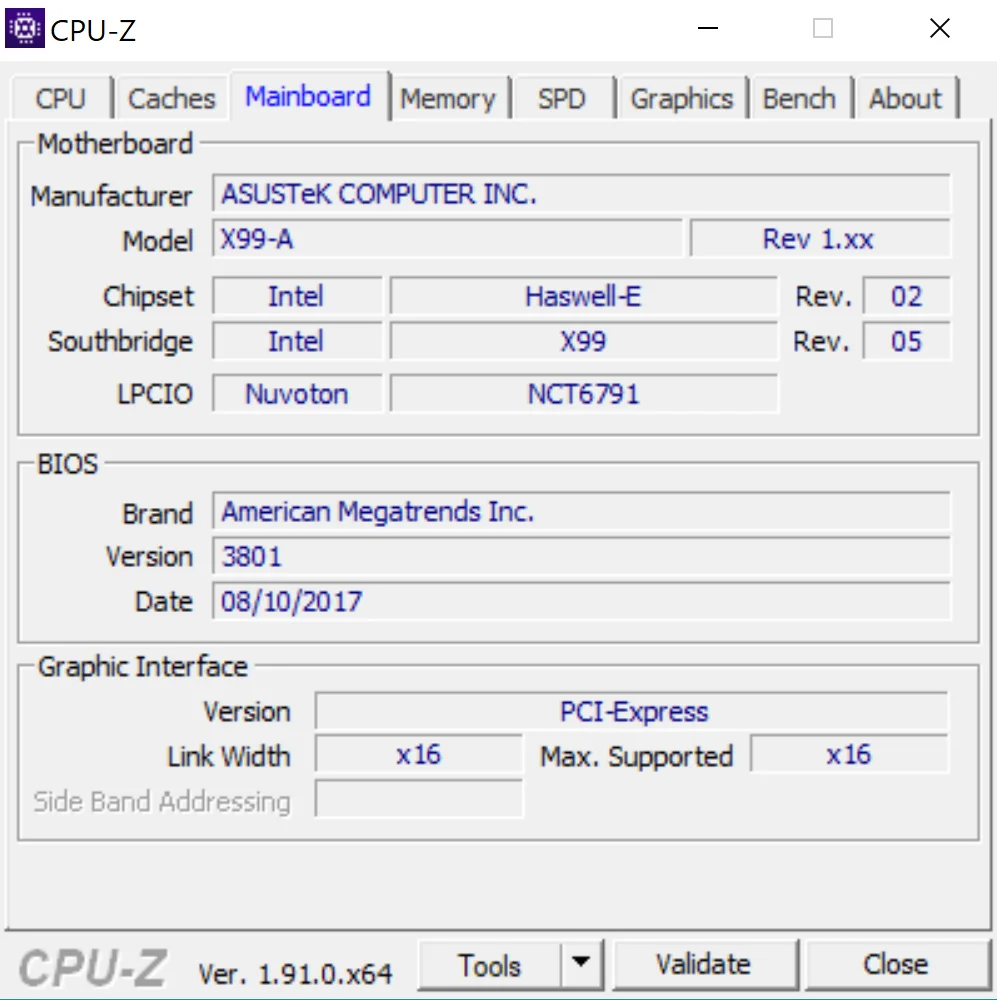

Doubt it's related to your problem but there's 2 later versions of your MB's BIOS available so I'd get them on if you're still troubleshooting.
The first thing I’d check. I never get why there’s a reluctance to updating mobo BIOSs. I’ve had one get bricked in the 28 years of PC ownership and most modern mobos have dual BIOS support anyway. Even though both updates are flagged as beta, I’d be doing that first.

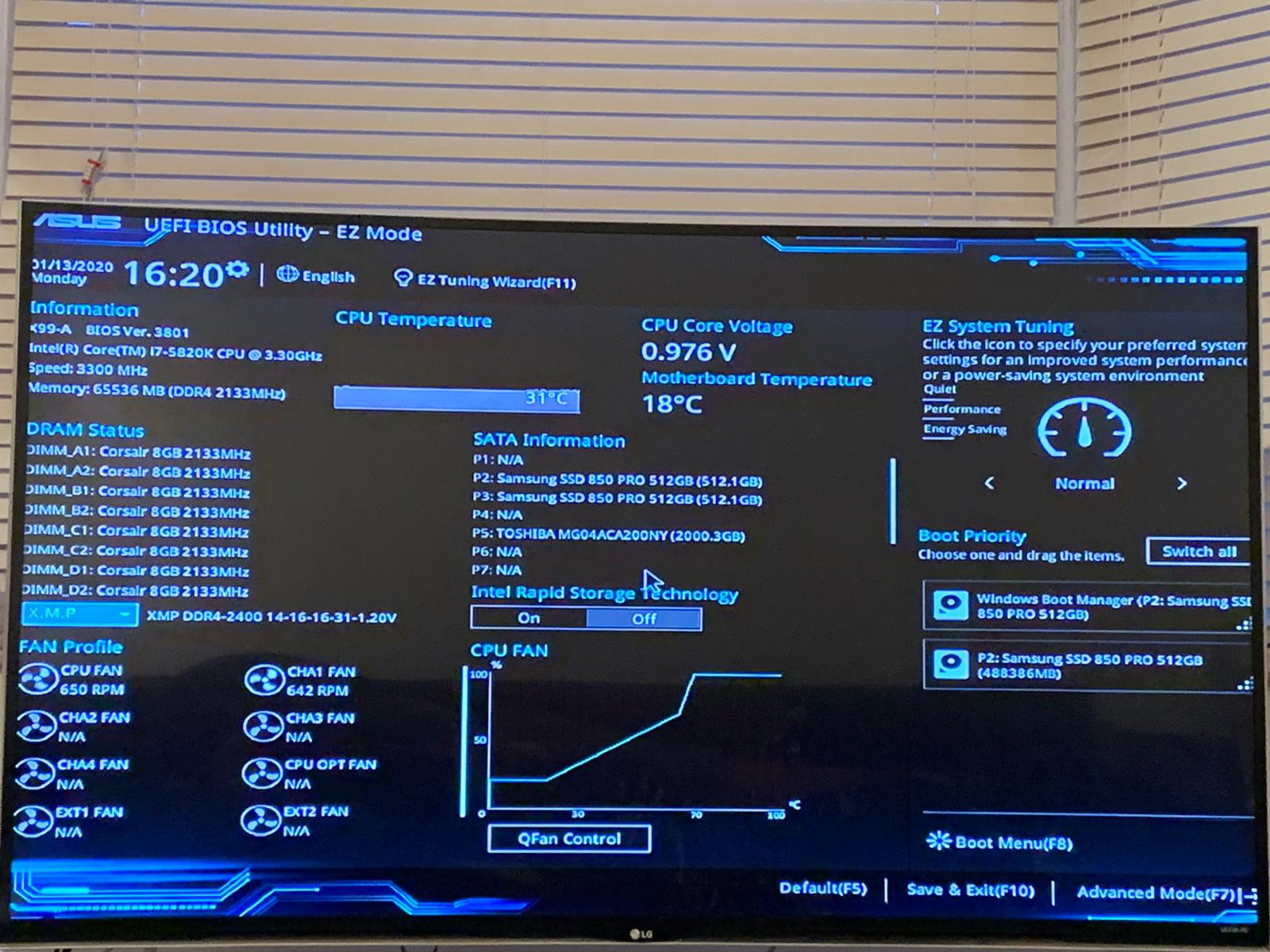

Once done - make a quick note of the obvious hardware settings, like if you have RAID setup - which personally in two SSDs, I’d disable and have as separate drives. Assuming that doesn’t trash your entire install (which it would in RAID0) reset the BIOS to factory standard. I would also question the need for 64GB for a standard PC. That’s a lot of unused memory estate to control and manage. I’d be dropping that to 32GB max for the moment.
Have you got access to the Windows credentials? If so, after all the above has been done - I’d be reformatting it. Doing all this gets you back to the cleanest slate possible from where you’d have a much better attempt at fixing recurring boot warnings or issues.
If stable on a reformat - you can then think about tweaking it. The Asus BIOS front-end on the X99s probably isn’t quite as gamer focused as the ROG alternatives but you can still get a hefty increase in performance from the Asus presets.
If it’s still misbehaving after that - it’s time to do some further checks - jumper settings on the mobo, any visible damage, reseating components, etc.

I updated the motherboard and that cleared some of the issues in the end, however, it appears that on every Winblows update it will repeat itself.
