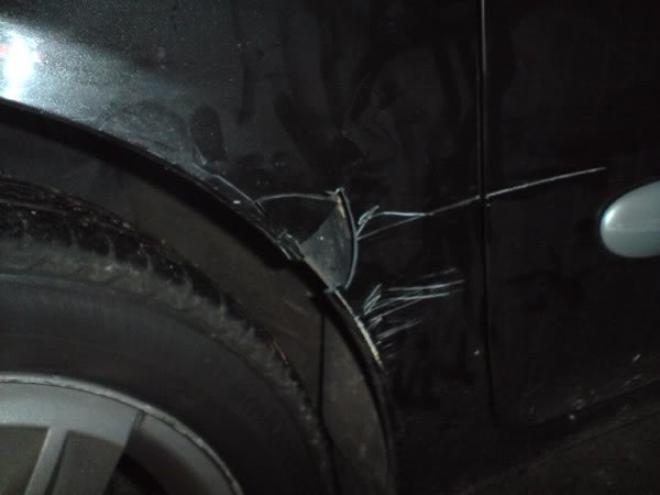

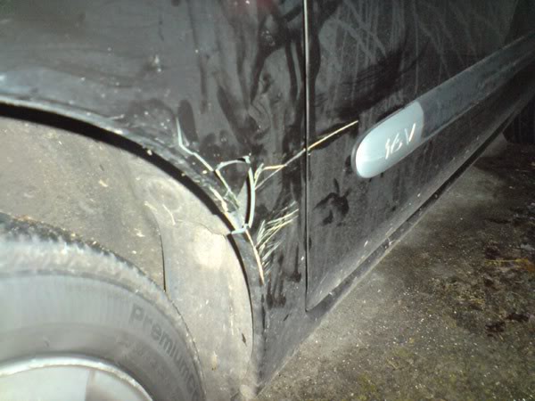

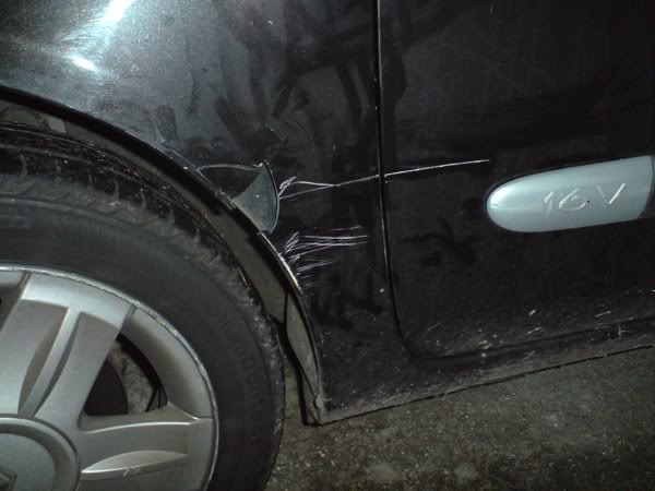

I reversed over a metal post, and its cracked and taken a chunk out of my passenger side front wing. (see pics).
I got a quote from a garage and they said £350 to get it repaired. Im just looking for cheaper solutions!

i have a spare wing which you could buy for a lot less than they've quoted, it's in 676 pearl black too :) get back to me if interested
easy job to replace a wing at home and there's only 1 colour of black in dynamiques
  www.renparts.co.uk
all the non RS clio mk2 ph2's are pearl black so matching up should be no problem, a new wing non genuine is about 40 pounds, and a good bodyshop should do it for 150 cash max imo to spray the wing and the door.
