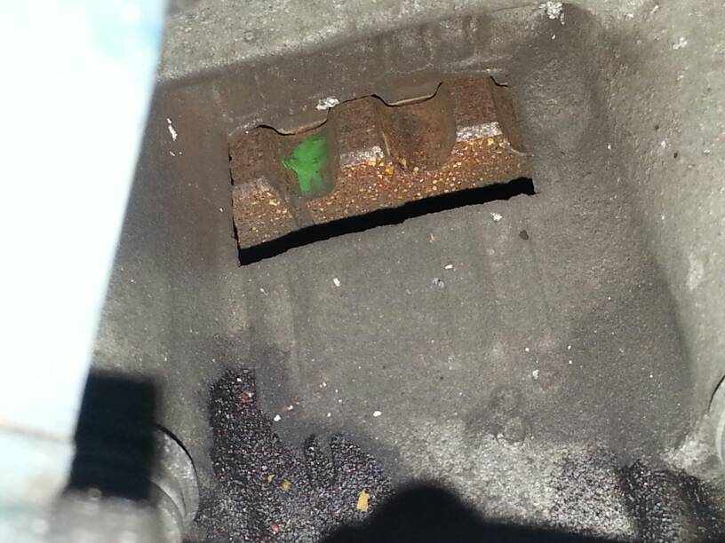

Can I just double check. The only visible mark that was on the flywheel was a bit of green paint? Is that what I was looking for? Or is it a physical slot as you say?
bit of a groove, might of had some paint thrown in it though as it can be a bit fiddly to see.

Was going to post this to ask if this green mark was the TDC mark. Then I noticed the notch in the flywheel next to the green bit!

For anyone that needs some help that's come across this post, see image!
P.s yours may not have green paint, but should have the mark, as everyone mentioned above.
be very careful as where the mark is now you're not at tdc, when you insert the pin make sure the crank won't move either way. it will need to move a 'touch' to get the pin in place.
Do you mean get that notch between the two lines of '0'?
If I rotate the engine any more, it won't be at TDC. I'm 99% it's at max travel.
Crank won't budge either way. I'll triple check tomorrow, worst case I'll just have to crank it back to this position.
