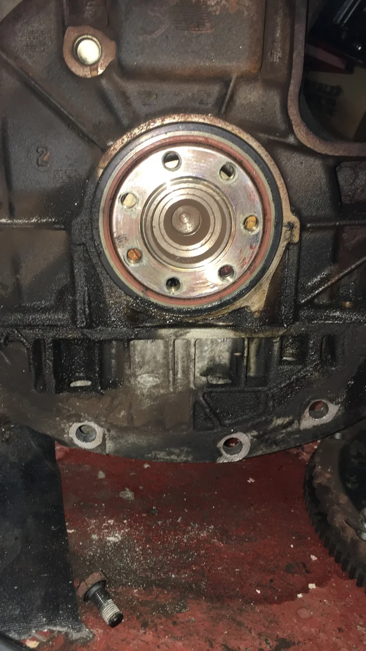

I noticed a leak on my replacement engine which I feared is the crank seal.
Sure enough, I whipped off the flywheel and was met with this mess.

very rare for a crank seal to leak and you'd be daft to not do sump gasket and reseal main cap at the same time.
Yea, I seen it mentioned on here that its rare to go so I was surprised to see the oil at the bottom of the flywheel. I'm going to get sump gasket and seal ordered tomorrow. Along with new flywheel bolts and cam seals. Hopefully I should have a dry engine after all this!
Regarding fitment of the new seal, do I aim to leave the new seal sitting slightly proud as per the seal fitted currently?
seal is it is now.
and while you've got the sump off chuck a set of arp rod bolts on, clean the oil pick up out and modify the oil pressure relief valve.
What is the best sealer for the main bearing cap? I was in buying the seal amongst many other things today from my local dealer and they reckon the Renault sealant will do this. I’ve seen it mentioned on here that the Renault sealant is no good. What do you guys think?
