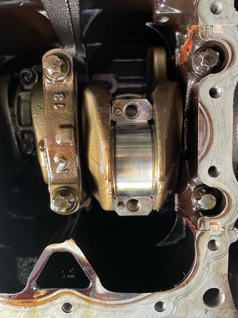

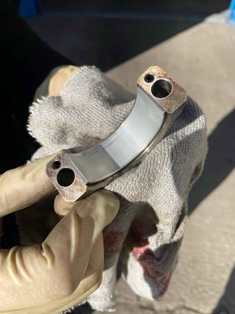

Yesterday we did a check to the connecting rod bearings and the crankshaft, everything fine.

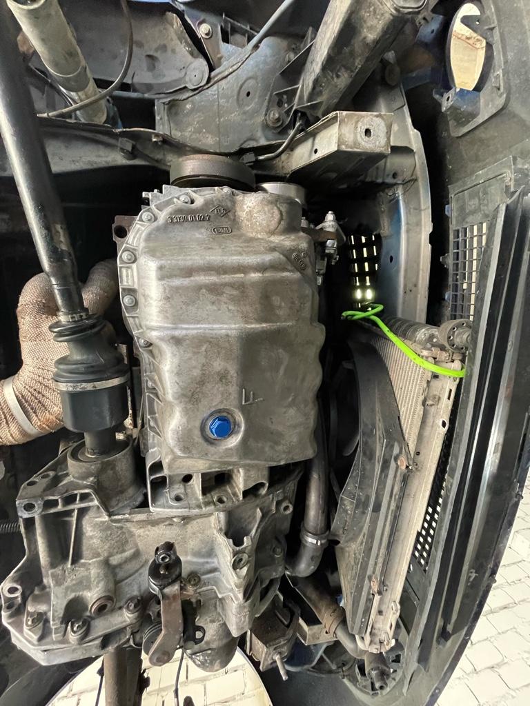

After i gave the crankcase a good clean, fit a new (original) gasket and new screws (original ) and when i were out to test drive we find out a massive leak from the crankcase by the gearbox side.

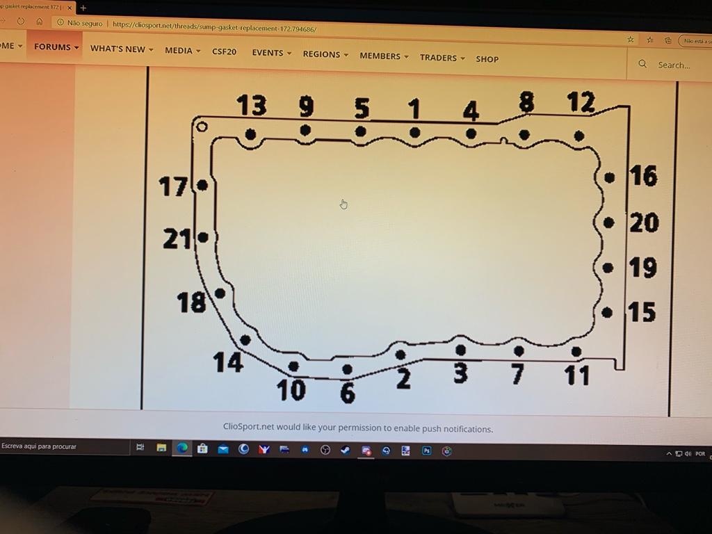

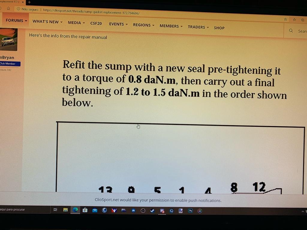

I follow the tighten torques and segment too.
Anyone have some tips or explanation for what went wrong?

After fitting the new sealant we find out a crack near by the sump bolts.
I think i need to first tighten the 16mm bolts that connects the sump to the gearbox and then the 22bolts from the sump.
