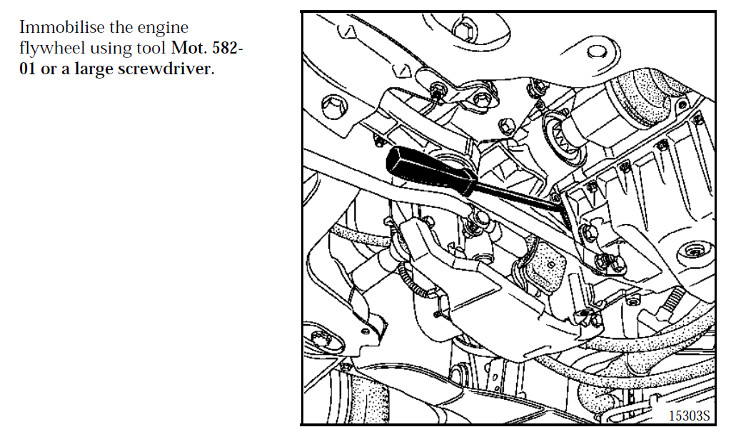

Thanks James...........that is one thing that is on my mind as I was expecting to use the crank locking pin but worry that it isn't up to those torque values.
Don't use the locking pin to hold it while torquing! You'll snap it off, then you're fucked.
Big flat head screwdriver through the back of the gearbox bellhousing, use that.
I hear you James....had a look the other day and thought I could use a crow bar to hold the crank through the timing hole (where the crank sensor lives)
I assume you are thinking of somewhere else? I was hoping to not have to pull the starter (trying to keep the job as light as possible as not well)
J
Ahh, sorry........being thick
Well......who'da thunk it.
I just found the MOT 582-01 (BGS version) crank locking tool that I bought when I bought the Renault timing tools (genuine) as I thought I might need it............totally forgot.
