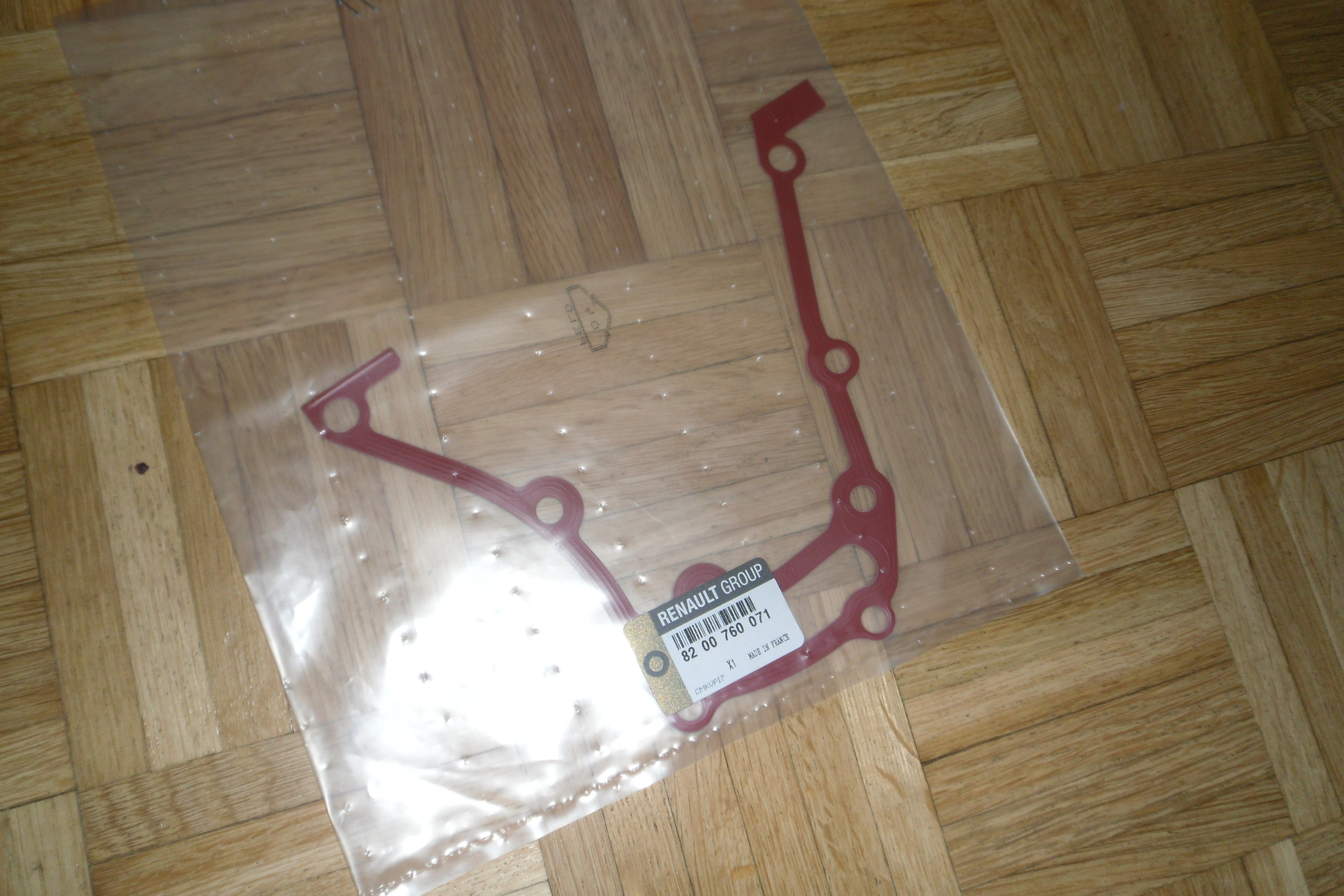

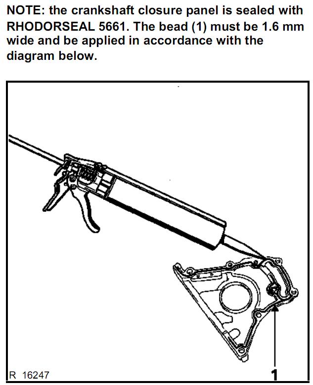

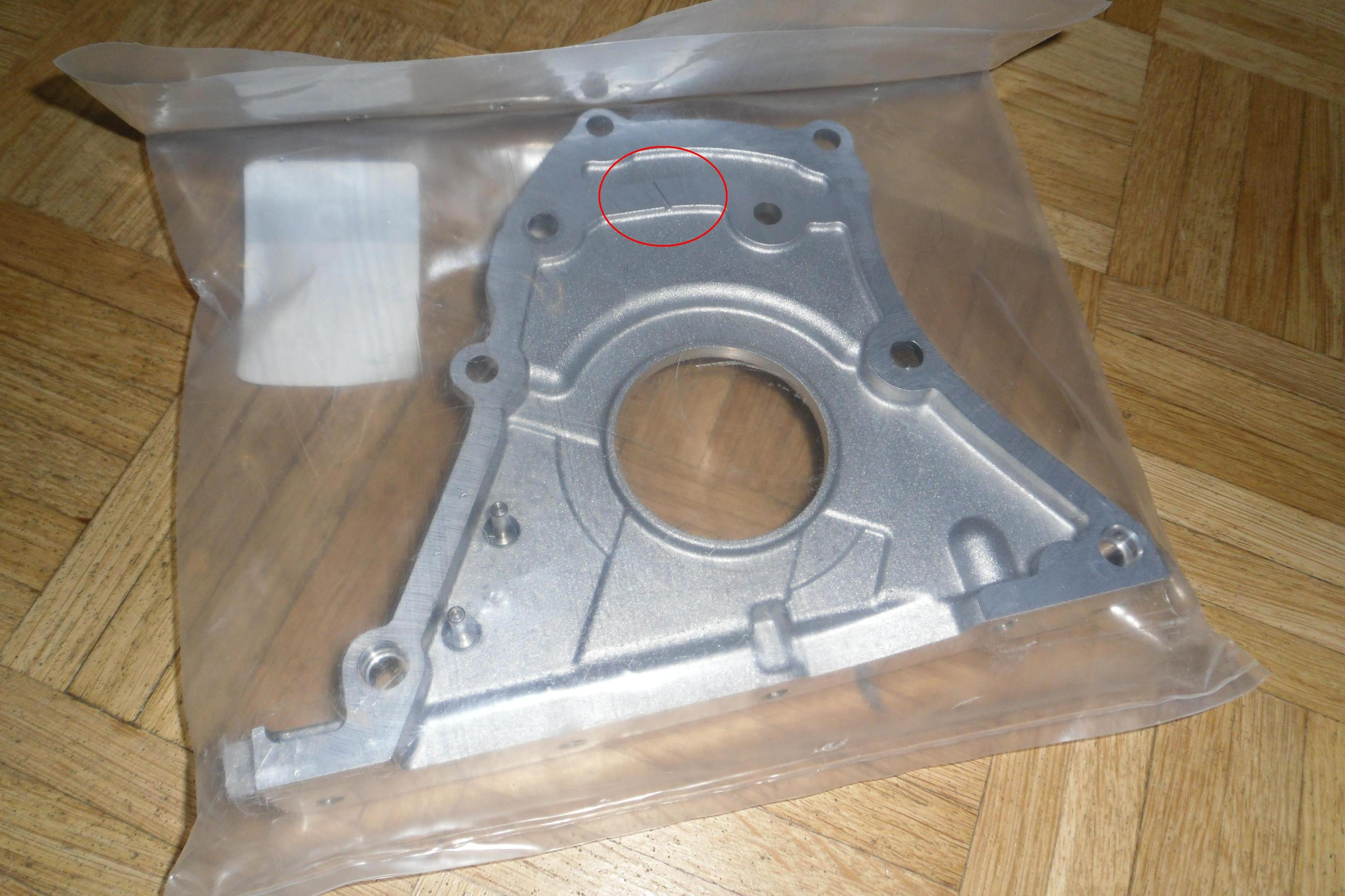

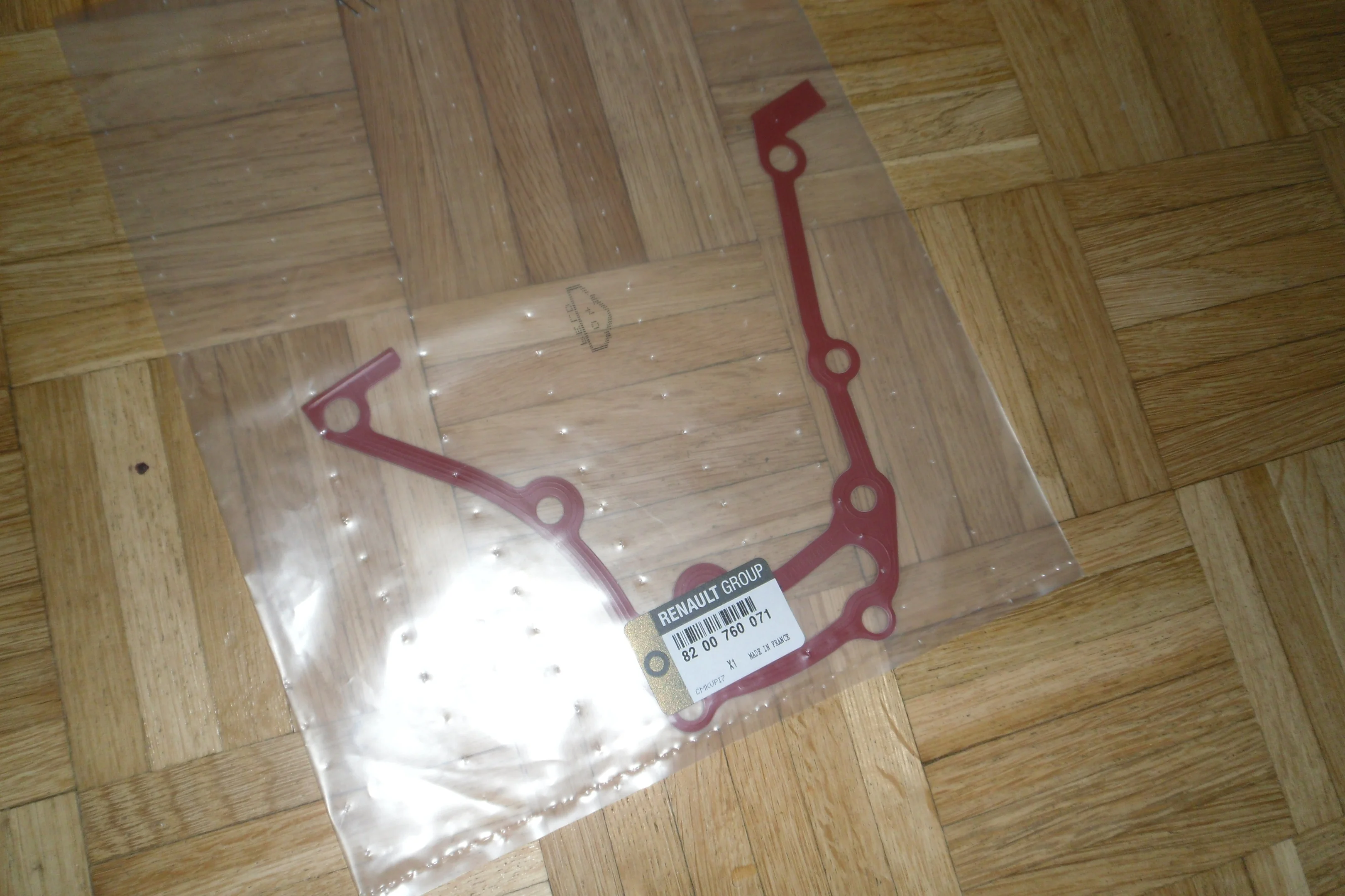

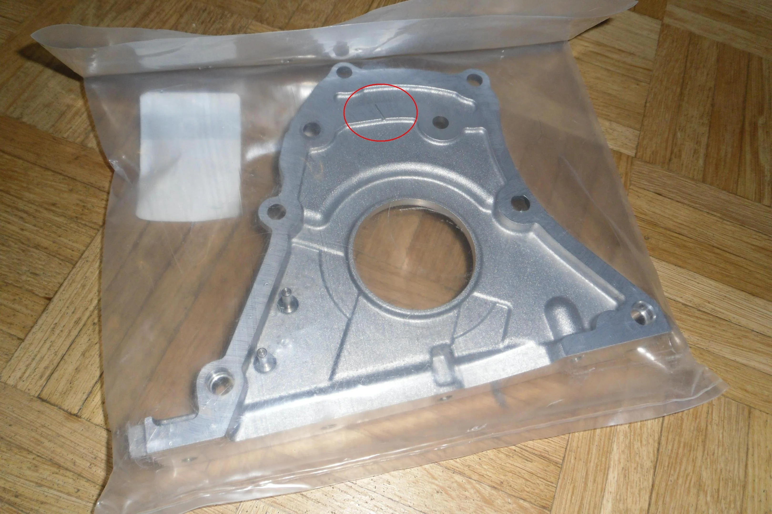

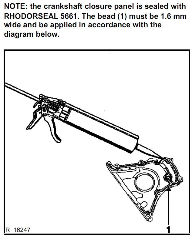

Hi, i have one, maybe easy question. I'm trying to build second engine (f4r) but have some problem.
In workshop say to use RHODORSEAL 5661 for closure panel but i find gasket which looks the same as holes in it.
What i should use (gasket or rhodorseal), important for me is grove in closure panel, that grove is for lubricate oli pump chain?

On early F4R engines Renault used RHODORSEAL, on later generations they introduced the gasket for simplicity.
Use the gasket :)
