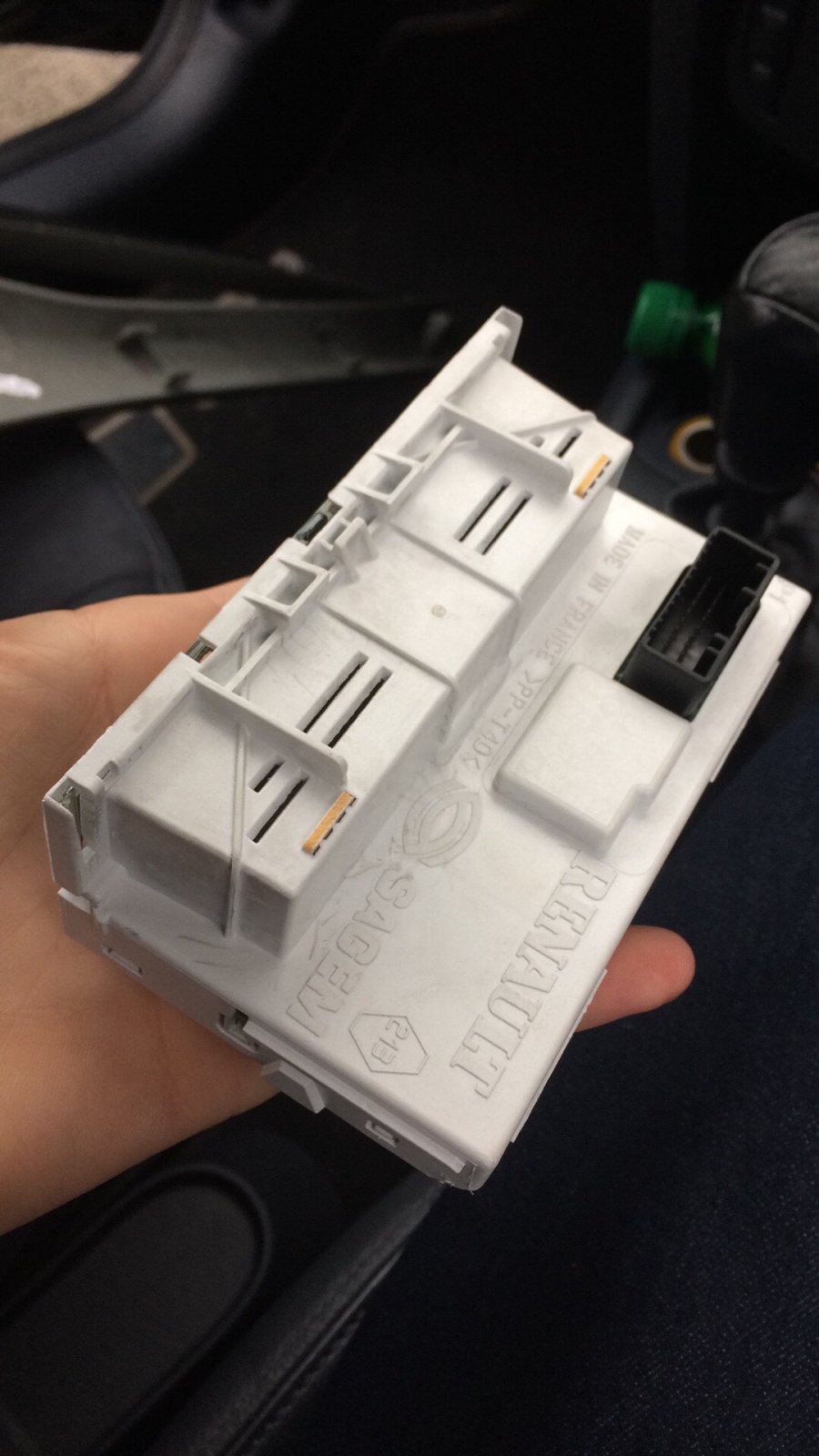

I went to change the clock bulbs in my 182 today but they appear to be different to what's supplied and what I found on the next. There doesn't appear to be 2 bulbs in the back of it?
Anyone else had this and able to advise?

The later style MFD's (Clock unit) have an LED board instead of the twistlock bulbs
I would look out for an old style clock unit. (@cs_dave will have half a dozen) or get your soldiering iron out and solider in some LED's
Thank you. Are the old ones a straight swap or is the connector/ loom different?
