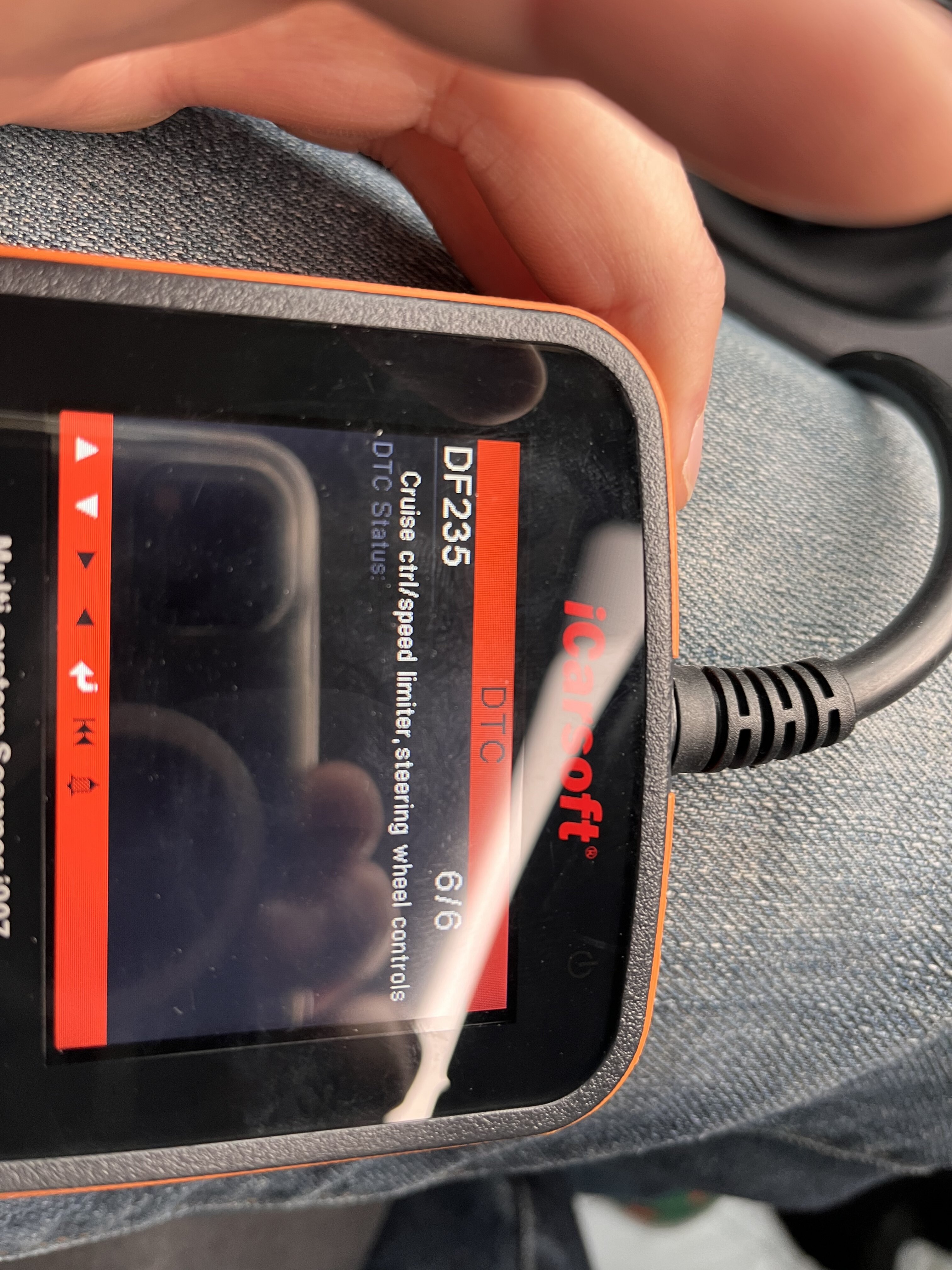

Okay, so my French car is doing French car things.
now the engine runs sweetly the cruise control buttons have decided to move themselves about.
in essence the - button now sets the speed and adds mph, the + button cancels, the R button removes mph and the o button resumes.
any ideas? I have the error code df235 which is a cruise control error, I think it could be the actual buttons or the squib but has anyone come across this before?
SharpyClio
It’s not the brake sensor one, had a search and that shows as a df135. I’ve also adjusted the brake sensor as per the guide and it’s made no difference.

SharpyClio
Fixed them! I swapped out the switches for some i had on another wheel and they are all fixed and working as they should. Cheap fix in the end. So the moral is that if you get the above code alone start with the switches.
