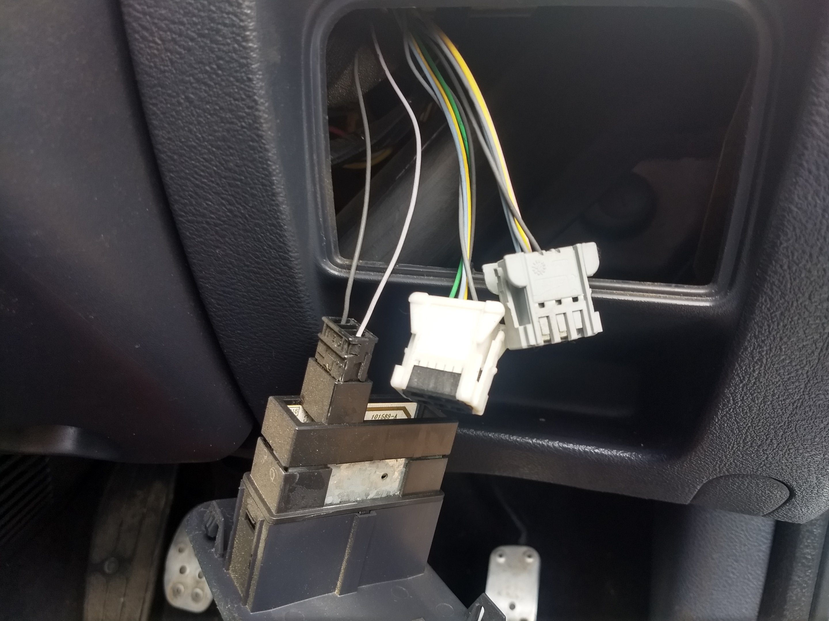

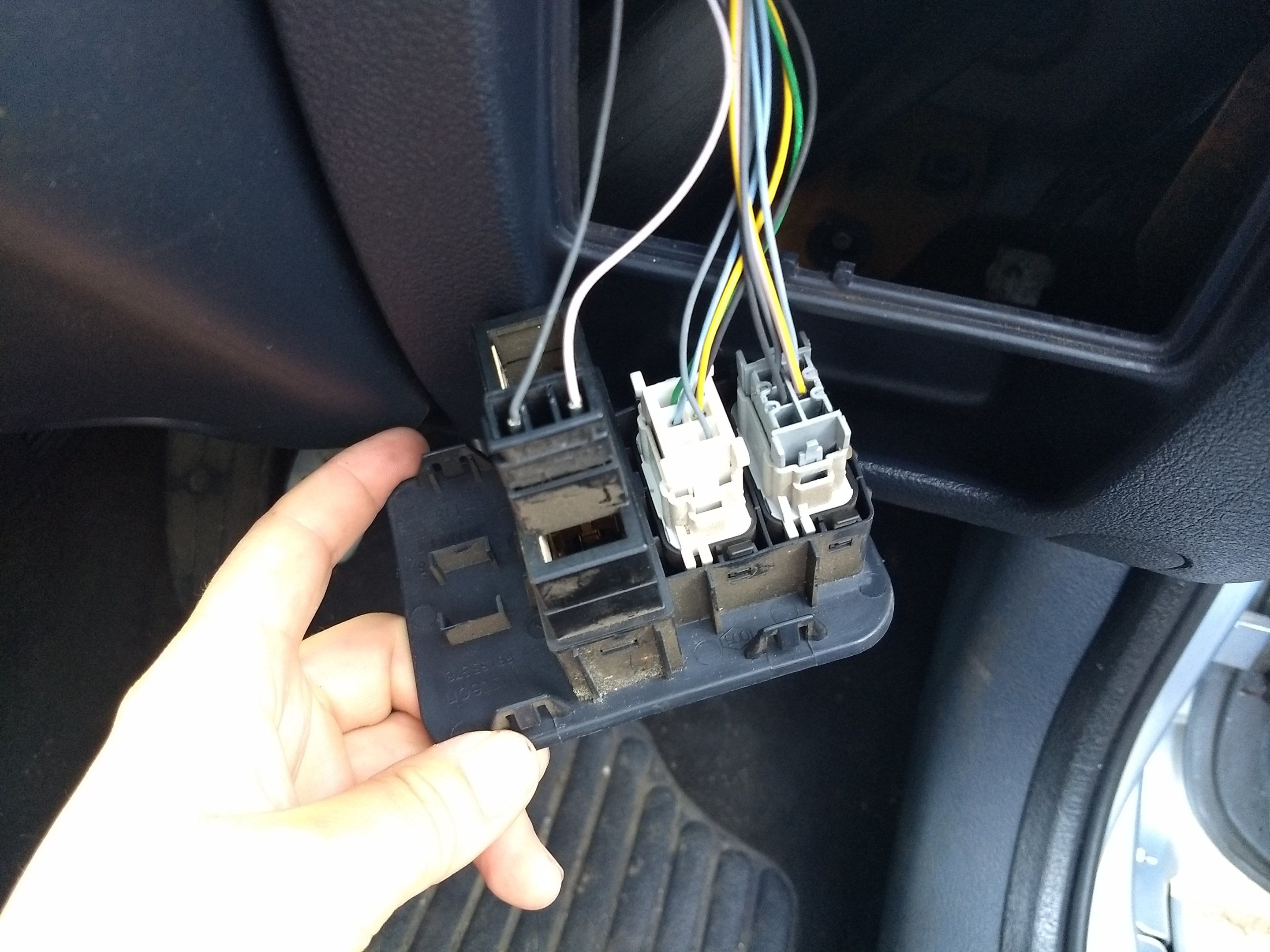

I pulled out the dash panel and there are two unused plugs behind it, in addition to the adjuster wheel connections:
Can anyone confirm what these are for? Cruise control and ESP?

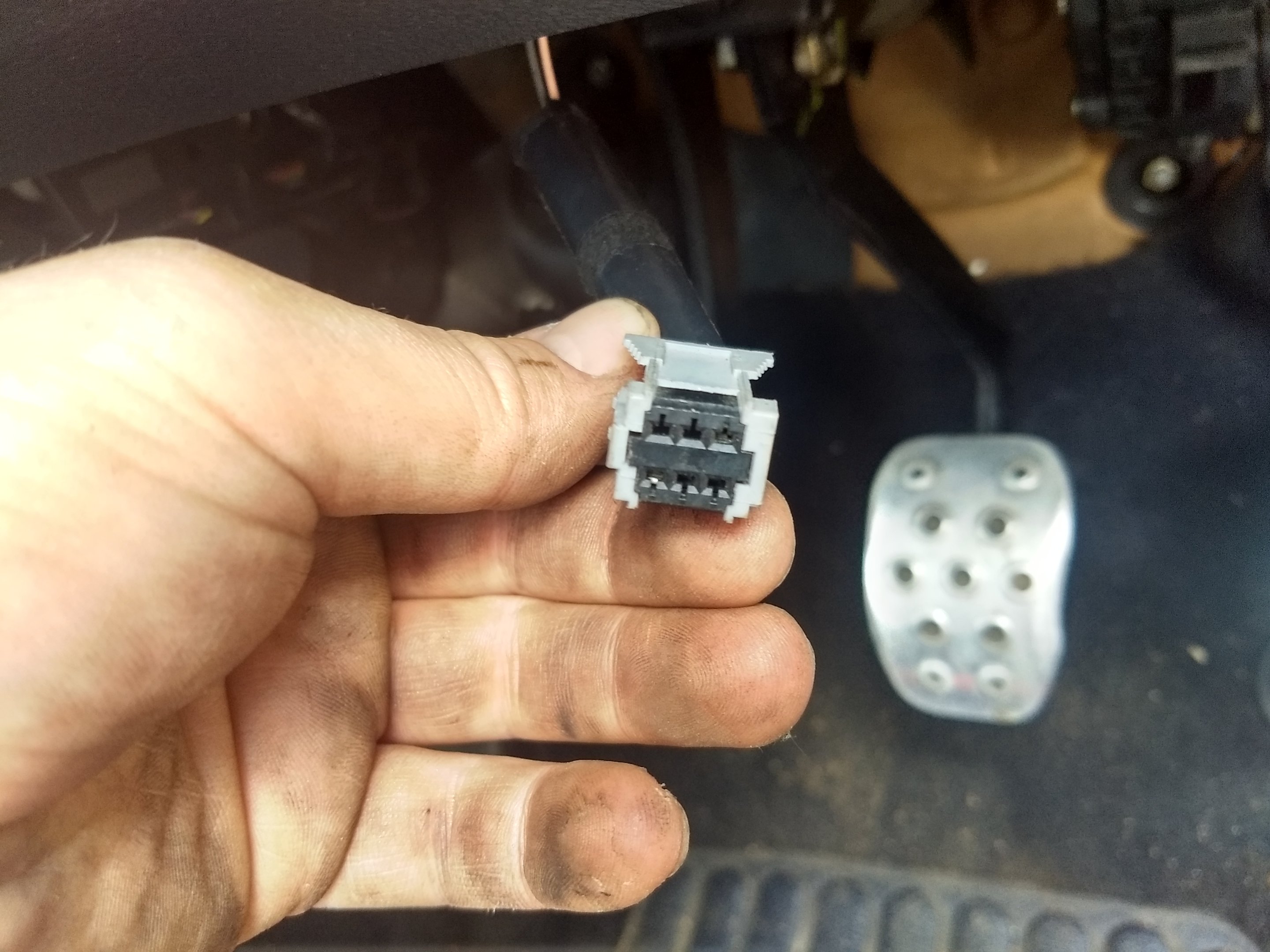

And then under the dash I have this, attached to the same loom as the brake switch and accelerator pedal. Is this for the clutch switch?

If your switch is plugged in and you haven't got the lights there are four things potentially going on, fuse, missing wiring in the engine side of the loom, clocks not set up for cruise or ECU not set up for cruise. Verify them in the order I've listed! To get the cruise light up all you need it 12v going down the cruise control "control" wire to the ECU.
@GrahamS thanks for that. Which fuse am I looking for? What wiring am I looking to confirm (ECU pin number)? I assume both clocks and ECU can be sorted with clip? (I have it but wouldn't know where to start).
@GrahamS , could you please tell me which one is the cruise control "control" wire and to what cable that has 12v on it would be recommended to be 'attached ' to ? Thank you
