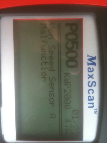

Latest update i have the engine light on.... So i used fault scanner tool.
Got: P0500 Veh Speed Sensor 'A' fault
Any ideas???

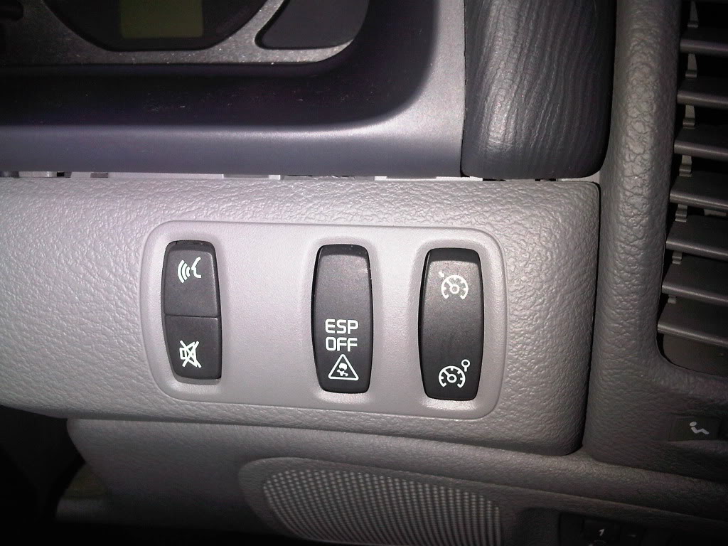

He means Cruise Control...its down the right hand side of the dashboard (where the headlight adjusters are on a normal 1.2 or Cup)
similar to this pic (obviously this isn't a Clio II)...its the button on the right.
If you try to select Cruise Control (top one on switch) and it doesn't click, then the adjuster behind is the problem.
I thought thats what he meant, thanks.
