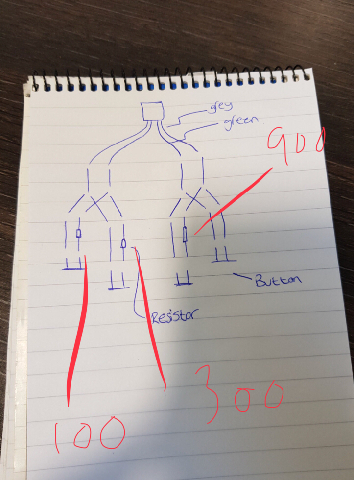

Are you replacing the stock steering wheel cruise buttons for an aftermarket wheel? You may know already......but I've read you need:
Cruise off: 0 ohms
Resume: 900 - 910 ohms
+ speed: 274 - 300 ohms
- speed: 100 ohms
So you could get a 300ohm if you wanted to be safe :up:

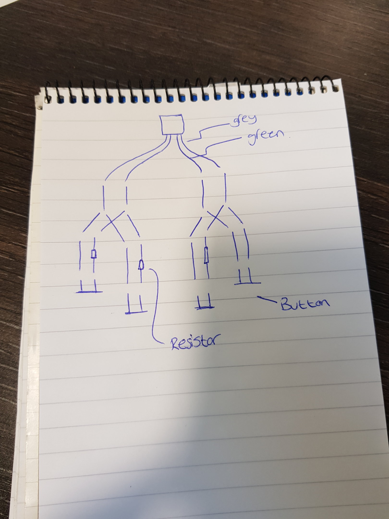

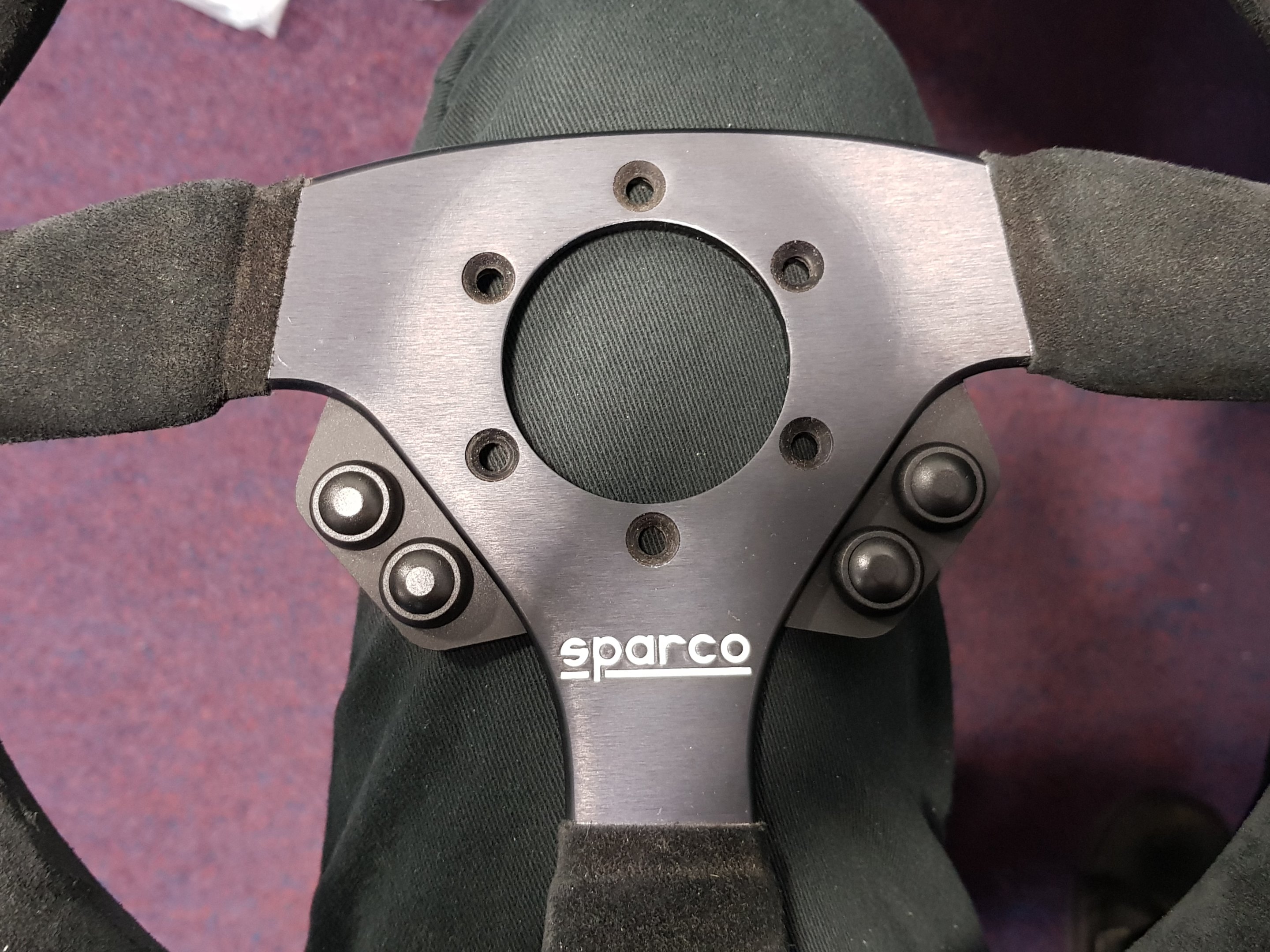

Sorry, yeah it's to replace the buttons of the cruise on an aftermarket steering wheel. I just looked at the resistors and they have a brown tolerance band meaning they're 1% so the 270 one I have won't be good enough? I can go back over and get one higher if it is 274-300 but I've not read that myself before.
I could always just join 2 resistors together to get the correct total but that would be a bit messy

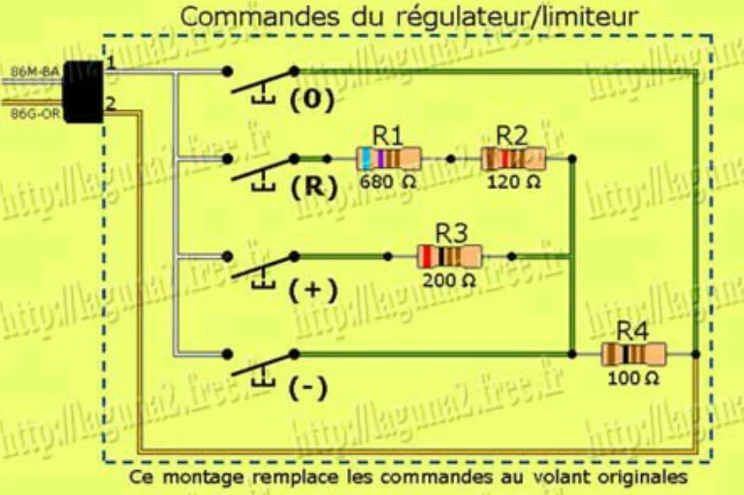

I found this wiring diagram for the buttons....
So for example, ‘resume’ resistance will be 680+120+100=900ohms

I meant the fact it's not listed in that diagram haha
Oh 🙈:smile:! The original steering wheel cruise control switches have a 274ohm resistor. I suggested the 300ohm in case you were worried that your 270 wouldn't be fit for purpose. But you solved it anyhow!
Did you make the button setup yourself? It's nice...:cool:

That diagram doesn't match the one posted earlier.
For example, the resume button, when pressed, the grey and green should "see" the 680+120+100 ohm resistors in series
Hmmmm, I assumed @Louis was using a single appropriate resistor based on his diagram, for example a straight 900 ohm resistor for the resume button....?
Hmmm yeah should work then if he has. Makes you wonder why Renault didn't do it that way?

I think they did? I thought each of the original cruise buttons has one of those resistances integrated :up:.

Yeah, so I'm using resistors 100ohm, 274ohm (2 in series to make 274) and 910ohm.
I checked them all before wiring up but will try again. Do I not need to introduce a voltage to the system to read a resistance when the button is pressed?
And not one button works. I'm right in thinking even without being at minimum cruise speed I'd be able to select 'o' and turn off the cruise light? It's an odd one

My observation is speculative, but I suspect Renault have used the circult depicted in the yellow diagram above because it is a better check of the system than individual resistors via each button gives you.
With the Renault circuit, you know that the 100 ohm resistor is present when (R), (+) or (-) is operated. If you have operated the (R) or (+) buttons, the servicability of the wiring and the (-) button from the 100 ohm resistor to the common side of the buttons is still unknown, but it is a smaller set of elements that can fail, leaving you without a safety-related reduction of speed.
With simple individual resistors, you cannot tell if if the (-) circuit works until you operate that button. In a manufacturing fault analysis process, the individual resistor option is les desirable, given the consequences for a ton-plus consumer product.
