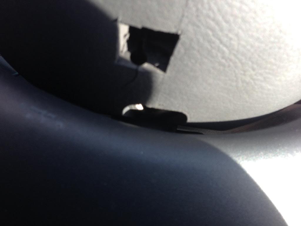

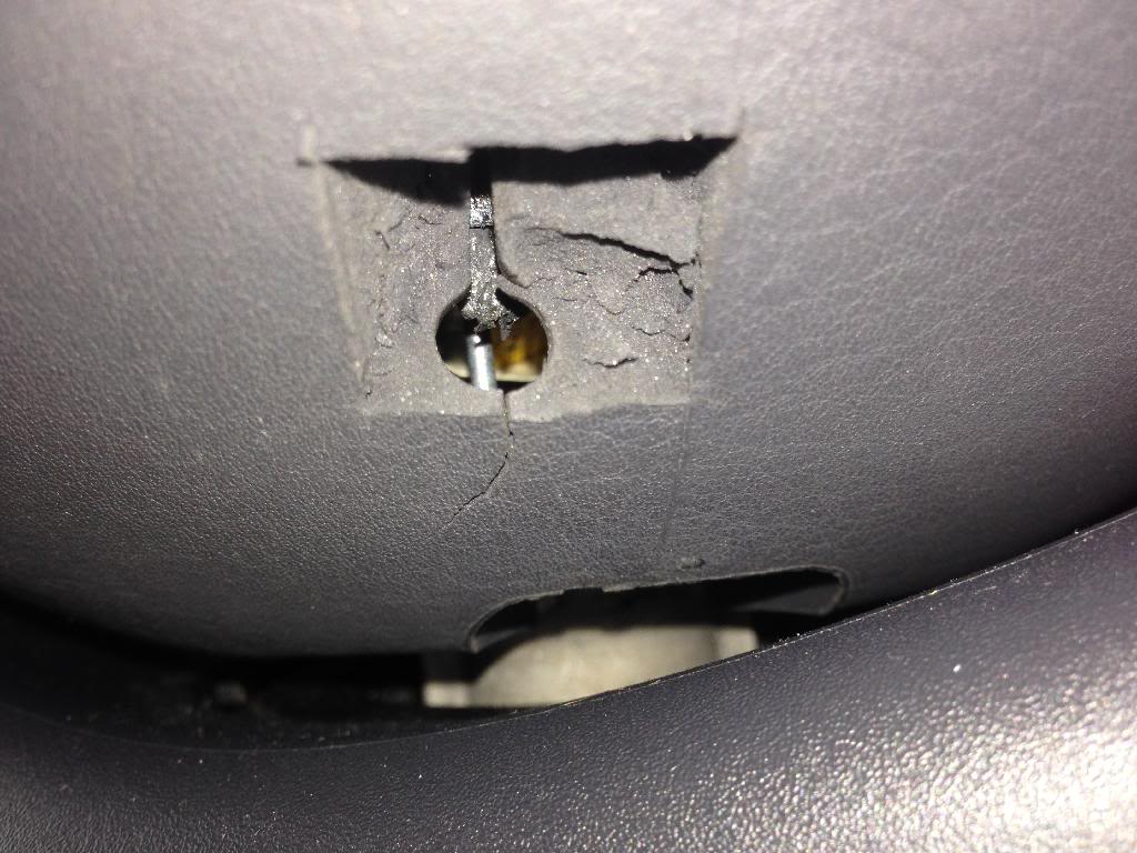

ive looked behind the steering wheel but theres no plastic clips for me to push? Theres a hole in the back of the steering what looks like some 1 has ripped into or cut a chunk out?

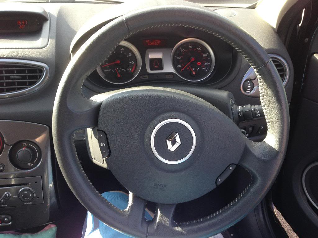

Nope neither work and nothing happens when u press r. Here the back and front of wheel.

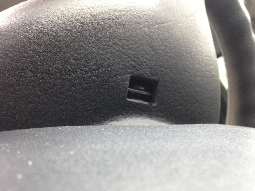

In the back of this steering wheel you should be able to see where the airbag clips into the steering wheel.

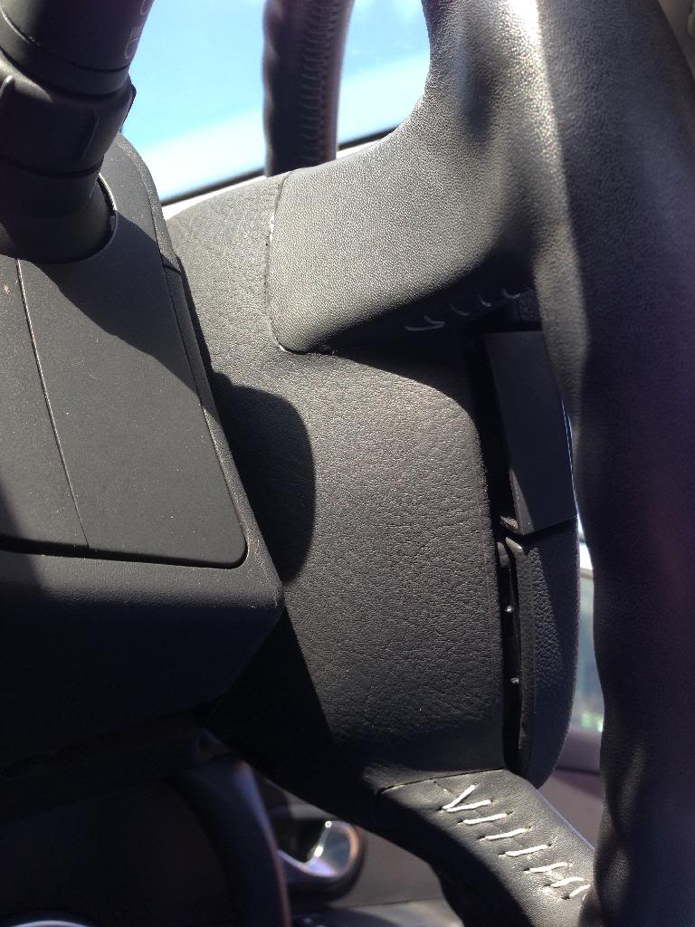

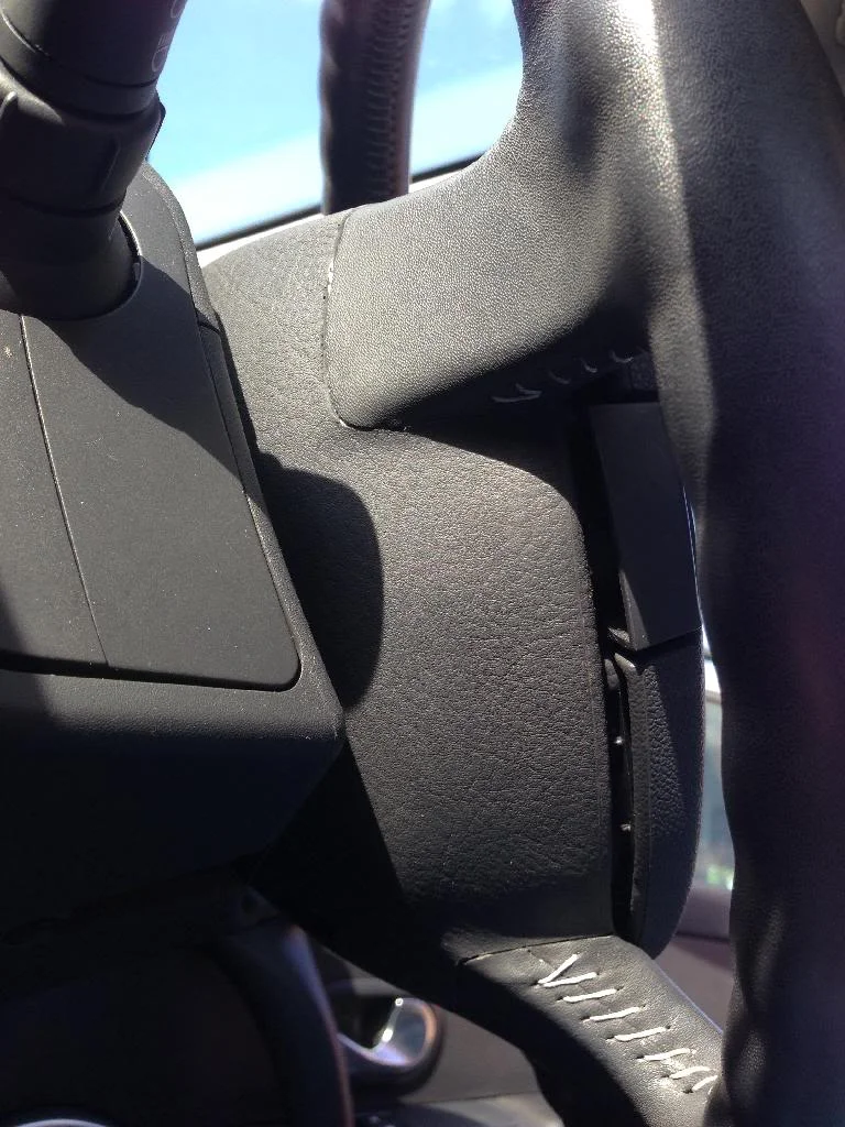

This is on my car but it works in the same way. The metal bar bit needs pushing towards the outside of the wheel. I use a screwdriver.
That fine thanks for helping me. There dont seem to be anything in the hole on the back of my wheel? Bit confusing.
It looks like someone has done a number on the rear of your wheel where the 1/4" bar inserts. Mk3 wheel airbags are horrible things to get off though so you have my sympathies.
Haha thanks fills me full of confidence. Does it have to be an 1/4" extension bar or can i use something? Why is it i use a 1/4" bar?
1/4" is the perfect diameter (Around 8mm OD I believe) and it has a flat end which is what you need to force the lower spring clip off the back of the bag unit. The remaining clip makes you feel like you are going to break something.
MicKPM thats great thanks. So i push the bar to the side of that metel bit or push the bar in the hole and that will detach the clip. Sorry not done this before and dont fancy breaking the wifes car!!
