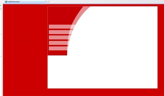

Here's what I get:

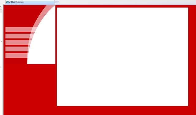

Here's what I want:
Basically I want everything to be relative to the white box.
