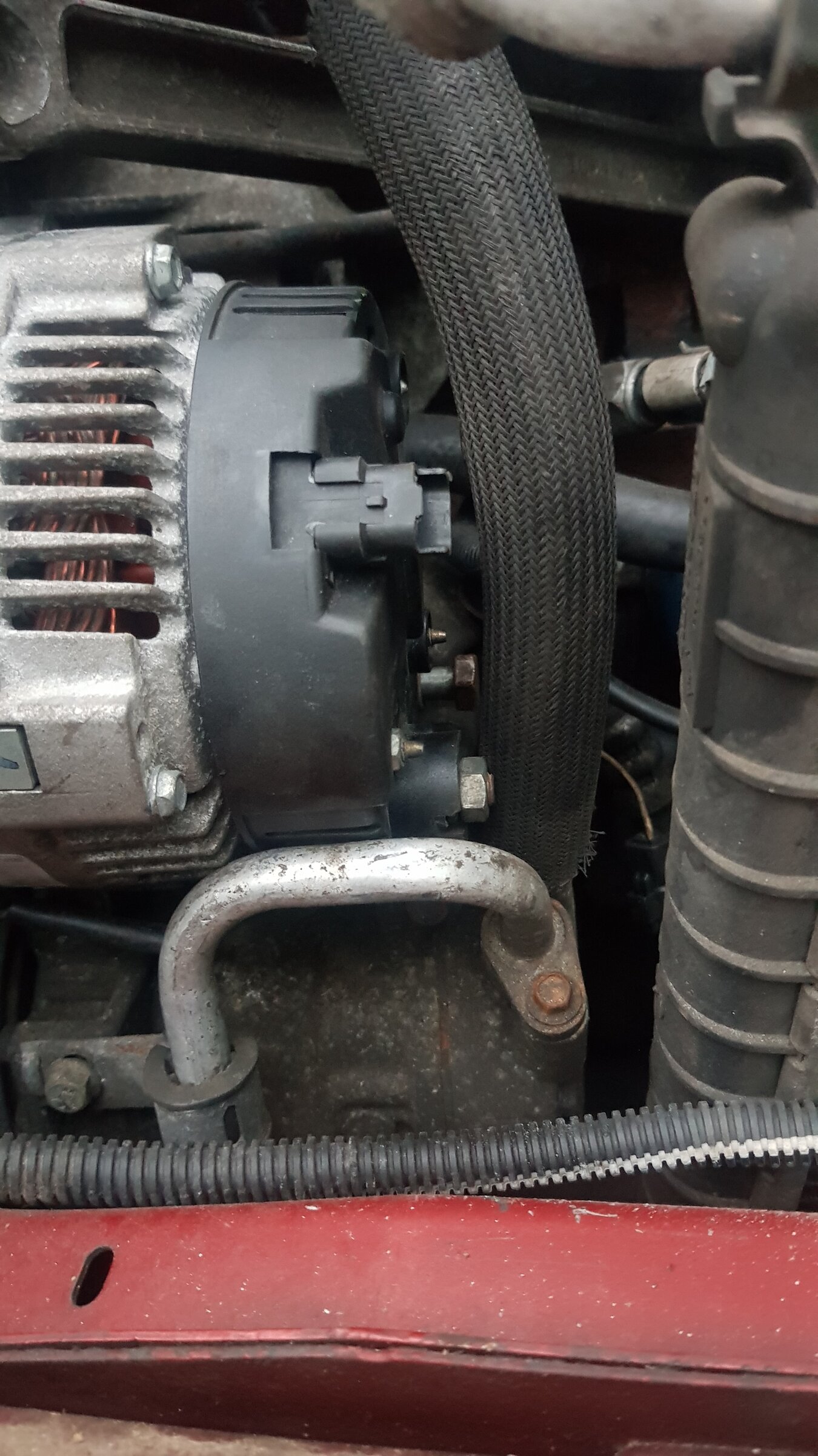

I'm looking for some clarification on this alternator, is it a cup version as the terminals foul the ac. hoses. If it is does anyone want a swap?

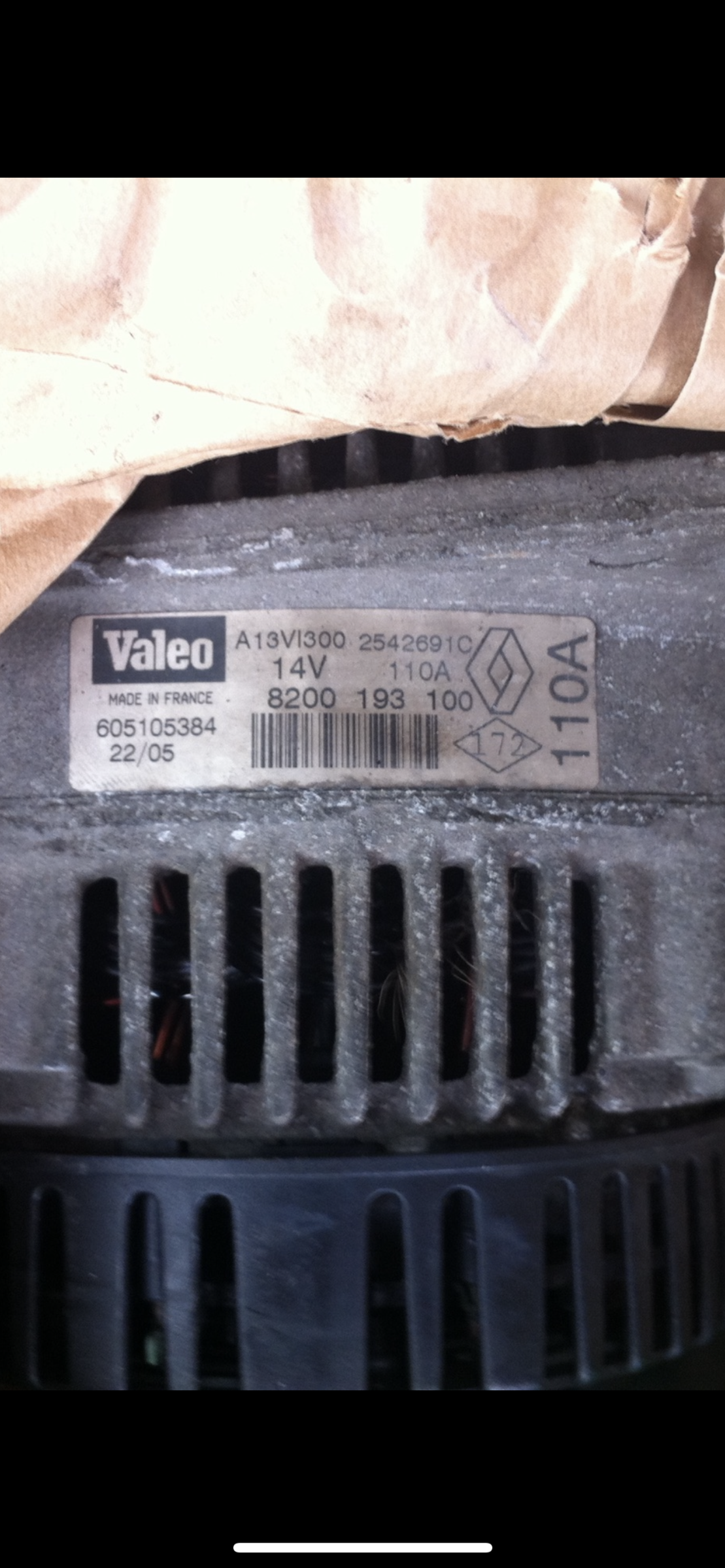

The label should say ampage, 110 is standard think cup is 75 maybe. Plus standard is offset mounting points, cup is top and bottom
I cant make out the label its worn off, on my old one the terminals are rotated 180° from the position in this photo
Cup Alternator is 75A
Part numbers are and the bottom is an exchange item.

Looking at it today I think it may be neither a cup or non cup alternator, I'll get some photos up for clarification

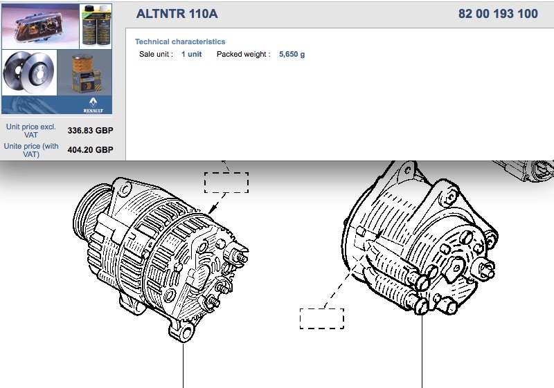

A13VL195 8200193100 comes up as a kangoo 110a alternator, is this of any use in th 1*2 world?

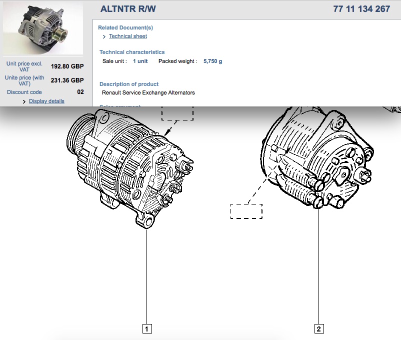

First one is non exchange
Second one is exchange.
This is the OE part number for a 182 110amp alternator.
I have put part numbers above and both are Valeo and this one was taken off my car.

I'm confused now, the main problem with the one I have is the power terminal is right up against the ac hose and the top mounting is over to the left by about 5mm. 'Family duties' have taken me away from playing with it for today😪
In my flamer? Nope correct way with the two mounting lugs at the bottom, one at top
Yeah sorry I forgot the cup was fitted back to front.
I wonder if it’s possible to flip round the regulator so you can get the plugs in.
I have wondered if I could play around with the terminals except the top mounting point isnt quite right, it pulls on the bracket so either way it's a no go
