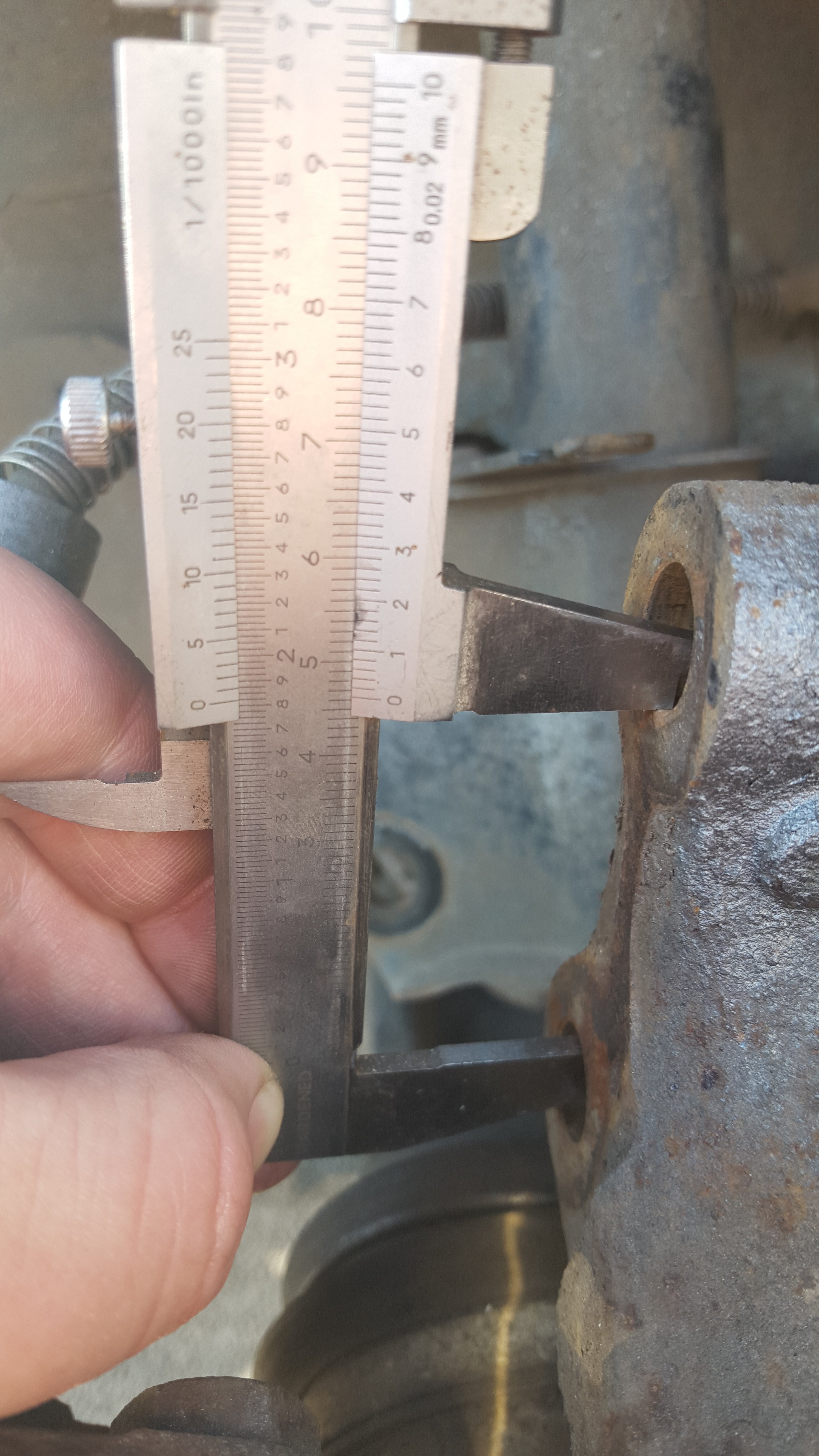

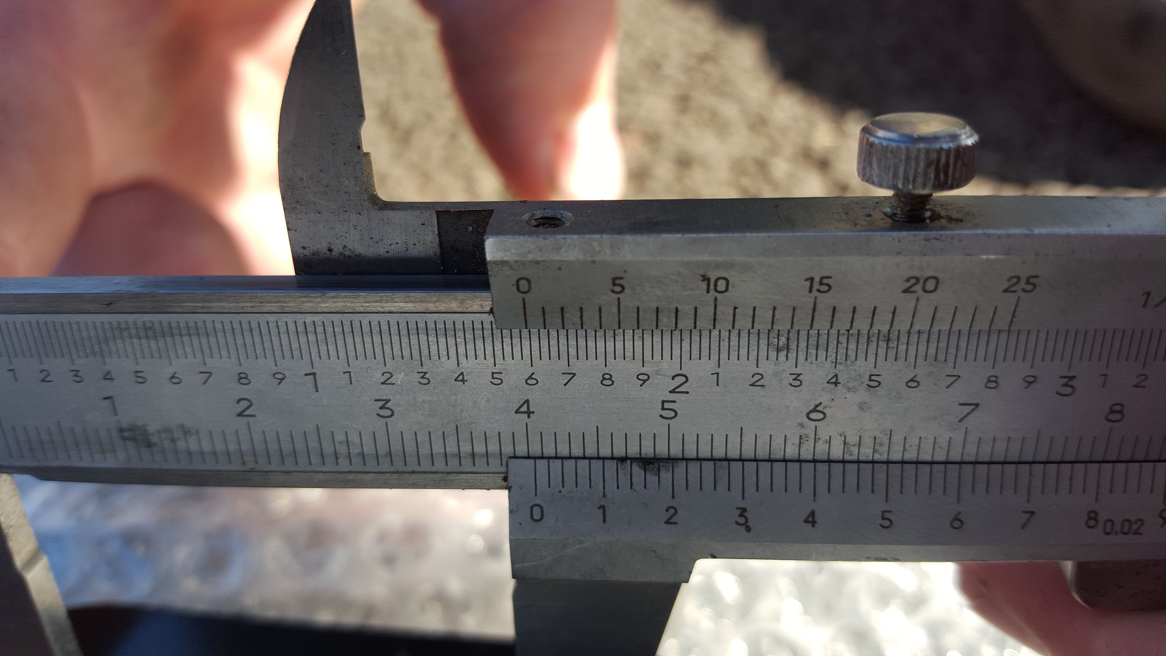

Well I have some avo suspension that won't fit as in the holes are to close, it's not a cup car but I'm guessing someone has fitted cup hubs
measure as you've done then measure one hole, add that to the first measurement and that will give you your centres.
1st pic shows a measurement of 46mm. Bolt holes are 14mm, so that gives a 60mm spacing.
2nd pic shows a measurement of 40mm, so same theory applied gives hole spacing of 54mm.
