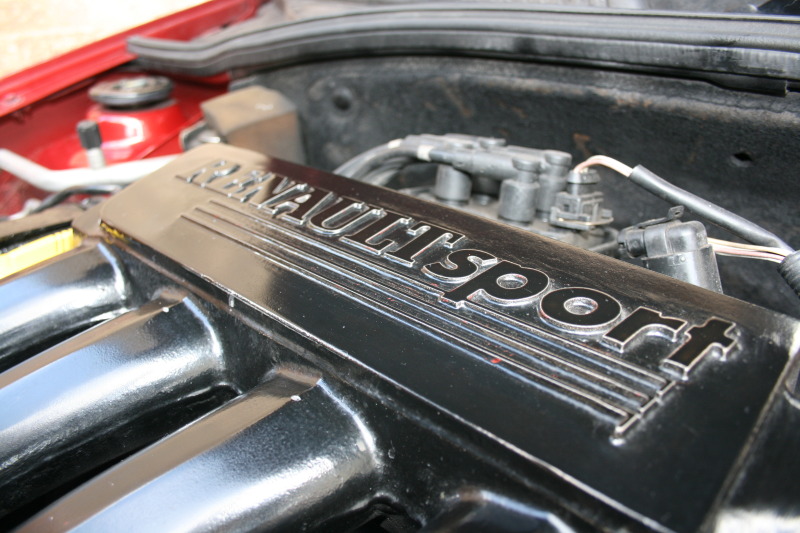

I would hazard a guess that your IAC valve is dirty and sticking/ struggling to move fast enough
Well it did it again this morning, and I noticed that if I knock the car out of gear or dip the clutch whilst moving the revs seem to rise and fall betweek 1200-2000rpm. I don't know where the ICV is located on the 172 if you have any idea?
Mine used to do that before I changed the IACV.. Though mine had a hole in the housing which caused an air leak sometimes.
Its on the back of the inlet manifold near the TB. I think from memory its above the OR in sport.

I was thinky maybe ICV or the other sensor opposite it? What are the 2 small sensors on the inlets for?
The small one is the air temp sensor and the bigger one on the LHS as you're looking at it is the MAP (pressure) sensor

ICV is next to the TB mate. It's a black plastic thing that sticks up at the rear of the body. Sort of the size of a finger.
You don't need a pic we've just told you where it is and what it looks like! it has an electrical connector on top of it and 2 10mm bolts holding it on.

The thing that's sticking up between the O and R ;)
