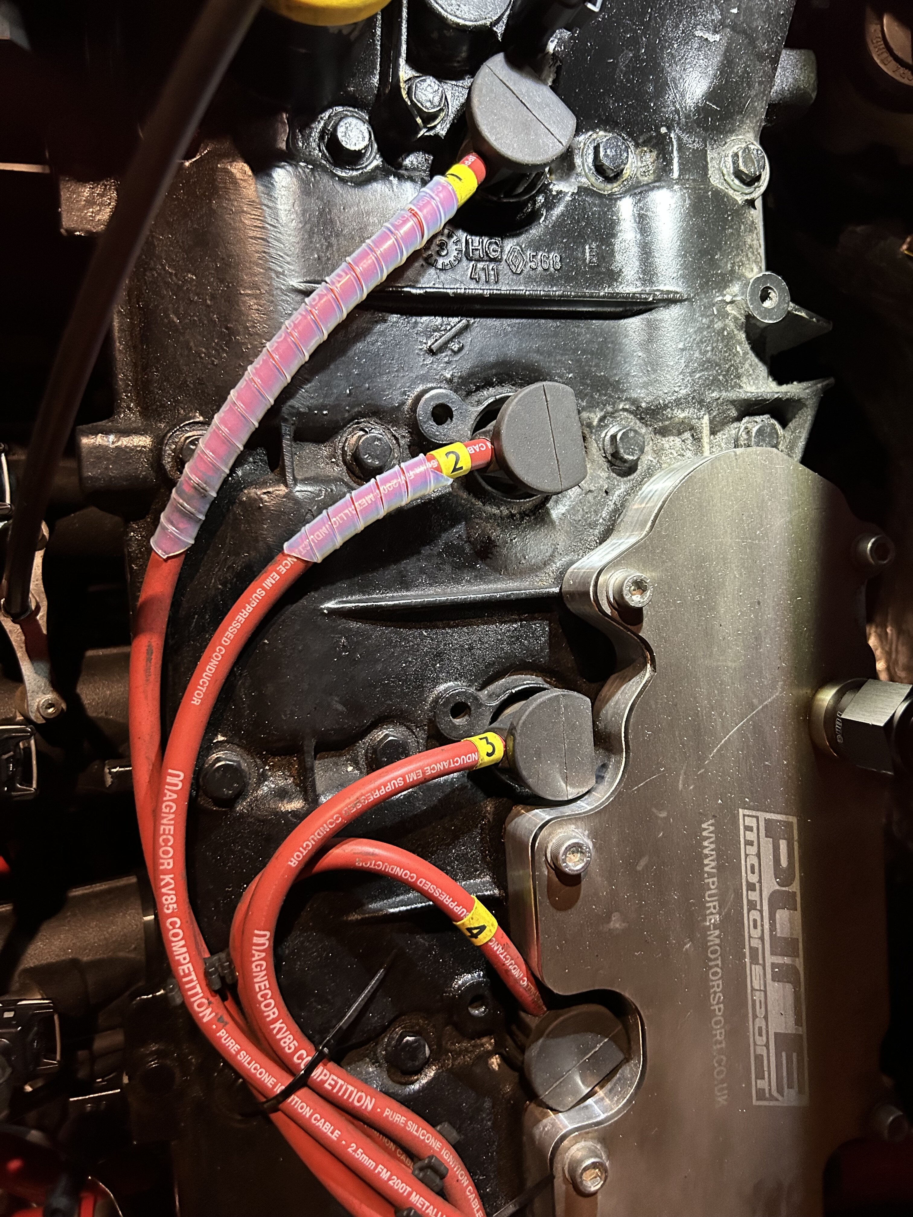

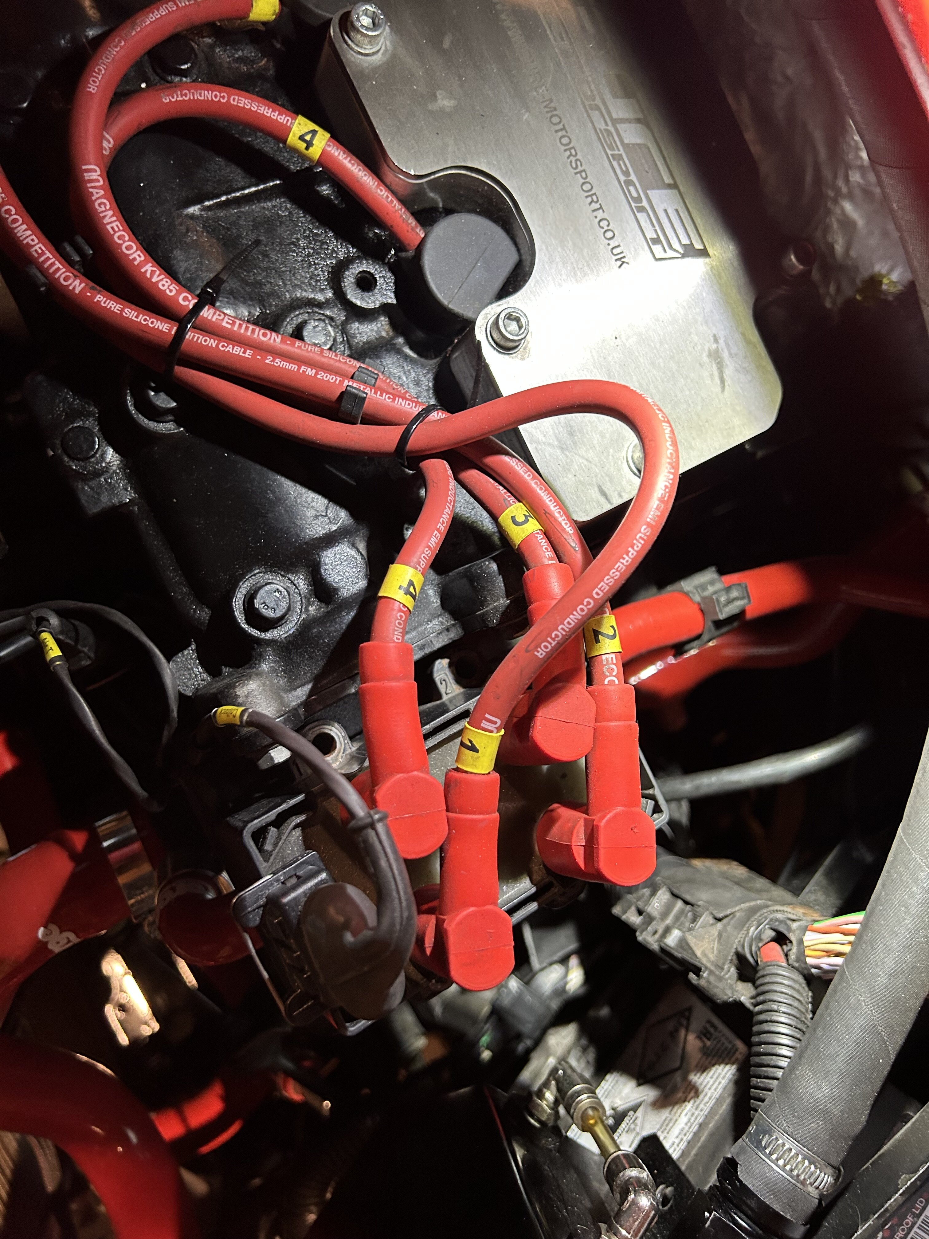

My Clio 172 I recently purchased has a throttle body conversion.
It was running fine but I have stripped all the loom and redone it as it was a mess and bodged together.
I labeled everything up before I cut the loom out so it’s gone back as it was.
But I have just noticed the coil leads are on the wrong positions on the coil pack and don’t cylinders go 4-3-2-1 left to right?
I have labeled my injectors 1-2-3-4 left to right on my new loom! I know i can just swap them about but it’s annoying as I have gone to a lot of work to make it look neat!
Don’t know why I didn’t check the coil pack and cylinder order first I just assumed it was right, The amount of bodges i have had to fix on this car I don’t know why😂
Anyway I can’t run the car at the moment as the manifold is off but i did start it for a second and it turned over and fired up.
I am probably worrying about nothing but would just like some clarification!

They seem inverse but the Clio coilpack usually mounts on the other side of the engine, ie. the number 1 cable is the longest. The cylinder numbers on the Clio are from the flywheel towards the cambelt.
So 4-3-2-1 from left to right, cylinder 1 closest to flywheel.
