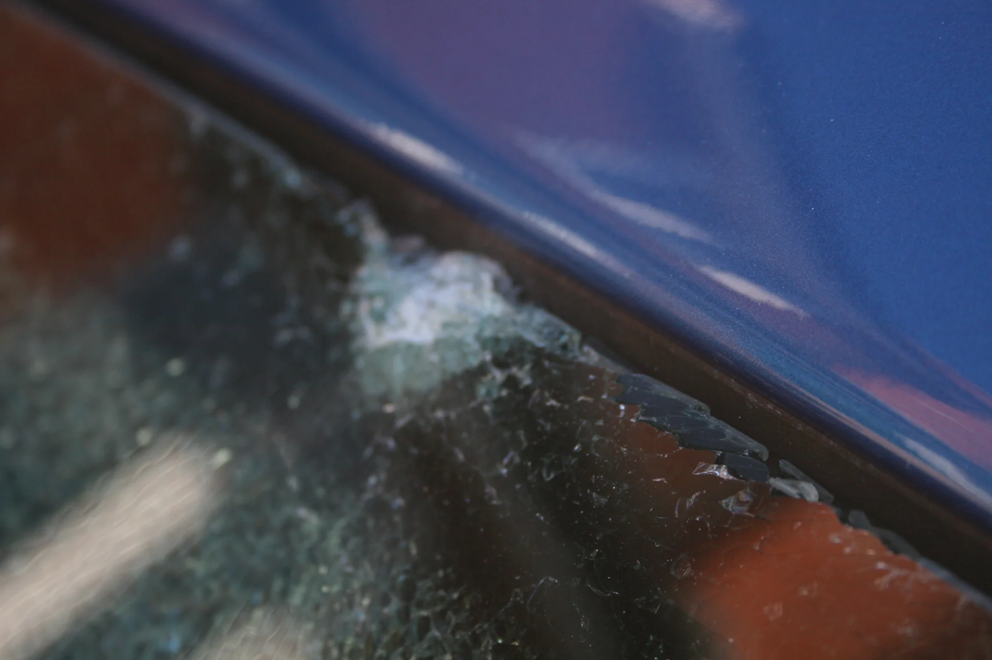

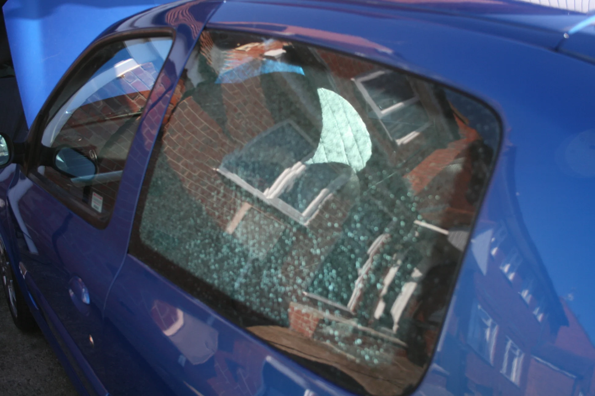

The car has been covered up a few weeks, just took cover off to charge the battery as I do every three or four weeks and found this damage:- it must of happened in the last few weeks but don't know when, it was not noticed until the car cover came off today.
It looks like side impact right at the top of the glass by something heavy like a metal pole, fortunately it has not caught the bodywork.

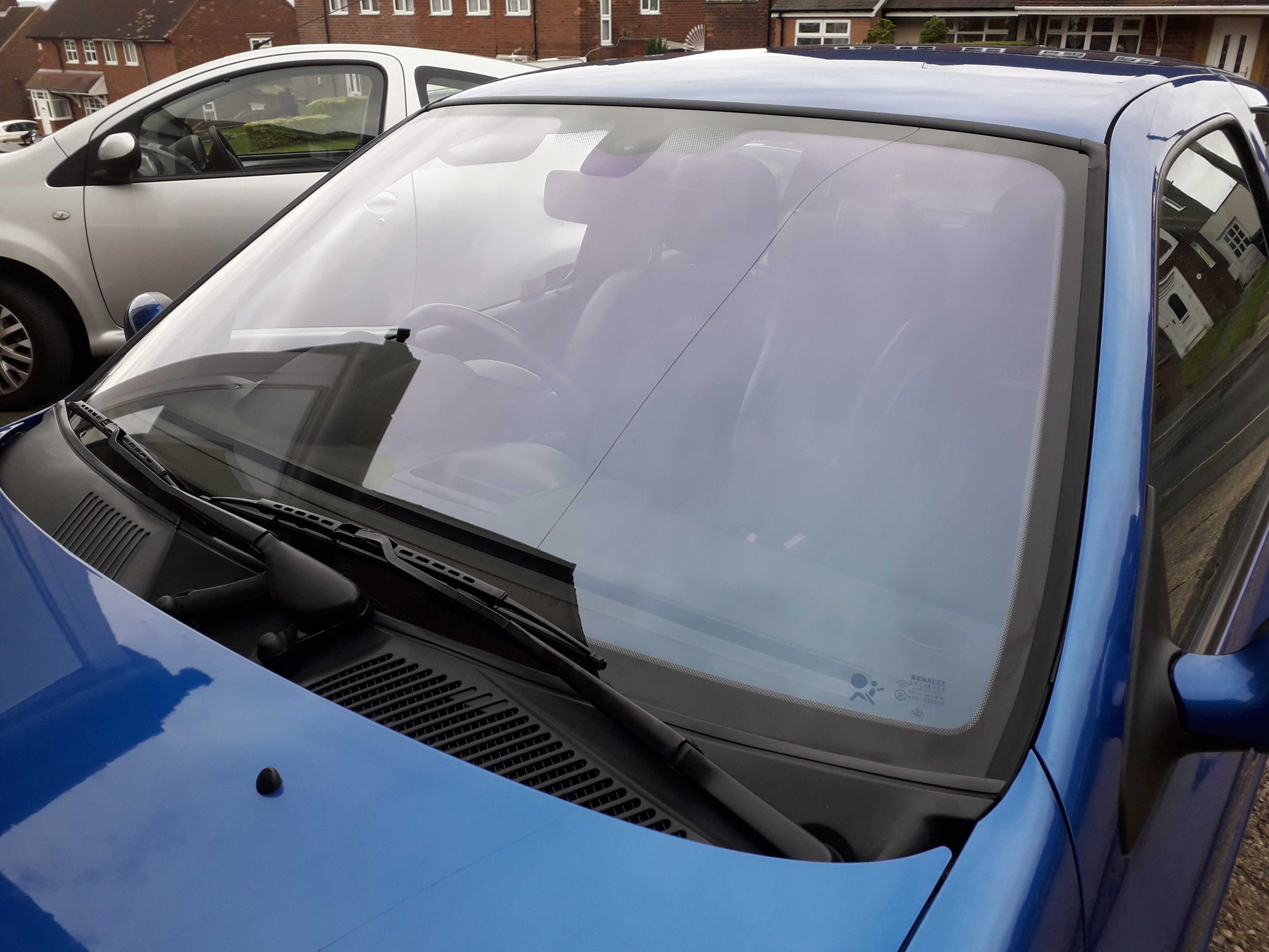

The quarter glass was replaced by a local company, it's genuine Renault glass, dealership says this was the last piece in the country, I'm glad it matches.

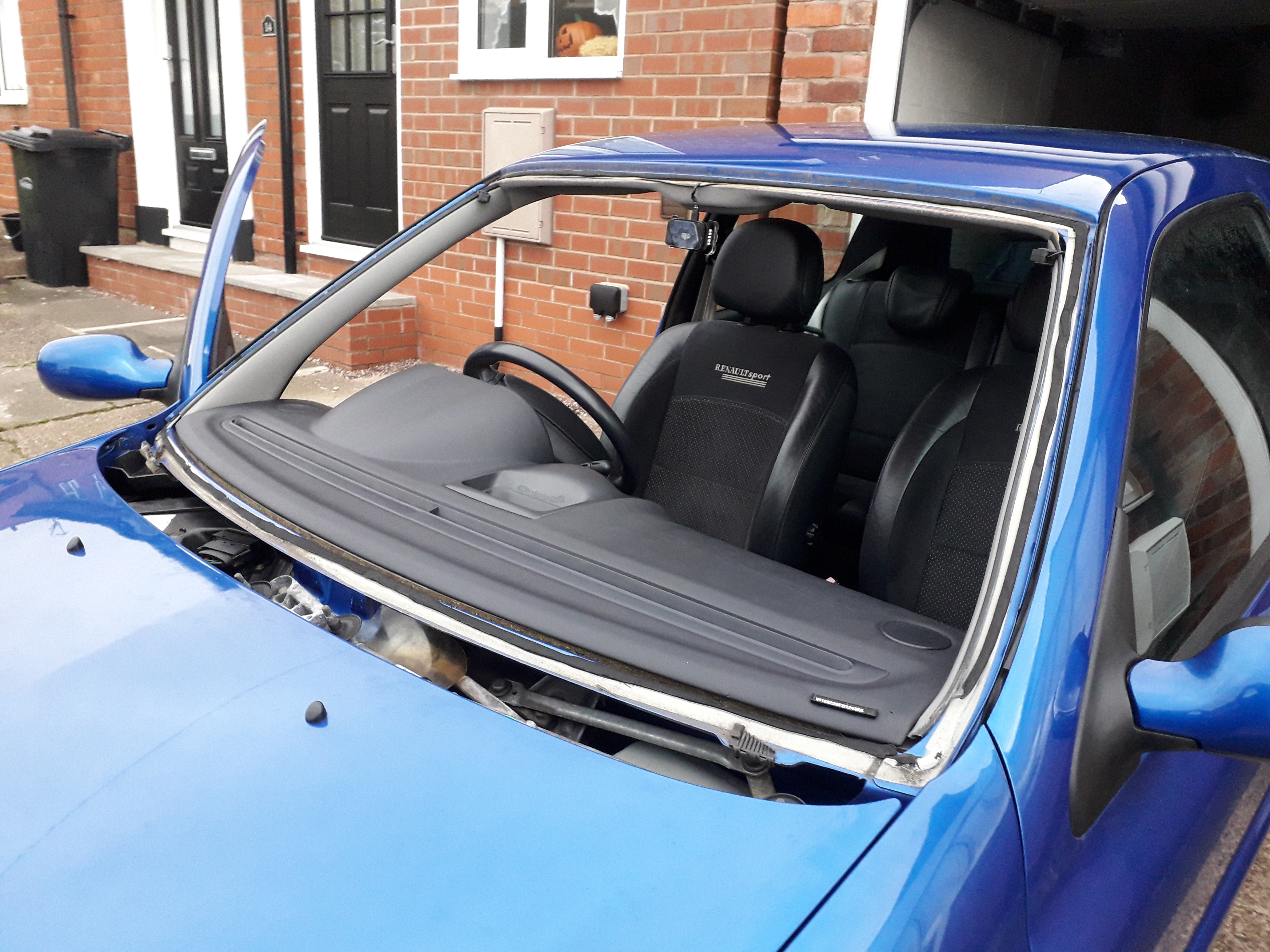

At the same time, Renault also supplied the windscreen, despite supping them with VIN etc, it was the wrong screen, the fitters noticed it straight away, mumbling about it should be a 'heat reflective' screen (with the little square at the bottom).

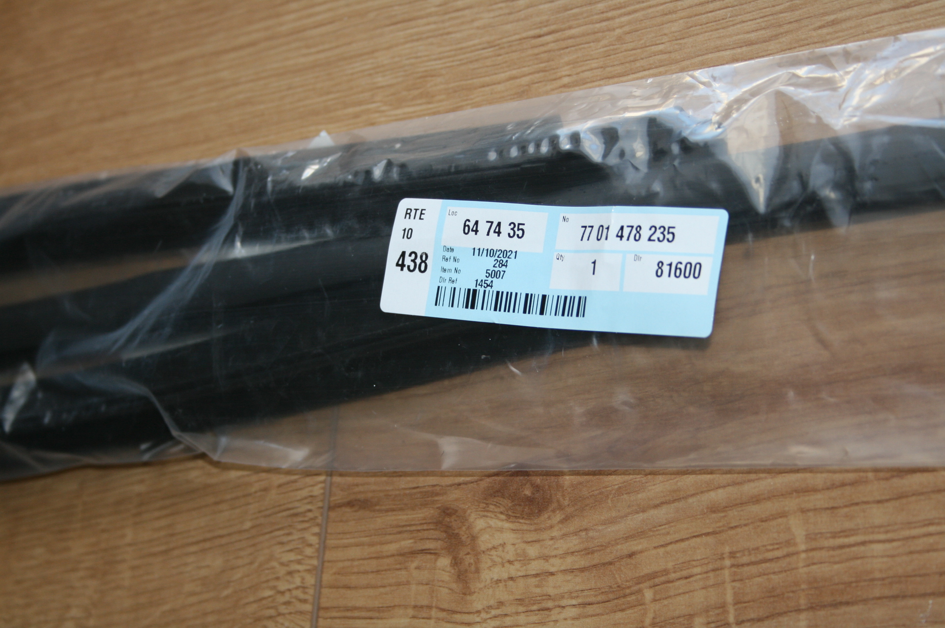

So I am still awaiting the correct screen, meanwhile I got a new screen trim surround off RPD, as I expected this to get damaged when removing the screen.

I guess we got to expect NLA now after 15+ years, RPD still have a few choice parts on their site, good service from them though- ordered parts Tuesday night, arrived this morning (Thursday).

Yes it was, the first screen was incorrect even though Renault dealership insisted is was right (supplied the VIN), apparently there is something in the depths of the Ren system about it if they had checked, so they got it right second time. Not convinced it is worth the extra dosh though - the heat screen is £100+ extra, over the tinted one, and of course Renault price is inflated anyway.
So did you not go through insurance? The heat screen is just uv coated isn't it?
When you get a replacement screen direct from Renault do you get that unique number etched in the glass like the original screen?
No, the original screen was not etched, but think glass is etched on the side glass bur can't remember which one , the new screen is not etched either, has the Renault logo on nearside.
I thought the UV was in the laminate, not sure but hope so as UV coating tends to scratch.
