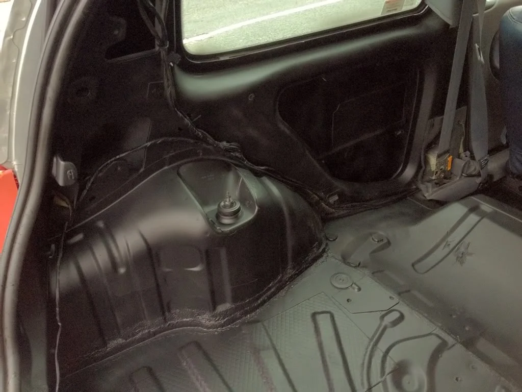

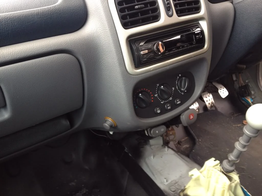

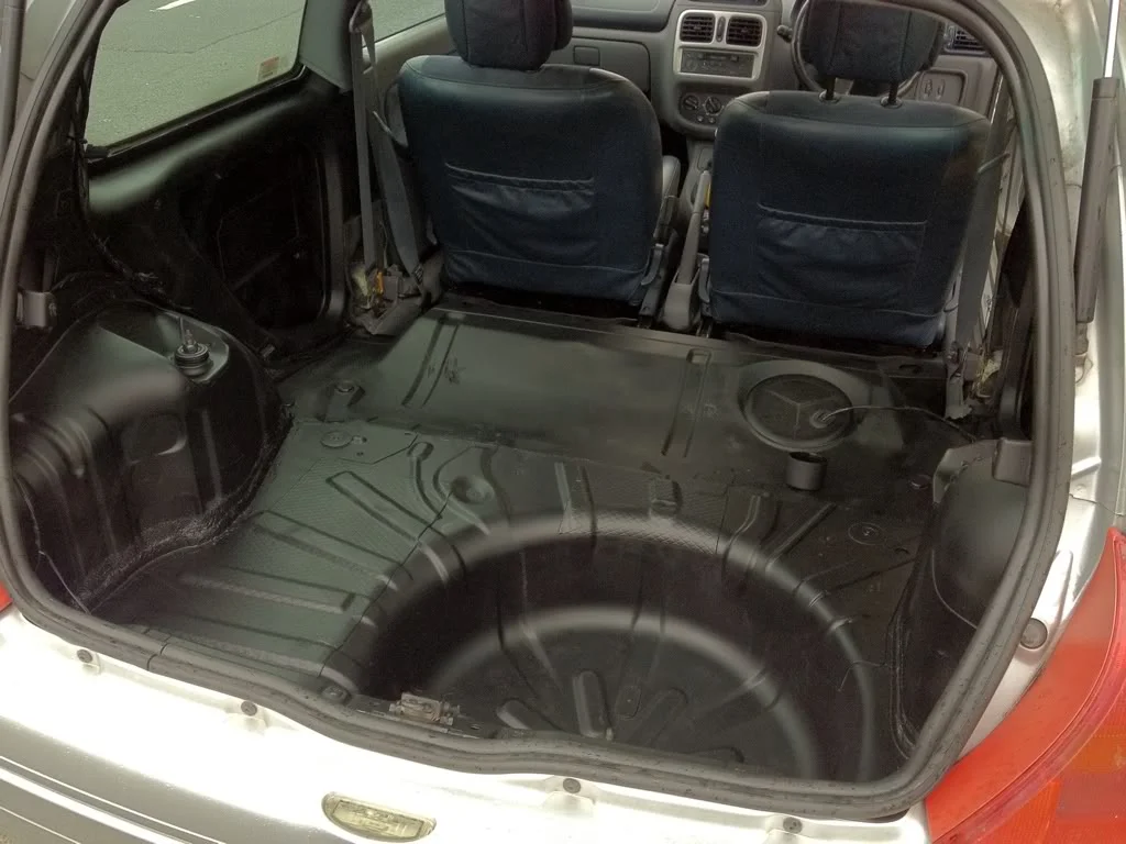

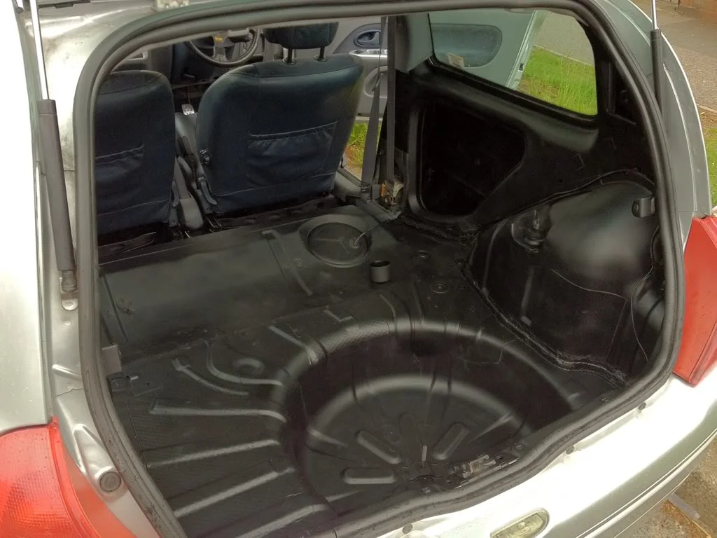

Today i made a start on stripping stuff out
and found this

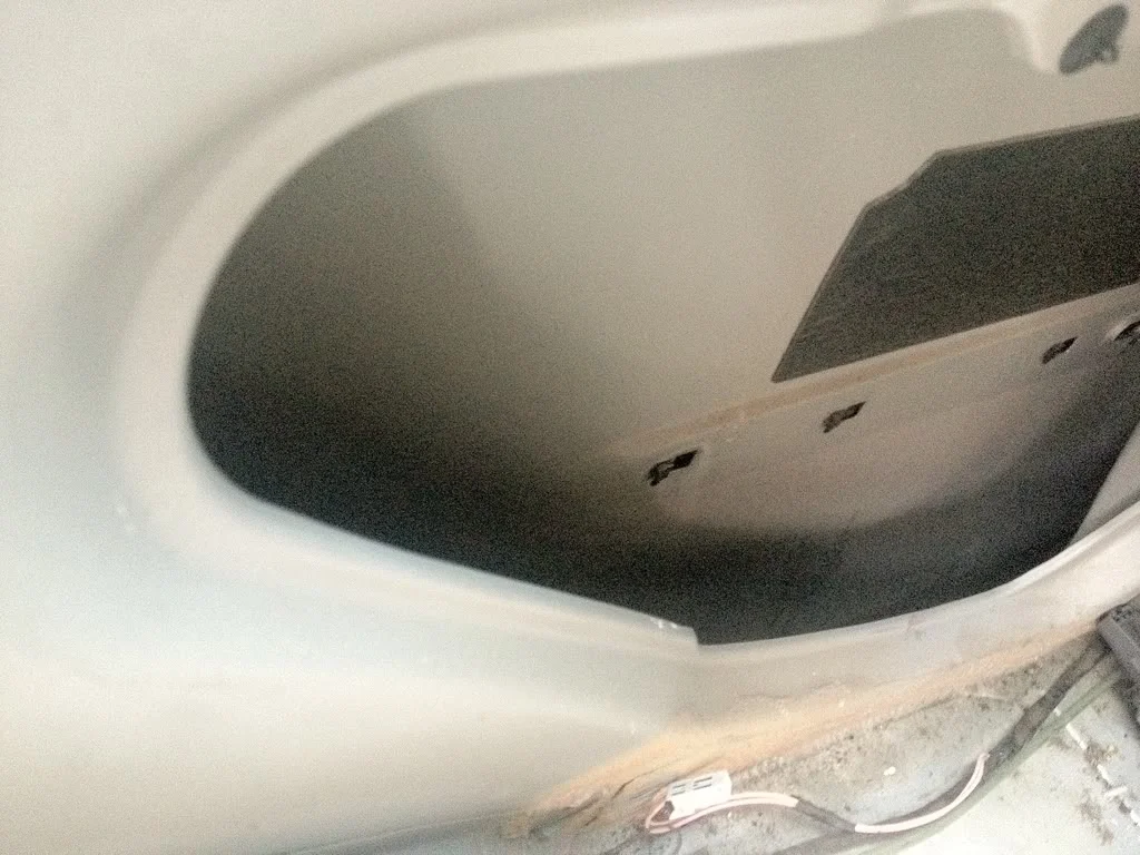

theres quite abit of water gathered up in there couple of inches maybe any idea what that's from and how to get rid of it?
and found this
Has it been jetwashed? If so it could have got in from behind the gumdrops on the quarter or have you got a leaky rear window?
  Ph1 T
No leaky window, not sure about been jet washed only had it a week,, I'll empty it somehow and see if anything comes back

I had the same problem with my passenger side too. The rear window is leaking and running down the insode of the qaurter and filling it up. If you can get use of an airline blow all the holes in the sill ( under the car) and it will drain out no problem, Any water getting in will then run out the drains. Just make sure you keep an eye on them as they block easy!
  Ph1 T
cheers spoke to a mate a little erlier he said the exact same thing going to get it sorted tommorow.

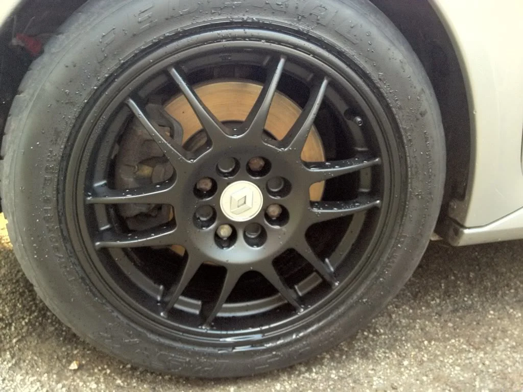

Hoping to get a few bits done today
Paint interior and wheels
fit 3/4 plate
Decided I'm gonna go Matt black for the interior

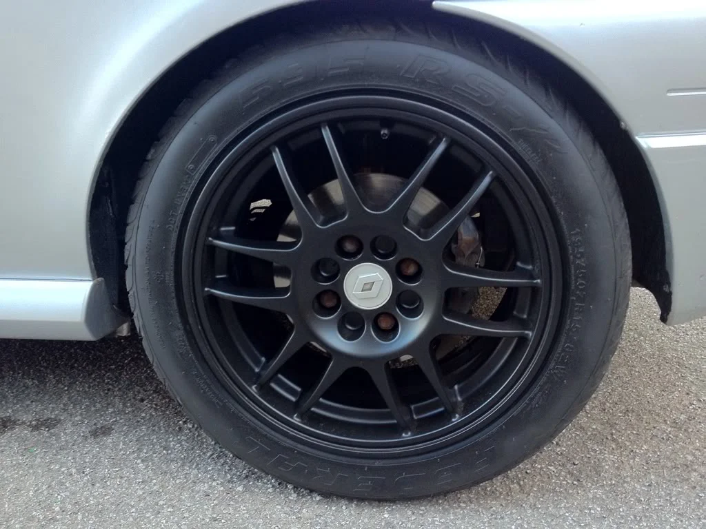

Unsure on the wheels though Matt or gloss black?
  Megane r26
fit 3/4 plate
Hmmmm i'm more of a gloss fan tbh but suppose if its going to be a track car matt would be easy to keep on top of if they take a bit of a scuff

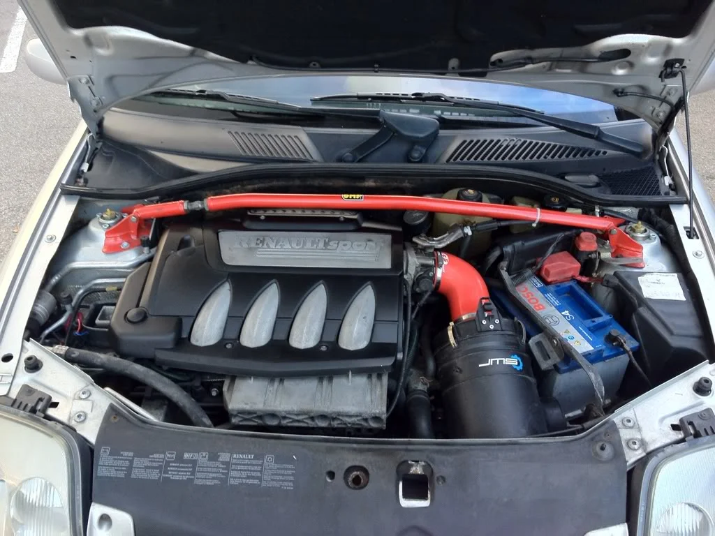

Nice. I was so tempted to buy this. Seeing as you have the pure top mounts you might as well get rid of that red brace and get the pure motorsport brace to fit it?

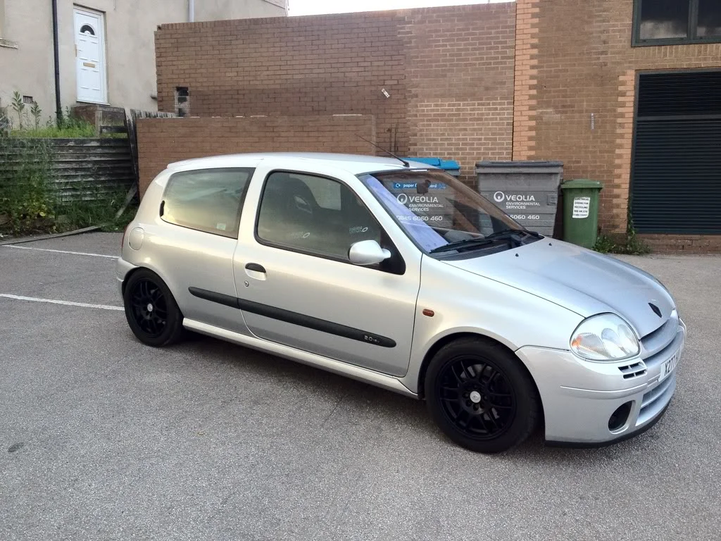

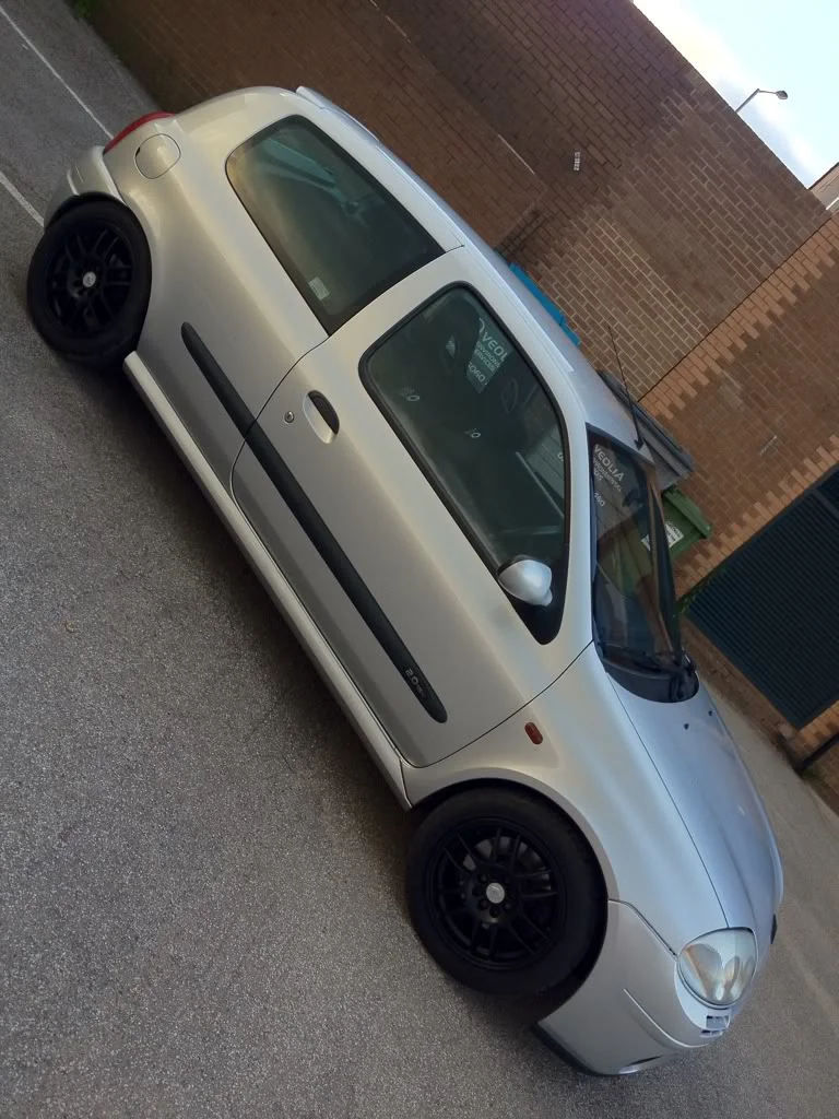

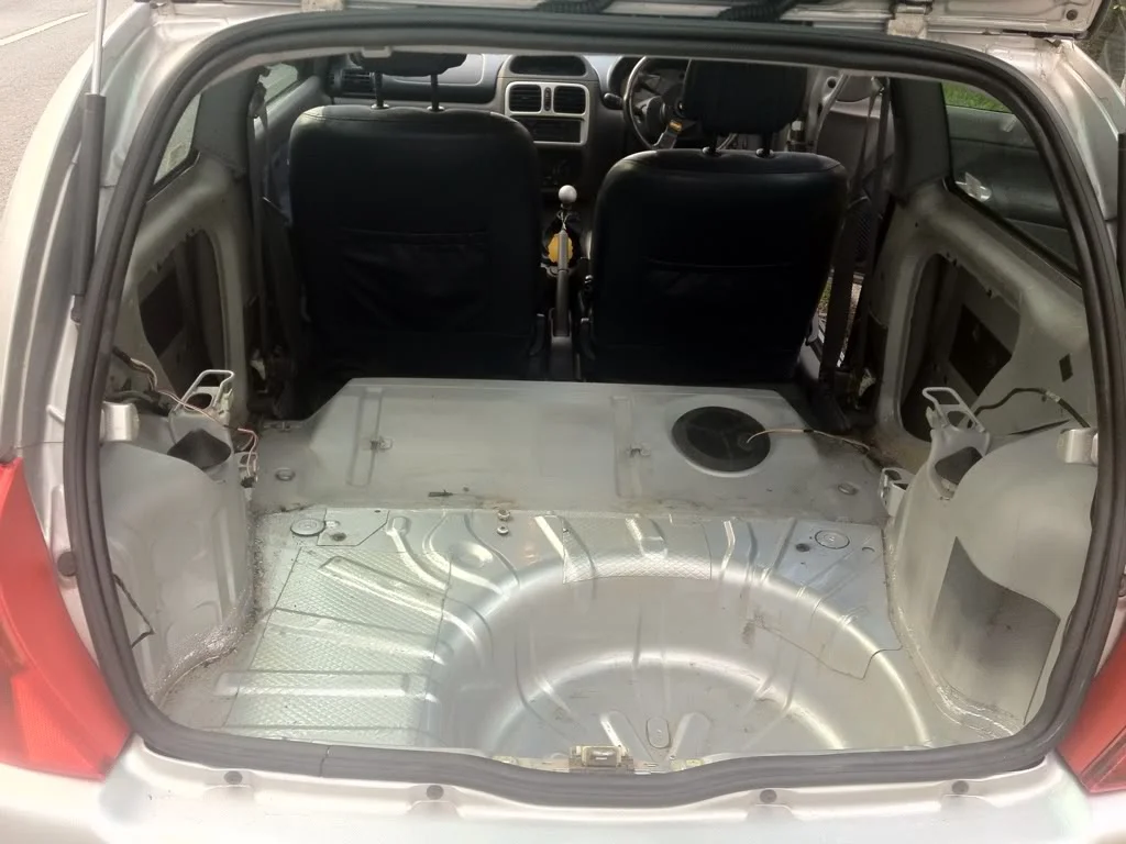

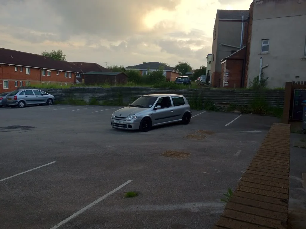

Got a few bits and bobs done today mainly grinding bits out of the rear cleaning it up and painting turned out pretty decent for 1 coat decided to go with matt black in the end.
just electric taped the wires together and a few tie wraps for the time being until i re route them.

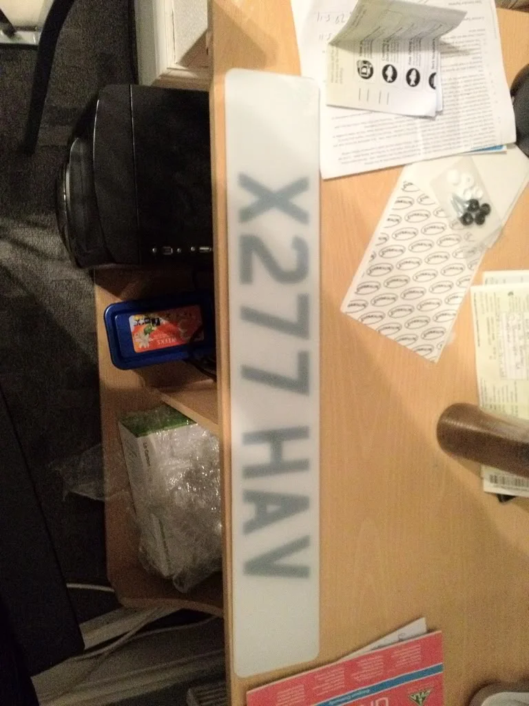

while i was at halfords decided to get some of these instead of the double sided sticky pads, found them alot better
new plate on :)
looks 10x better IMO with the 3/4 as didnt like the one that was on before and a quick pic of my mates evo 6 while im at it
Didnt get round to doing wheels thats going to be a job for next weekend along with fitting a skoda splitter. thats 1 or 2 jobs out the way anyway may the long list continue

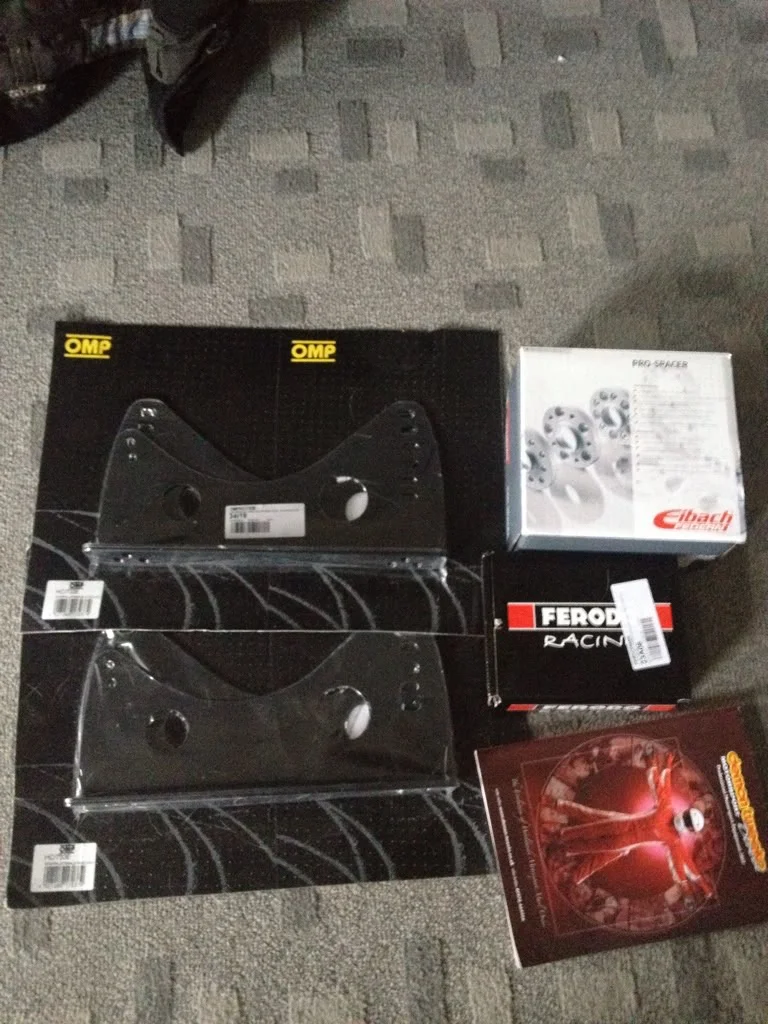

FINALLY AN UPDATE!!
must be the worst project thread on this forum but oh well....

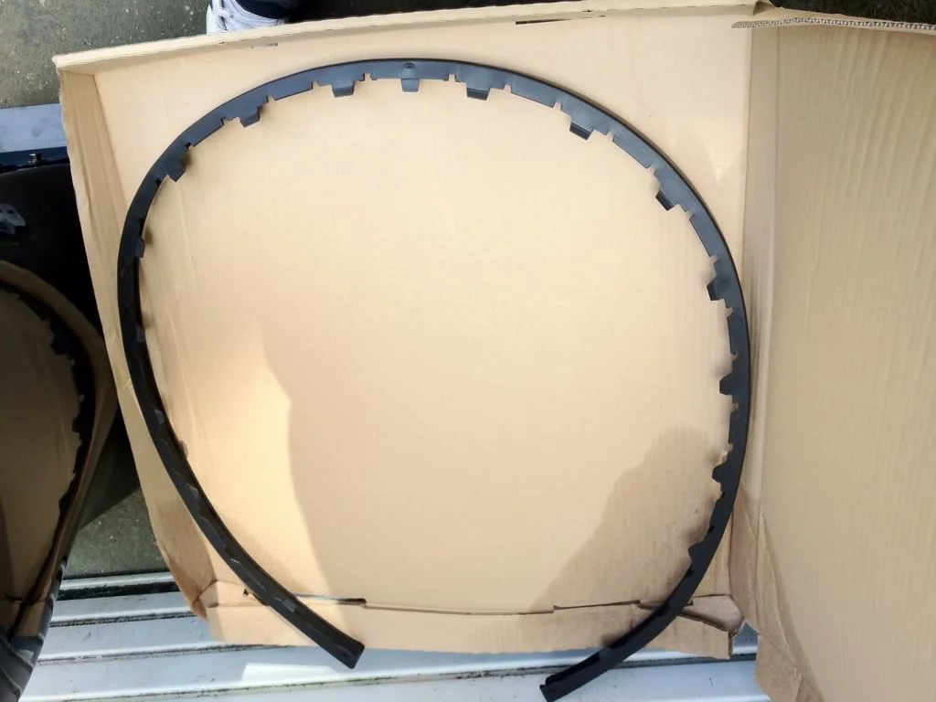

realised its about time i cracked on with the ph1 so had a few parcels delivered this week :)
Eibach 25mm hub centric spacers
Ferodo ds3000 pads
Skoda splitter
Matt black paint X6 Grey primer
Bimarco Futura OMP subframes and side mounts X2
and lots of stripping.

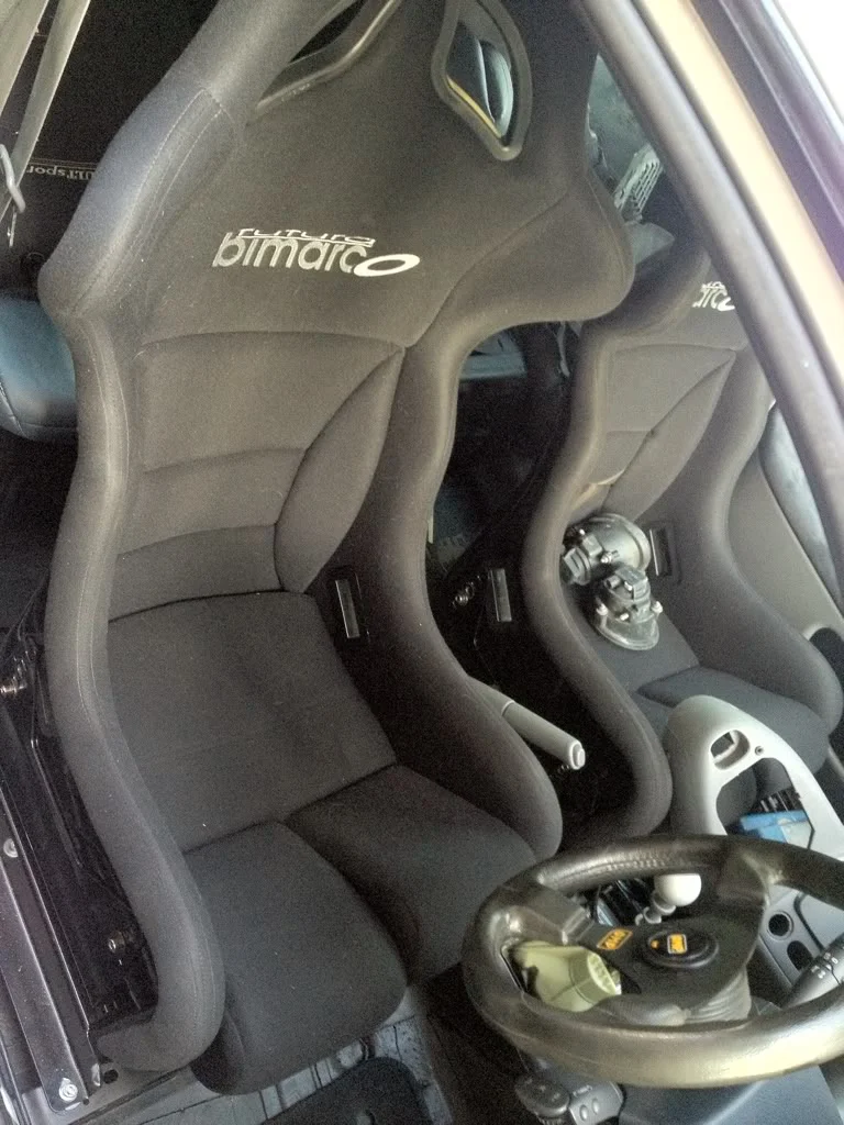

Where did you get the seats from in the end Dan And also the numberplate? I need new front and rears.? Car's looking tidy btw look forward top catching up on track again some time, hopefully not going backwards ;)
  Ph1 T
Ha yeah preferably Going in the same direction,
Got the seats from a member on here and the number plate from fancy plates and it's fixed with them sticky Velcro pads ya get from halfords ect...

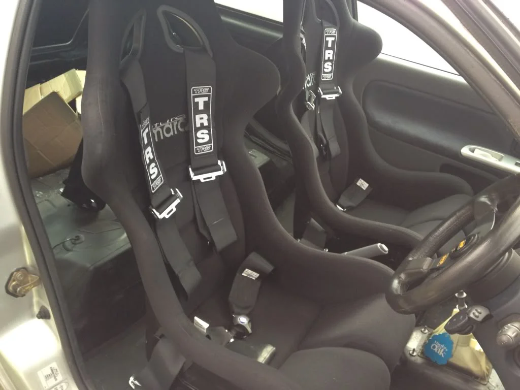

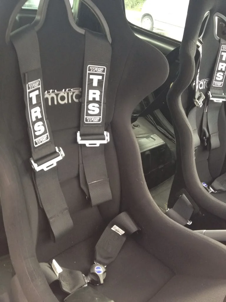

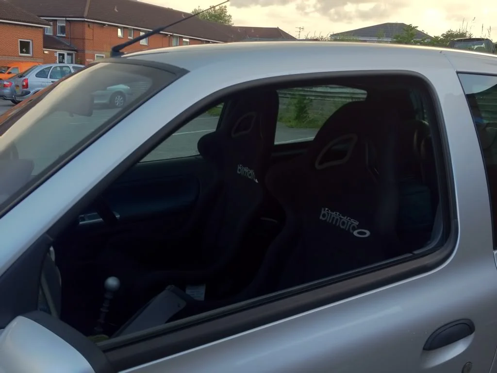

Did a few little jobs yesterday main one been got my harnesses fitted :)
also rehoused the switches and the power supply so there not just dangling about
Got the ds3000 chucked on aswell and had run out on them last night to bed them in, started squeling after abit but they feel sharp as hell after abit so happy with them, and put my H&R 15mm rear spacers on
need to do some touching up with the paint on the interior as have took bits out since painted it.
pretty much all set for the ring on friday now slightly excited :)
