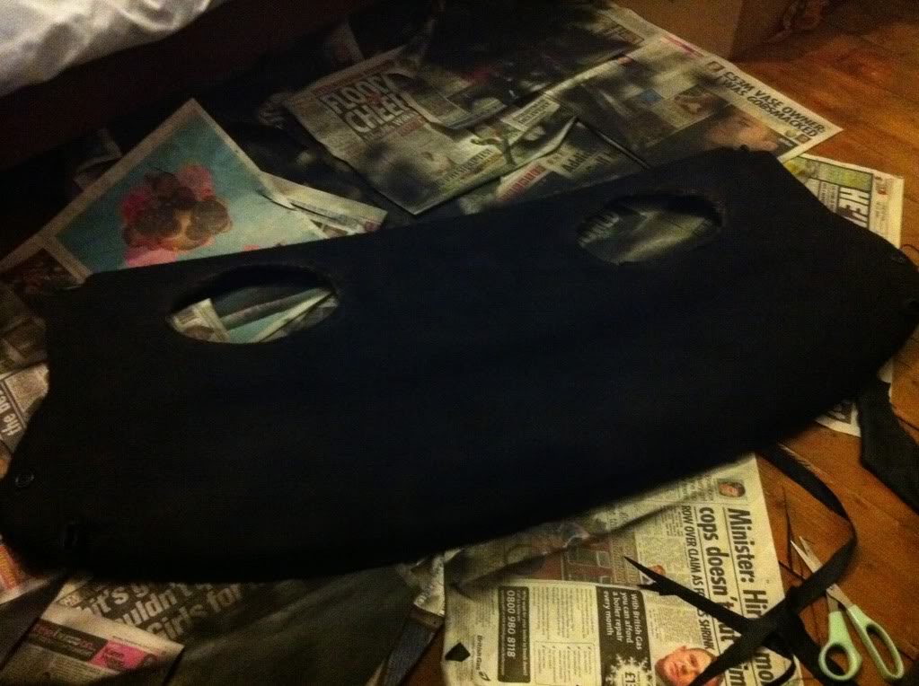

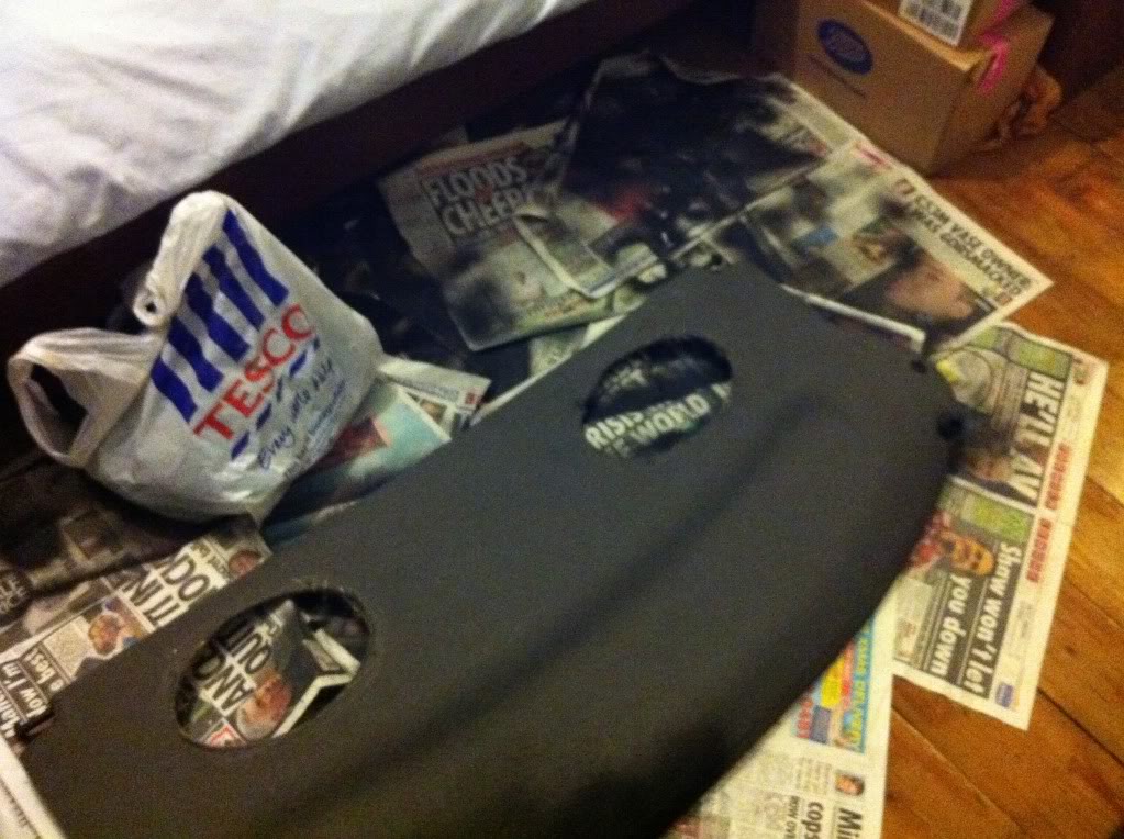

ive never done the headlining but this was an old parcel shelf on my zs..
before
after

Normal black spray paint - car paint
It was a common trick when I was a valeter if a roof lining or parcel shelf was covered in marks - just mask everything up and spray it with a load of fine coats of car paint. Bizarrely it works really well and doesn't come back off when dry
Don't use lacquer or enamel as it will go crispy, and do several fine coats (don't go for full coverage on the first coat) or you'll apply to much and make the fibers stick together

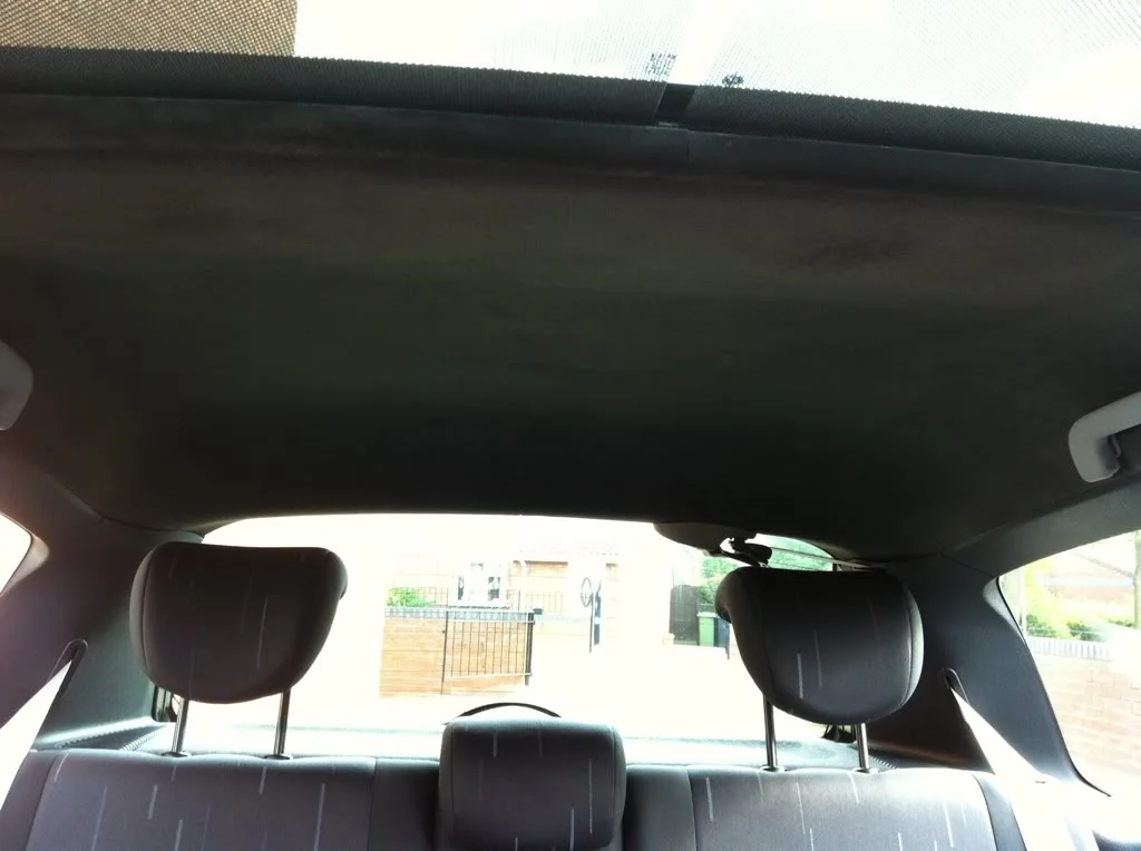

Upholstery Spray:
Carpet Dye:
file.php
Personally Carpet Dye looks like it gives the better finish.
  SQ5
Last picture looks brilliant, exactly what I want. Is kind of the same colour as the Alcantara.
Do you know what products and methods were used?

i pressume it would be a deep clean, then apply carpet dye in light coats until desired finish.
sure it can come in rattle cans

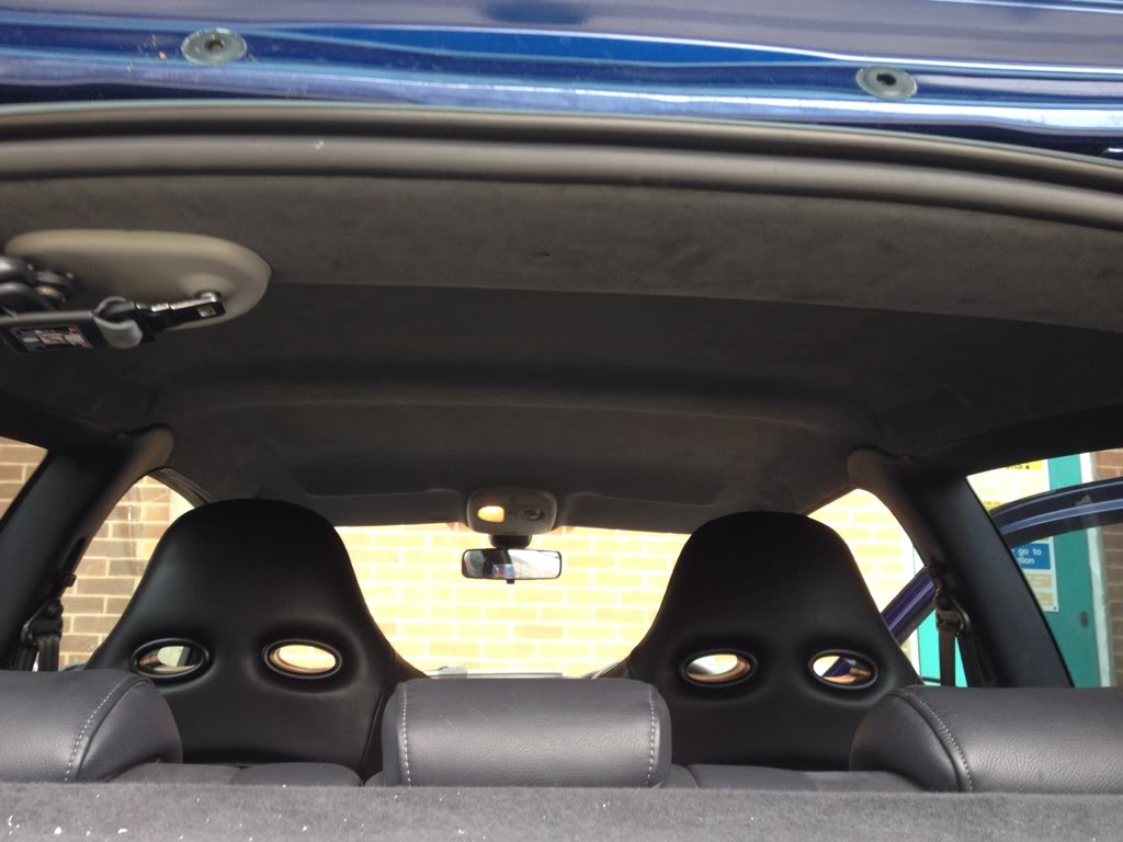

Yeah doesn't take much to get the pillars and headlining off/down, once the headlining was down it went on the dining room table for the material to get measured out and cut then it was just a case off getting decent fabric glue and taking your time applying the fabric keeping the material fairly tight as your sticking It down. I opted not to put my grab handles back on and also kept my sunvisors and and interior light surround standard to break up the black a little. I know some people wasn't that keen when I 1st posted the picture up.
