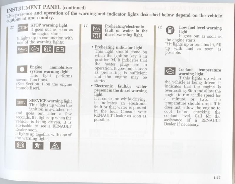

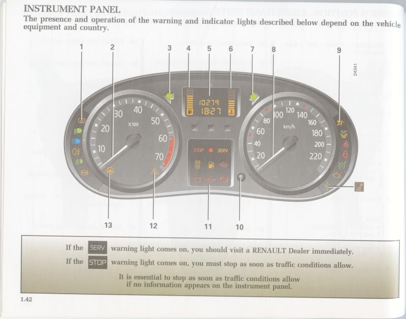

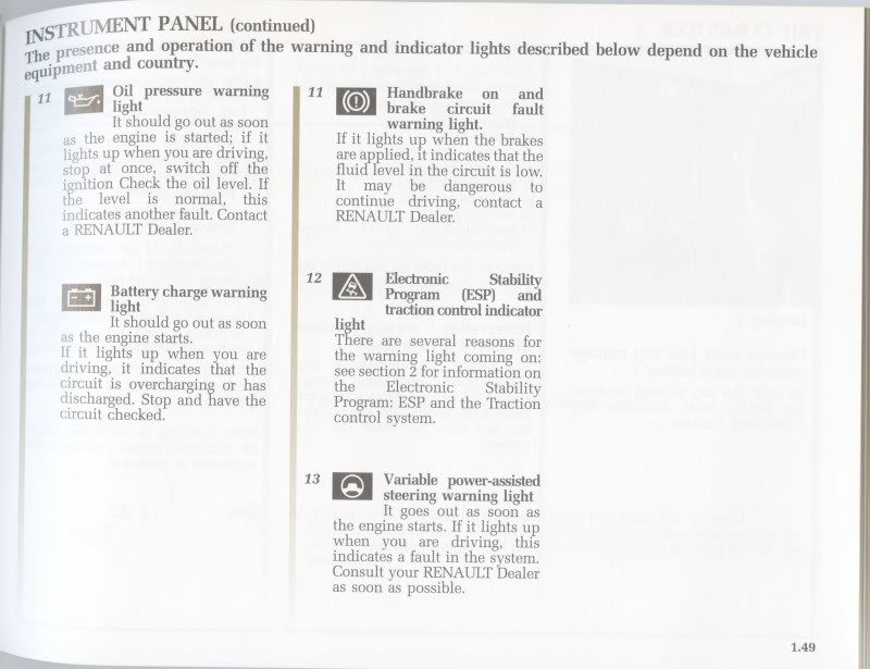

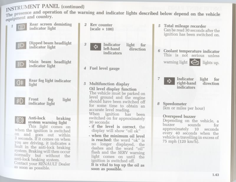

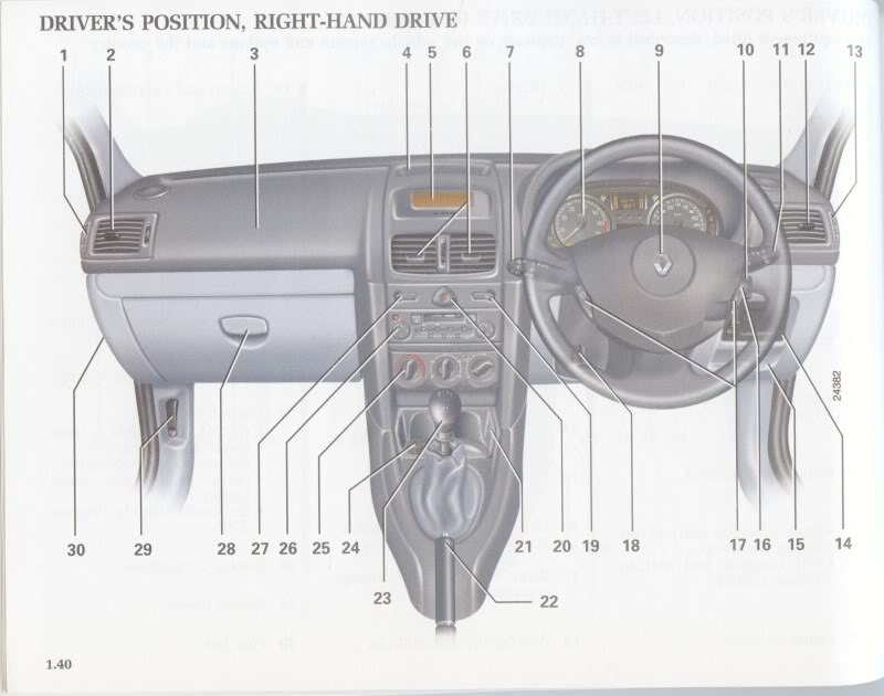

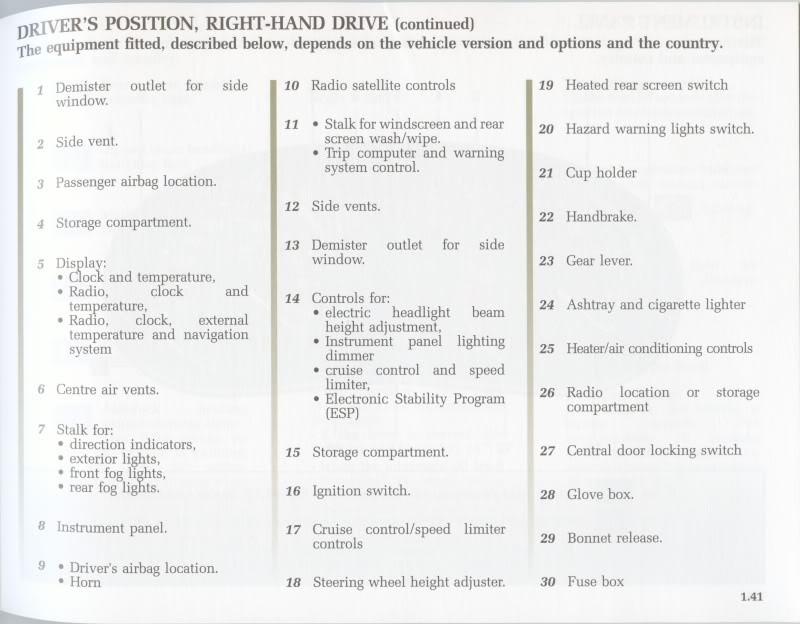

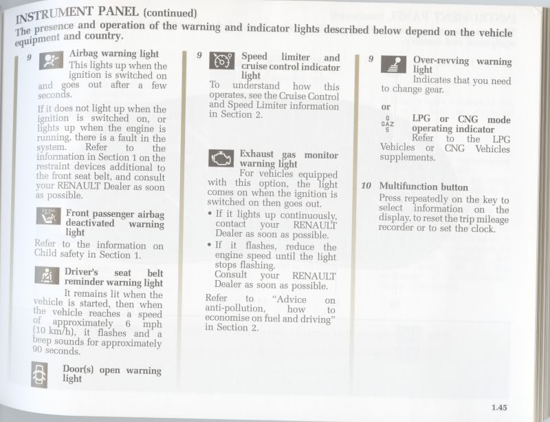

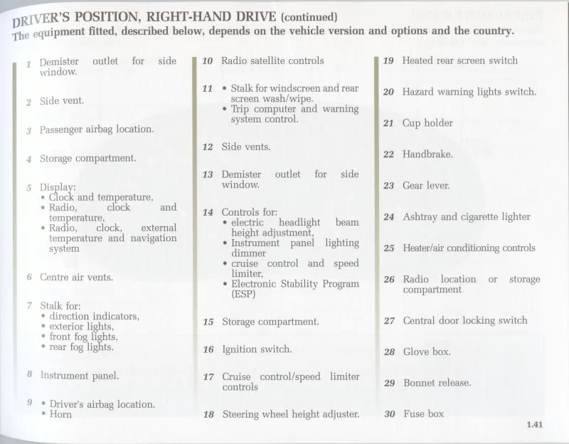

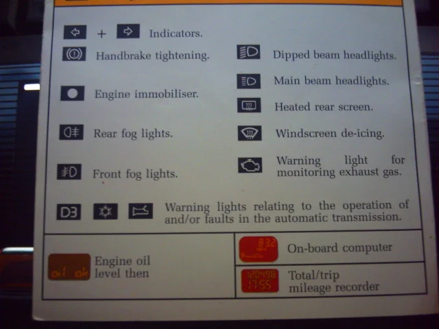

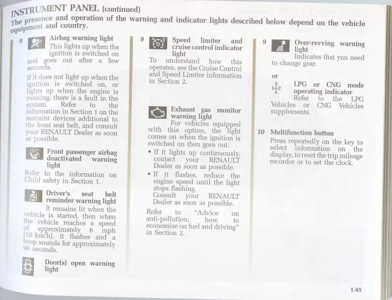

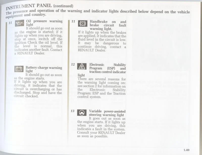

hope these help mate, the pics are from the (your vheicle in breif booklet)

Brilliant! Thanks! :)
your welcome, im pretty sure the light is your exhaust gas warning light, lambda sensor, think u have 2 on yours they are at either side of ur exhaust before the cat they look like spark plugs, might just need the wiring cleanin n lubing up or one of them has gone, n needs replacing.
