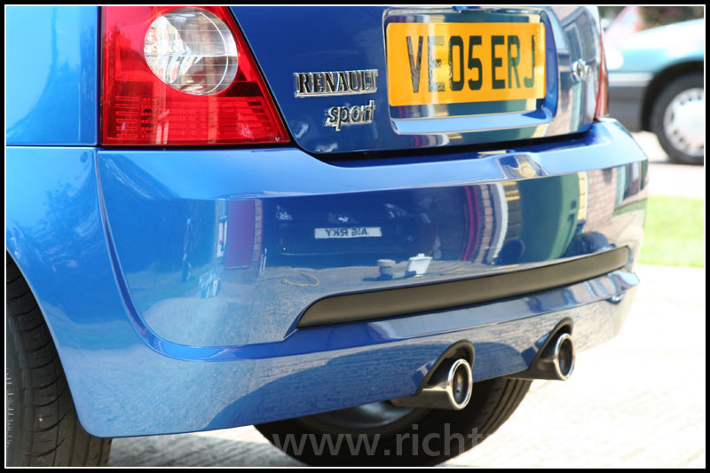

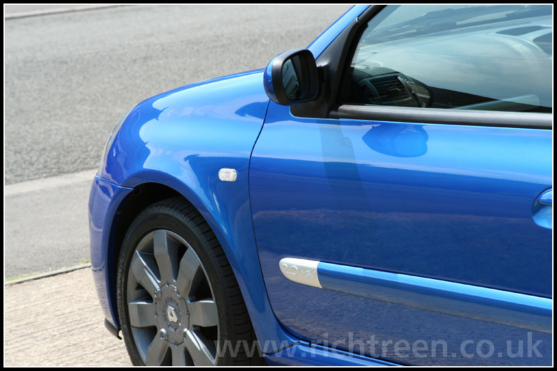

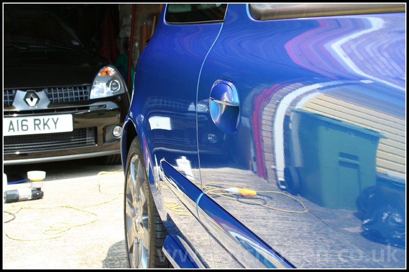

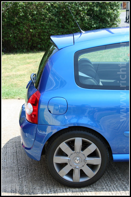

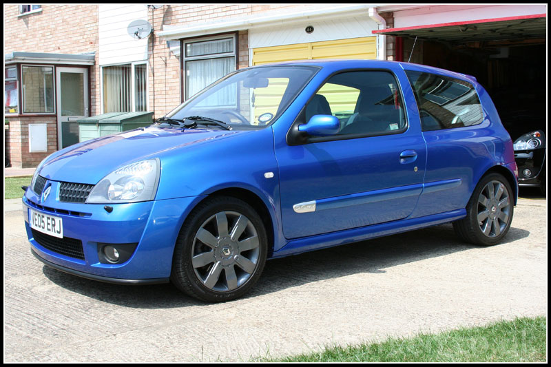

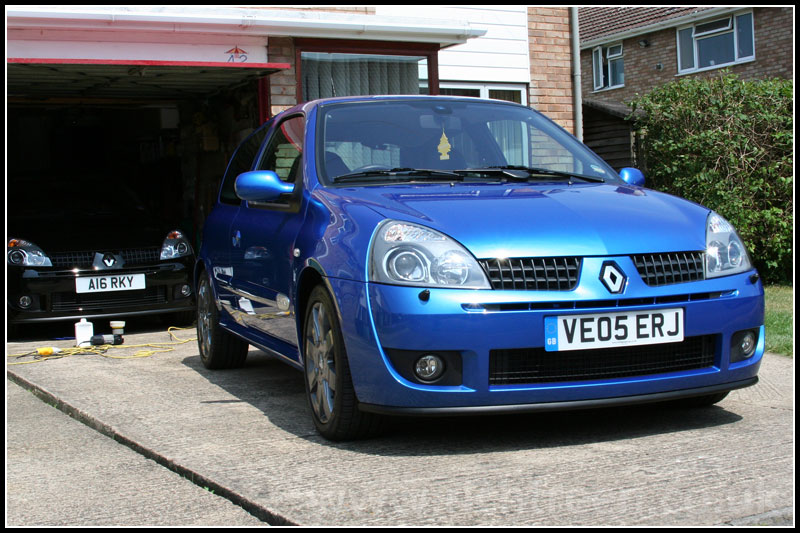

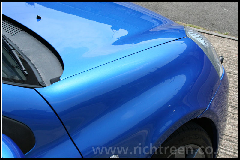

A few snaps of Dave (Davehughes) of here's 182. He popped up for a machine polish this morning, damn it was warm!
The car to Daves credit was in really nice shape.
Process
Poorboys Spray and wipe to remove light dust.
PC polish
Sonus Yellow SFX Cutting Pad - Poorboys SSR 2.5
Sonus White SFX Polishing Pad - Optimum Polish
Waxed by hand - P21s

cheers rich was a warm day, but looks like new, well worth it,
had a good drive home as well lol,

Thats is looking mint! seen Alan's car in the flesh last night, and he said its just been PC'd.. Really wanting one now, his was so so clean!

Lovely work and a lovely wet looking finish!
I have a bottle of Optimum polish sat here that i haven't used yet but i think i might have to crack her open after seeing that.:approve:
  106 GTi
Cheers Tim - I would have used Megs #80 normally, but as it was so damn sunny it was a big no no, where are the Optimum Polish is as sun freindly as the Poorboys SSR range.
