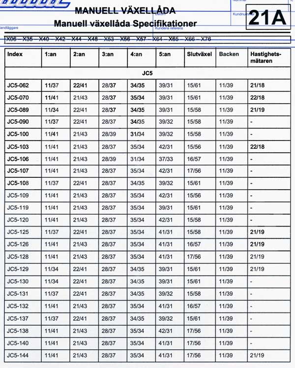

Evening all, recently purchased a clio 182 turbo roughly running 240bhp, been out a few times the last couple of weeks and it feels like it needs a 6th or longer ratio! Seen a couple of people mention a DCI gearbox. Can anybody shed any light on this or recommend a option? Cheers

The dci box is a JC5-128, you could also consider an 089.
You can take your chances with the LH circlip on either or @NorthloopCup can convert to a bolt up diff.
The 182 box is a 130

I've got a JC50-87 in the garage. I'm sure it's from a dTi but the ratios definitely felt similar to a standard 172

The 130.129 & 089 all have identical ratios, but the 089 has a higher final drive ratio, roughly 80mph at 3.55k rpm.
As previously said, the 128 could theoretically reach 180 mph, but not with 240bhp.
You don`t need short ( close ) ratios with a turbo.
