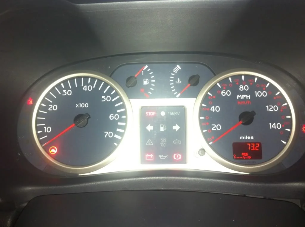

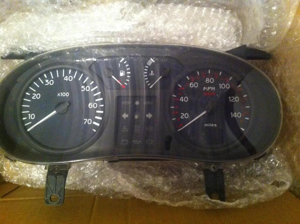

Just to tie this thread up. I took a punt based on very little info and 1 forum post in many. If you have these clocks (below) without an on board computer and would like one you just need to change your clocks to one from a car with on (silver surround). You'll also need a stalk with a trip computer button on the end (there are a few different versions for cars with/out auto wipers). The mileage will change dependant on the clocks you buy and you can pay to have it changed (I got ones with mileage as close as possible)
To confirm you cannot just fit a new stalk as the functionality is in the clocks. Clio is prewired for this info.
Cost me £30 in total and I expect to recoup that by being able to monitor how heavy my right foot is. Of course you cannot put clocks from a PH3 clio 2 (digital) in ones which originally didn't have digital dash. More info available on cliodci.net
