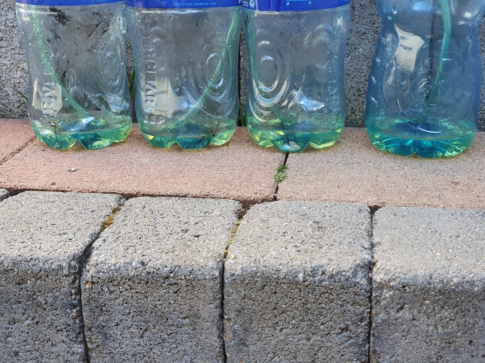

Do a leak off test, remove the return from all injectors and collect them into 4 cups, usually if one is faulty it will be apparent by the different amount of fuel in that cup

Well the results are in
This is after 5 minutes of running. I managed to get the lend of 1 injector which I tried into cylinder 2 anyway out of interest. Exactly the same. Still bad fuel knock from this cylinder. When disconnected on that cylinder the knock goes. It starts and runs fine! I've no idea what to try next. I don't want to fire the parts cannon at it. Fearing for compression issues or something on that cylinder.
Brigsy
  T.Turbo
They look alright to be fair. Has it always run knocky after new head or just started? I wonder if the comp is down on that cylinder.
  2004 RB182 Cup
I'm not sure since I bought it as a non runner. However the first time it started it ran perfect! I only turned it off because I noticed a slight oil leak in the return to the sump from turbo. Fixed that, turned it back on and its been lumpy since! With this injector fitted there is no diesel coming out the return at all. The knock has gone but it feels off a cylinder. So this other injector is maybe dud? Losing the will....

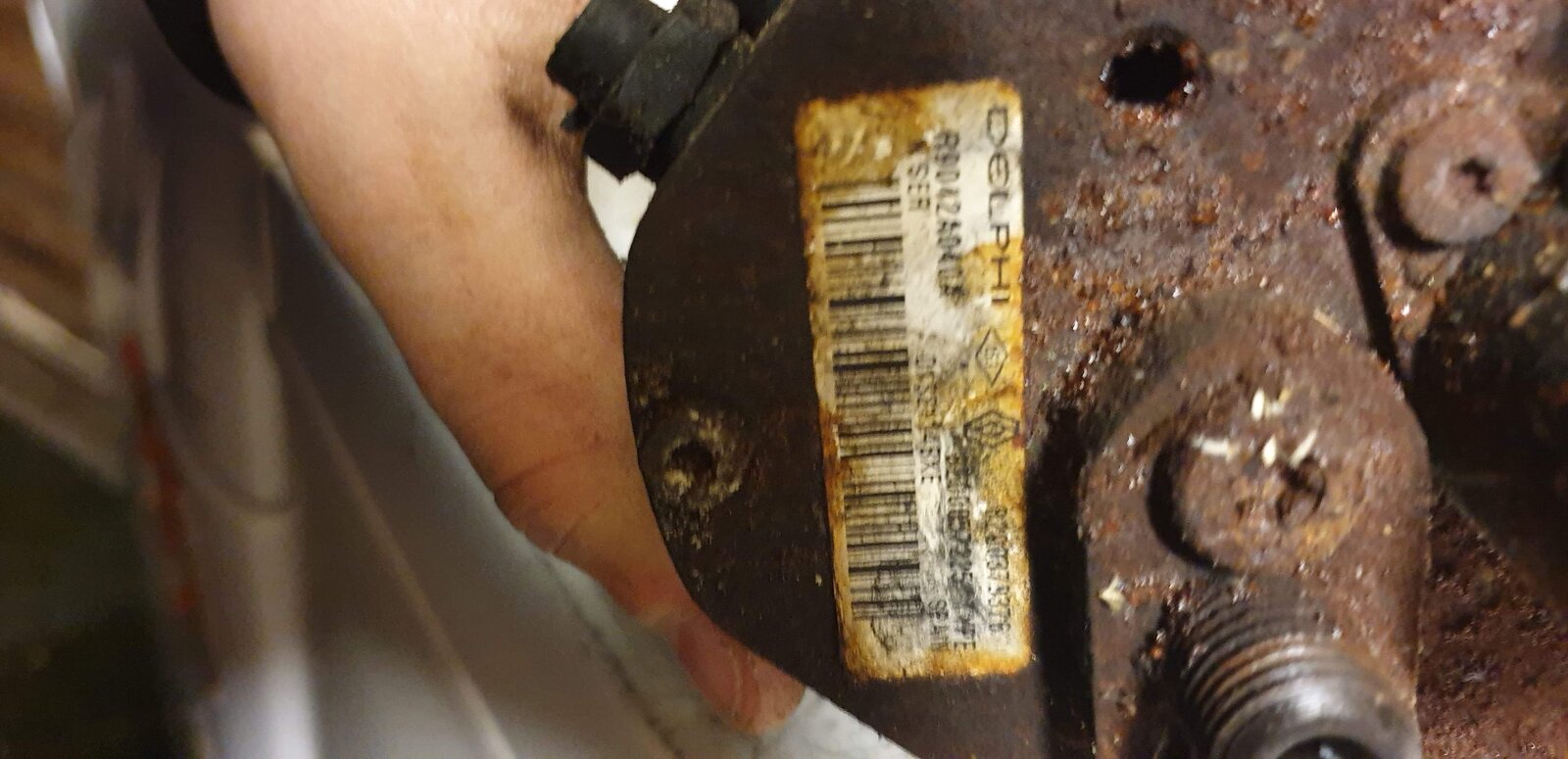

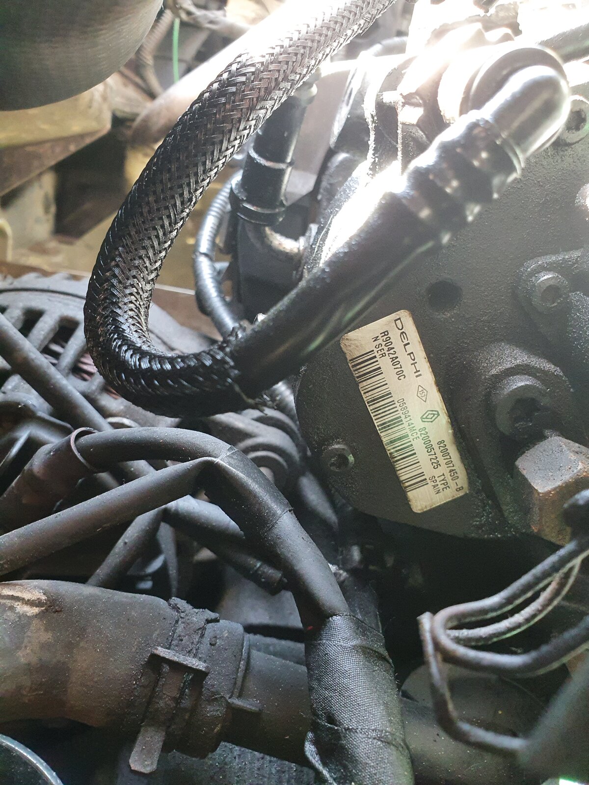

Also, send me a pic of the code on your pump as I have a spare one sat here from an old dCi 100 that has all the sensors too. It sounds as if an injector has karked it but it's always good to have a spare pump with good sensors haha
  2004 RB182 Cup
If you've got CLIP look at the fuel pressure logs from the high pressure pump mate.
Cheers! Will get a picture of the pump today. Awaiting the arrival of clip. Probably won't be here until next week or so anyway. I daily a 2011 megane 1.5 dci and all this bother with this kangoo is making me scared tokeep the megane!
