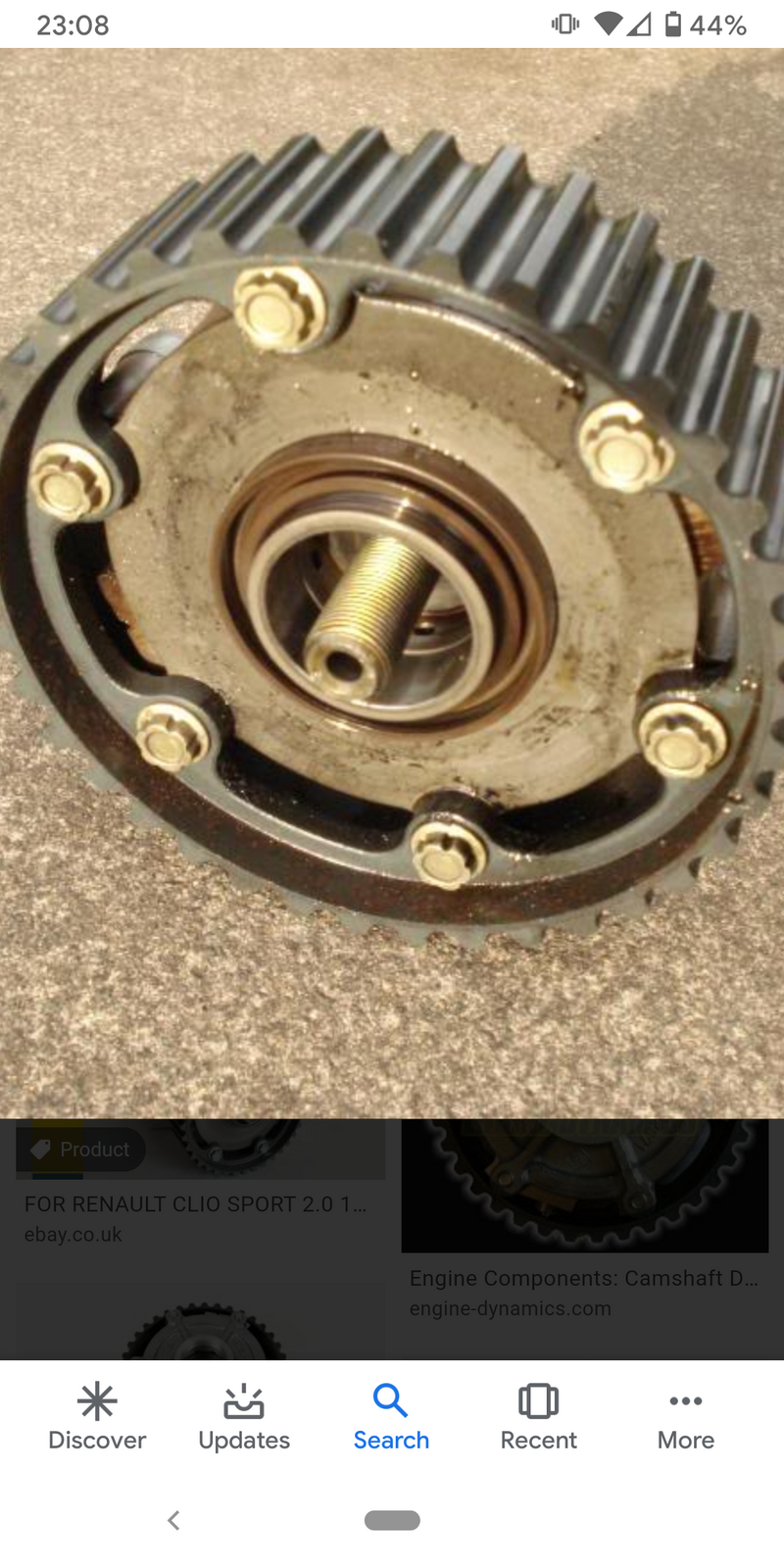

doing the timing tomorrows gents and cant remember if there is a spacer that goes behind the dephaser pulley as it looks like it has contact with the cam seal??
JamesBryan
No spacer, it does contact the seal. That's why they need replacing to do a proper job.
