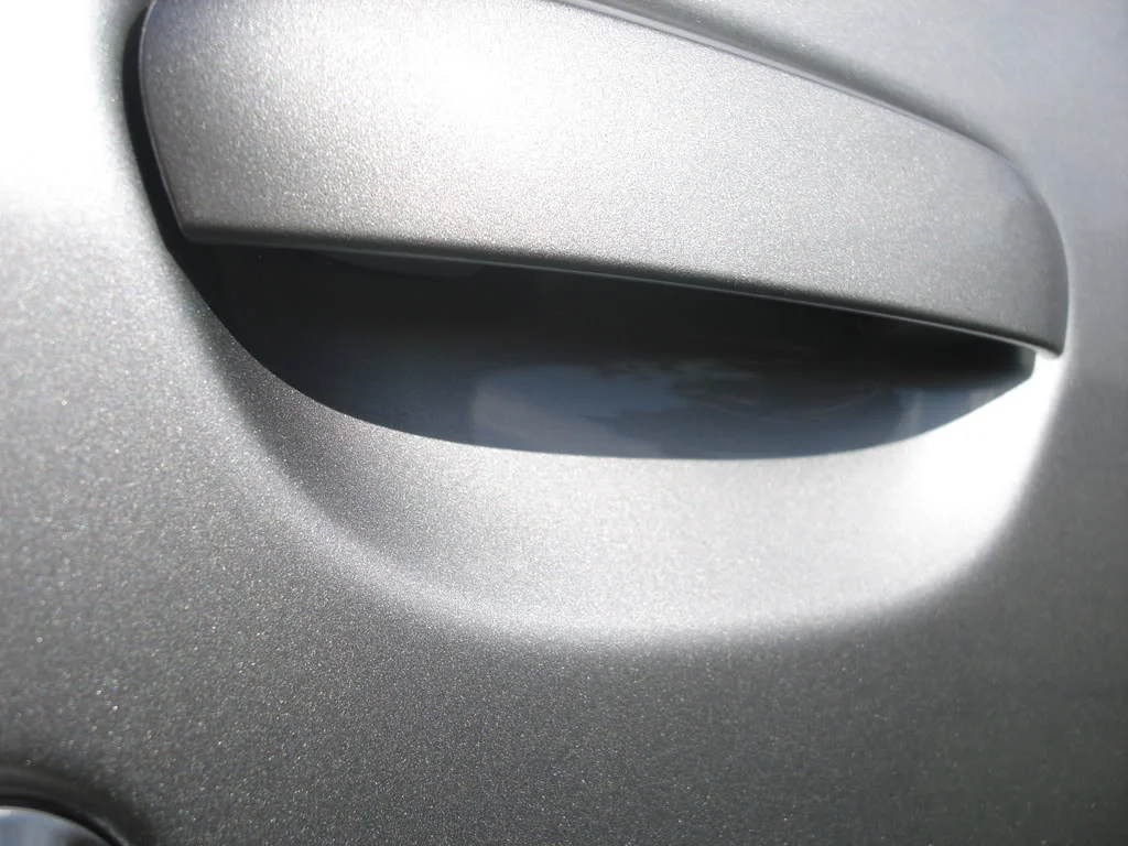

I use 476s also and i can vouch for it's performance and looks. You can get a tin for £15-17 and it'll last ages. The last time I did our Ka was early July and it's beading like it's been freshly waxed still. It lives outside and in the hot weather gets covered in dust, as soon as it rains 90% of the dirt has washed off without me even having to get a bucket out.
  Shed.

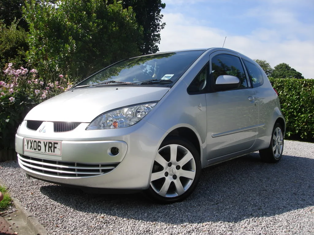

My dad's colt is still beading after about 1 month now. Nothing impressive but i doubt itll give up any time soon. here is 3 coats of EGP and 2 coats of 476s.
  Shed.
^ that was after about 2 days of being left outside as well.
But i did spend 26 hours on it. Interior and exterior. But i went to levels of detailing which i would never do on my own car as i had full use of the garage.
