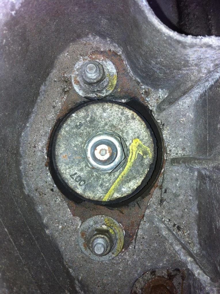

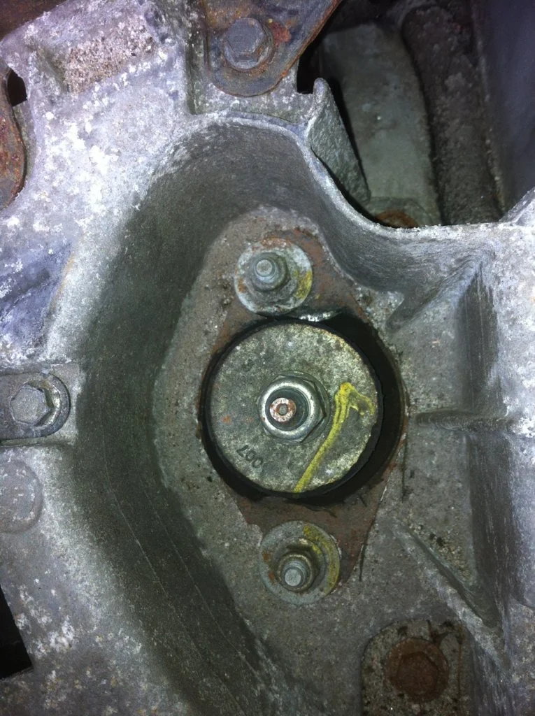

Gearbox mount, been offered a new one. The movement in the engine seems to be from this area an towards the back which I'm guessing equals the dogbone?
It look shot?

That mount looks fine tbh.. Can you get hold of the engine and swing it back an forward?
yeh alot more so than the meg. the engine splutters too when running, like internally. although its not the engine itself as i've had it looked over, powers there and it runs fine..
