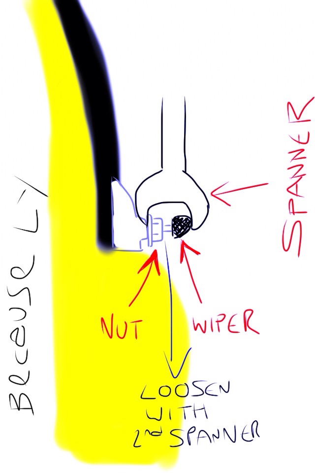

Put the nut back on and then do as knuckles says, use a 17mm spanner over the wiper and nut to act as a puller
Was it just me who wanted to put the thing back on eventually lol!?
Give me 5 minsThis is just me being retarded but I don't quite understand what your saying to do :s
Ye I've got both nuts loosened off but the actualy wiper where it goes onto the thread is ceased on :/
I hope that explains it lol
