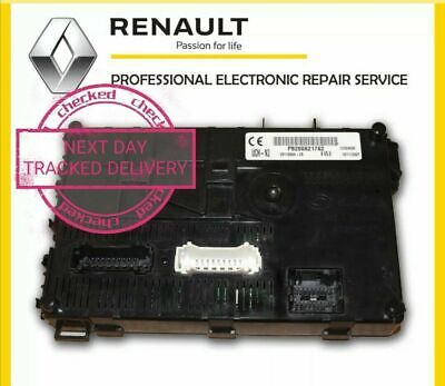

I'd be surprised if the washer fluid overfilling was the cause of your issues. BCM/UCH can be sent off to dieselpumprepair2 on eBay if that's found to be the fault, highly recommended on here:
