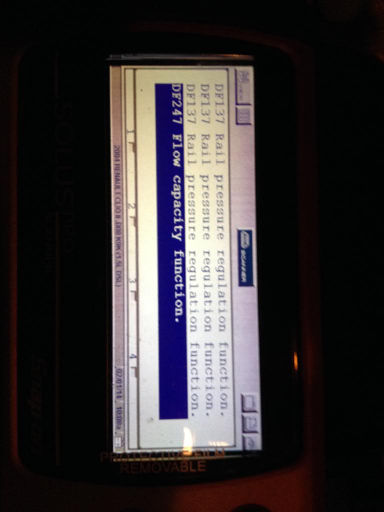

The codes i got off the snapon tool tonight where:
DF137 Rail Pressure Regulation Function
DF247 Flow Capacity function

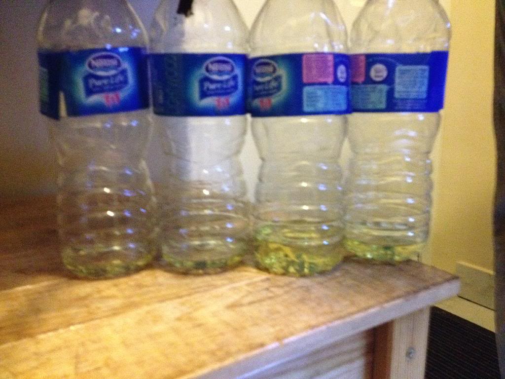

Also done a leak down test left it running on idle for about a minute. 3 definately looks no good and 4 does look too bad

Sounds to me like a pump issue or fuel rail sensor having a hissy fit.
You'll need a good diagnostics tool to read live data.
Once you do, go on live data , watch the fuel rail pressure on cranking.
Definatly not EGR
Ive had this twice on old fuel pumps/injectors.
One pump did what you said fault light wise and codes until it finally started cutting out.
The other was a sticky injector locking open on WOT dropping rail pressure for a few seconds
How did you messure the fuel leak back quantities ? Pulled all four returns off and ran pipes to bottles, also blocking off the inlet to the return pipe on the pump for the leak back from injectors.
lemonnobby
if you done that leak off test right i would say that injector is passed its best.
pump pressure should be around 300 bar when cranking

I literally removed the leak off pipe work, run a pipe from each injector into a separate bottle and then put my finger over the nipple on the pump to prevent air going back into the system
i take it that's correct?
You will need to blank off the leak off return on the pump and run the engine up to at least 2500rpm for approx 1 min to get a true reading.
