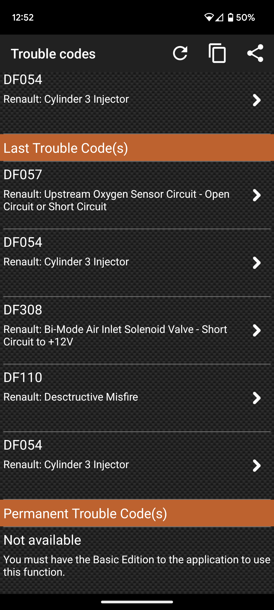

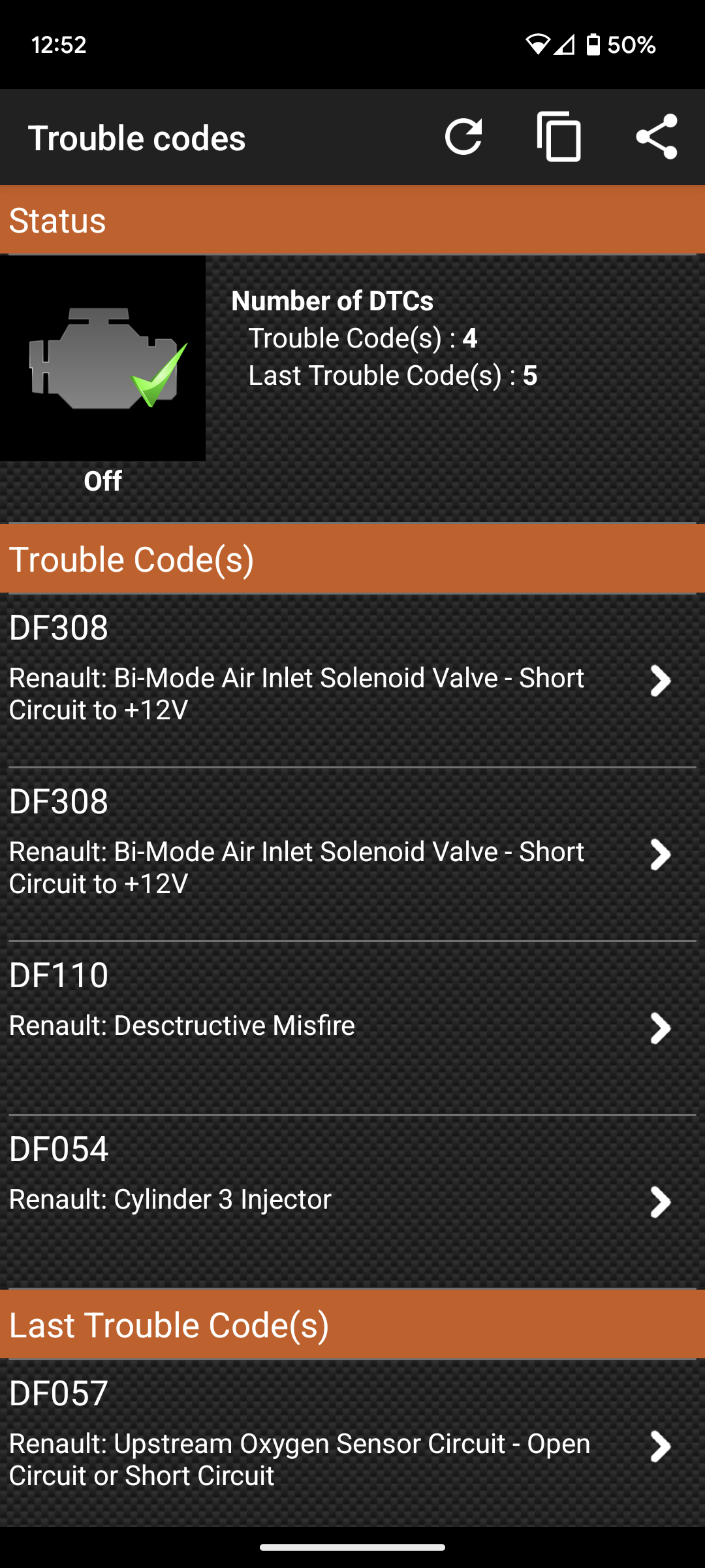

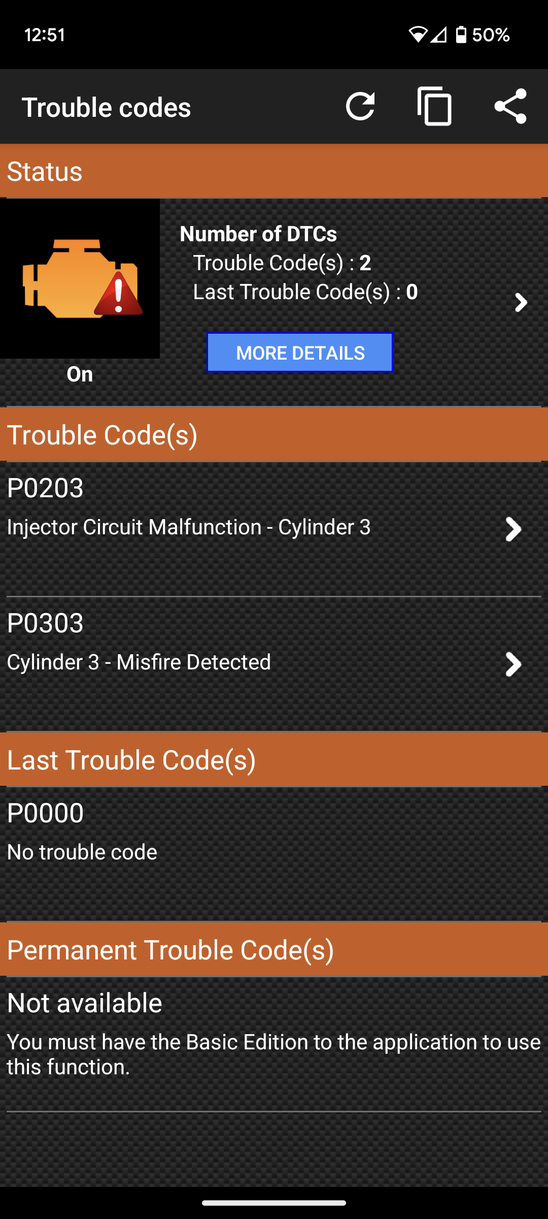

So Chloe's not well at all it seems.
Started today and she sounded super rough, was so bad I thought It was an exhaust problem at first.
Took to my local garage and it seems to be the engine misfiring.
Here's what my Bluetooth scanner picked up.
hopgop1
Should I just do the 1 injector? Or all 4?
And what exactly is the bi mode air solenoid valve?
Personally I'd do all 4, if one's gone the rest will be on their way. I don't think they're massively expensive either.
Hard to tell with the description from those cheap readers, but I'd assume acoustic valve, not your misfire anyway.

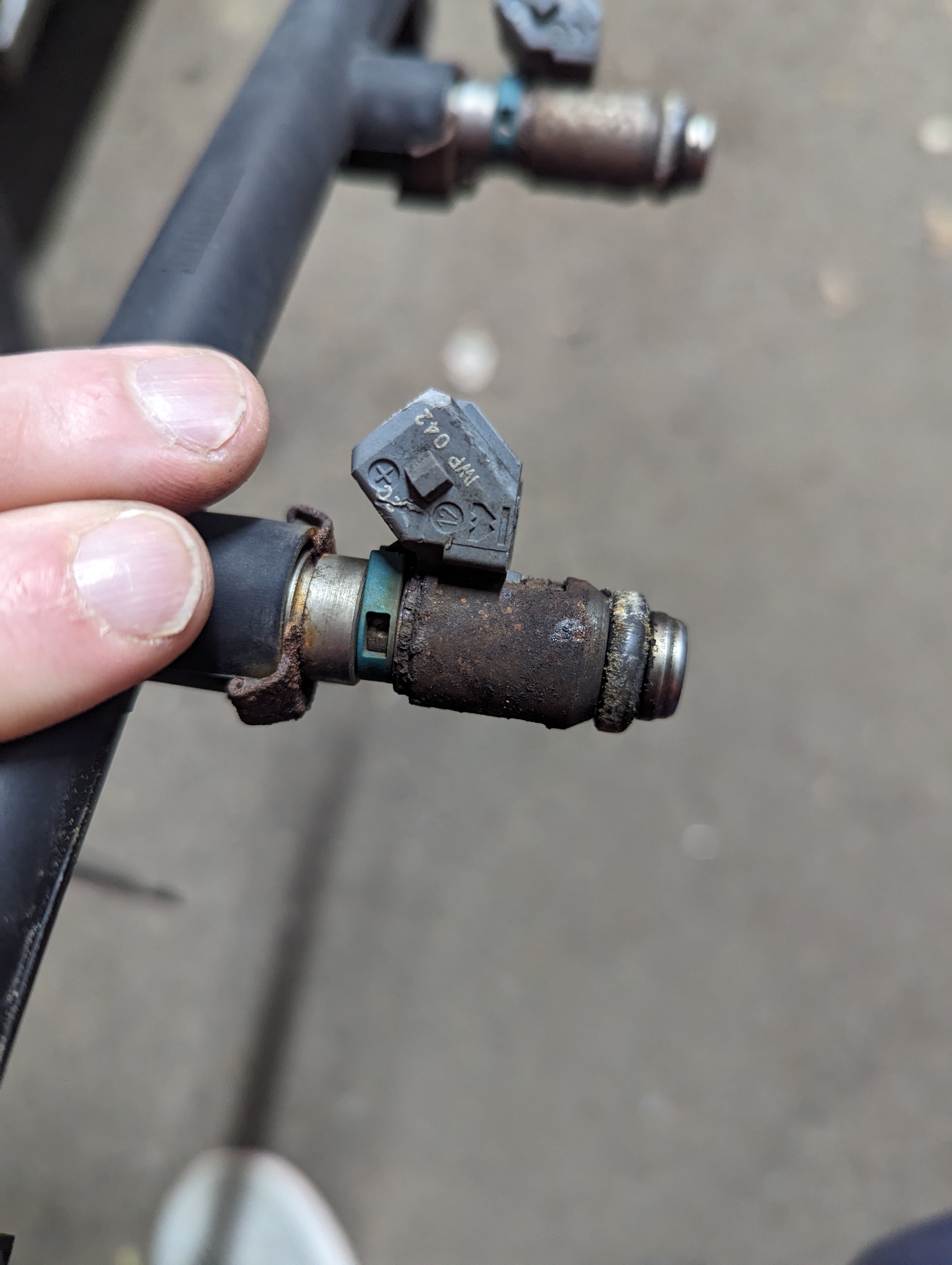

Got her running again boys.
Only did injector no. 3. Took less than an hour I think.
Sods law another one will die soon, but it is a pretty easy job so not that worried.
I'm pretty impressed that the cars ECU knew there was an injector issue months ago. Won't leave so long to diagnose next time.
