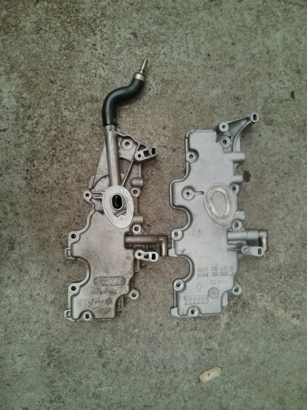

From what I can tell its only the decanter and rear mounting of the inlet manifold which is different.
On my engine I have noticed there is an egg shape hole on the bottom of the inlet but on the rocker cover its looks like a hole should be there but it's just a flat plate. So the rocker cover breather is blanked off basically.
well you can, but it's a bit pointless buying carbon canister vac pipes IMO, when a bung will do
