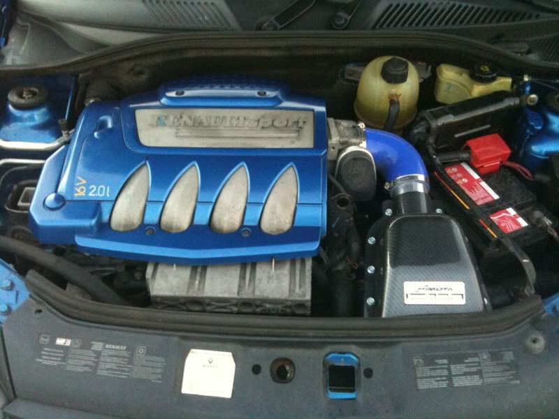

1. Simota airbox :
Pros :
- Sound
Cons :
- as it turned out later, it did not offer any gains in terms of BHP over the standard PH2/PH3 airbox ( I know that this is no a surprise for most of you ).
The car was pretty standard one when I bought it apart from the airbox, and it had really nice sound with this airbox fitted despite standard exhaust.

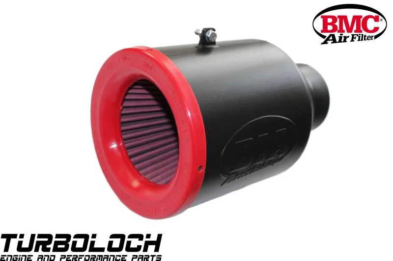

3. BMC DIA
Pros :
- Sound
- Performance in higher rpm range
Cons :
- not much tbh
My second favorite kit I had in 172. Car sounded awesome with this induction kit, performance wise it was on par with standard airbox, maybe even little better in higher rpms. With this kit fitted I was able to hold my own against 172 that has printout on 192 BHP. Not saying that it offered massive gains in terms of BHP, but it certainly wasn't dissapoitment. Sold it, beacuse as much as I liked the sound, it was a bit too much for everyday driving. Went back to standard airbox.

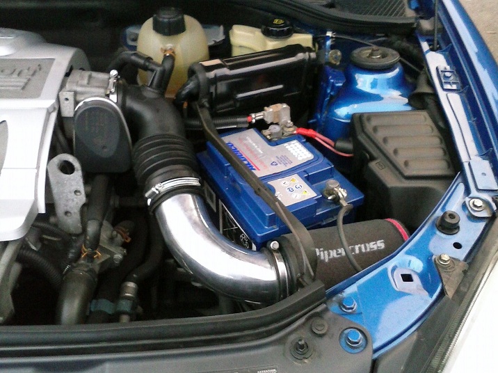

4. Fatty's induction kit
Pros :
- Sound
Cons :
- Sound (?)
The kit that is widely popular on here. Everyone know what it brings to table, so I will just say that I was quite underwhelmed with it. No real performance gains here, and sound was a bit to chavy and loud IMO. It felt ridiculous with all this roar and growl, when car wasn't even going so fast. I understand that it may be appealing, but it's not my cup of tea. I have switched back to standard airbox after few hundrets km's.

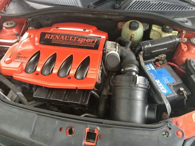

5. V6 airbox
Pros :
- performance
- sound
Cons :
- hard to get where I live
My current and most probable my favorite kit so far, even though I had it for two days ! It offers great sound, step up from the standard airbox but not as loud as Fatty's. Performance wise I must say I am quite shocked, as the common opinion on here is that this kit offers at best little gains, while in my car the difference is quite noticeable. After sorting out my back box I will heat to rolling road to see it it's not only in my mind. I am yet to install CAF to it and I guess it will bring the noise a bit down, but as for now it is quite cold here so it is not an issue.
