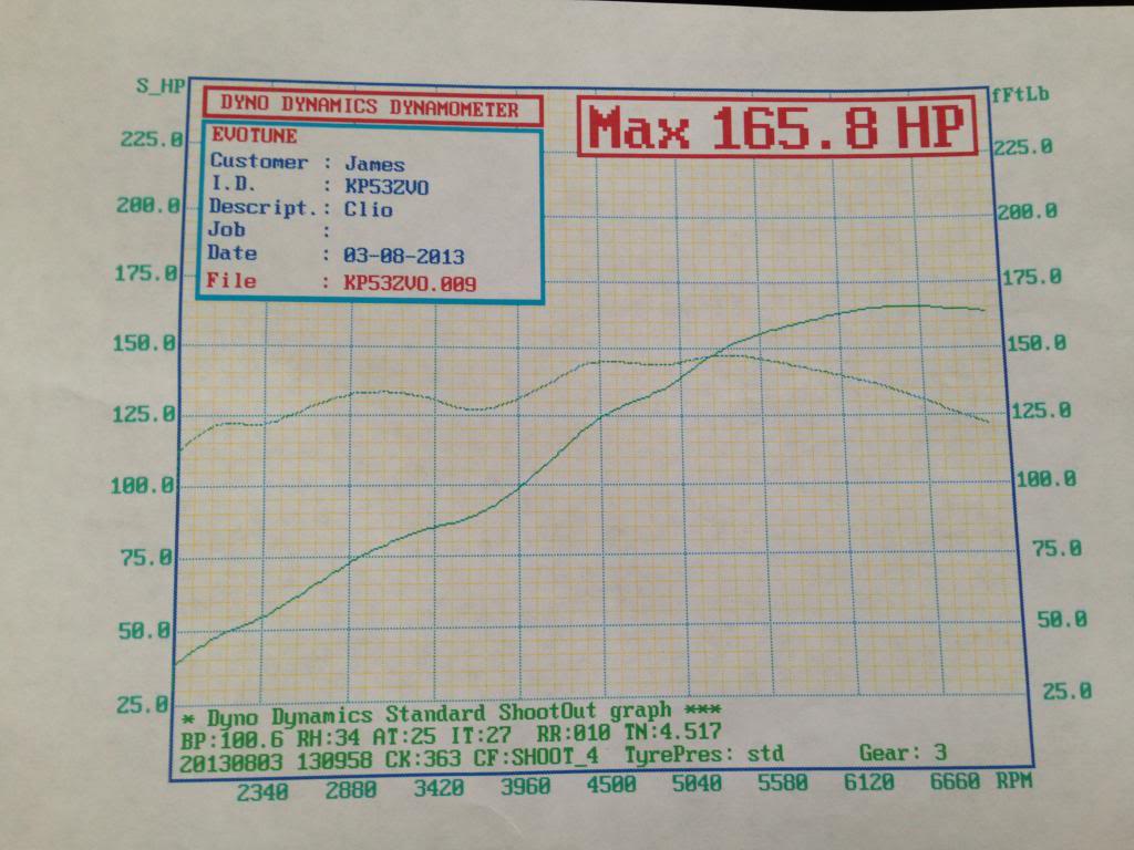

Is it normal for the 172 to have a dip in torque around 3500rpm?
Not hugely noticeable on the road, I will be getting a AFR done soon so I can see exactly what is going on with the fuel mixture.

Don't get me wrong the car goes extremely well on the road was just wondering if the 'dip' was normal.
Fred at BTM did the cambelt so I would have thought that's all correct, could the cause be anything else?

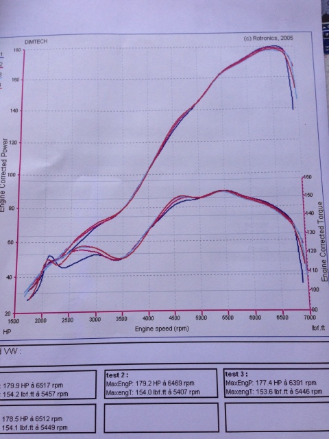

From memory my standard 172 had a dip around that rpm.
None of them have a flat torque curve, but that dip does look a little harsher than normal.
Although TBH it might just be due to the way they have scaled the axis looking again at the graph, it looks dramatic at a glance, but its only about 10lbft in fact.
So TBH, probably nothing to worry about.
  ph2 172
None of them have a flat torque curve, but that dip does look a little harsher than normal. Although TBH it might just be due to the way they have scaled the axis looking again at the graph, it looks dramatic at a glance, but its only about 10lbft in fact. So TBH, probably nothing to worry about.
Just had a check of mine, looks to drop 5-7 lbft before rising again, the scaling on the graph you posted is similar however the peak torque after is a lot more than mine.
Has the OP's engine got hotter cams by any chance?
For ref.

looks fine to me, really bad scale! The power/torque curve should be crossing at 5252rpm, yours are at about 2250rpm by the look of it
  Range Rover Sport
Like I say, it feels great on the road was just worried about the 'dip' but by the sound of it a lot do have a slight dip and if Chip/Fred is correct the scaling isn't great so looks worse than it is?
Can breath again now.
